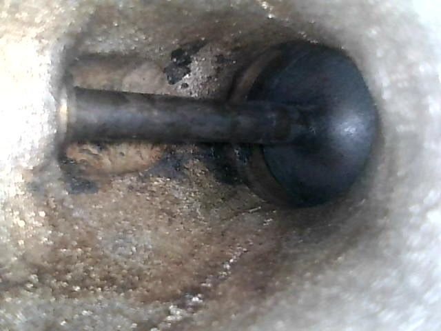

So I recently purchased my dads 2015 fit he used to commute to work in. As such it has 220k miles and needed a lot of maintenance. Had code suggesting injectors were bad and I figured since it’s a direct injection car the valves have to be pretty nasty. Carb cleaner, brake cleaner, and baby bottle brushes in a dtill did a pet good job on the valves.

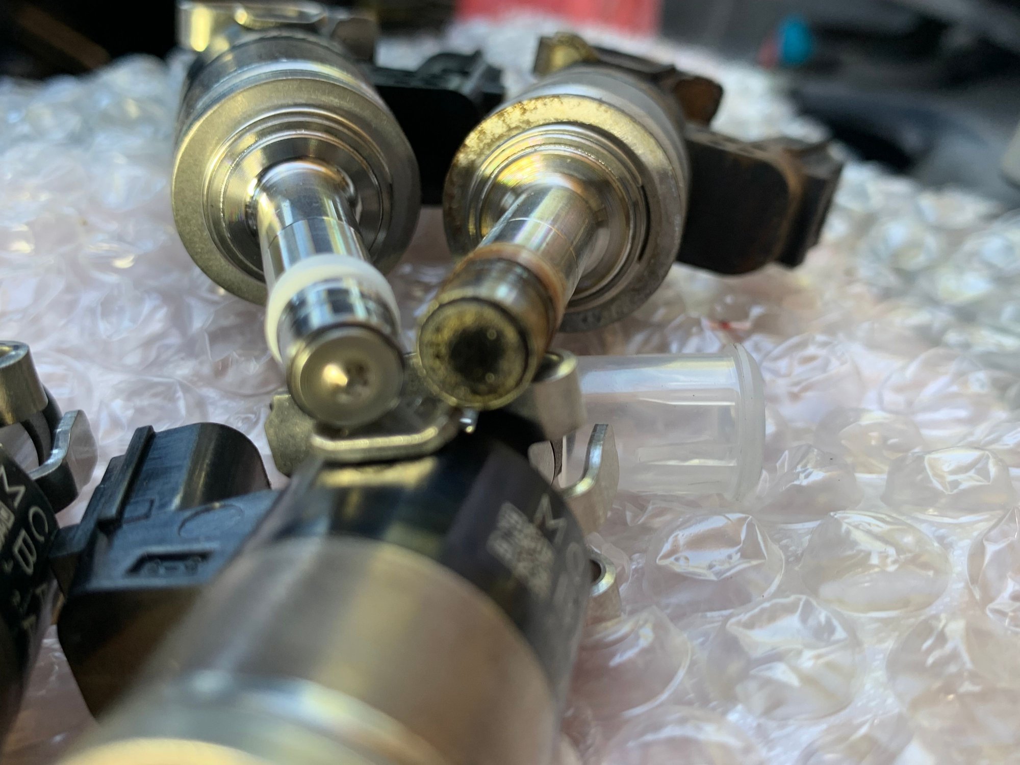

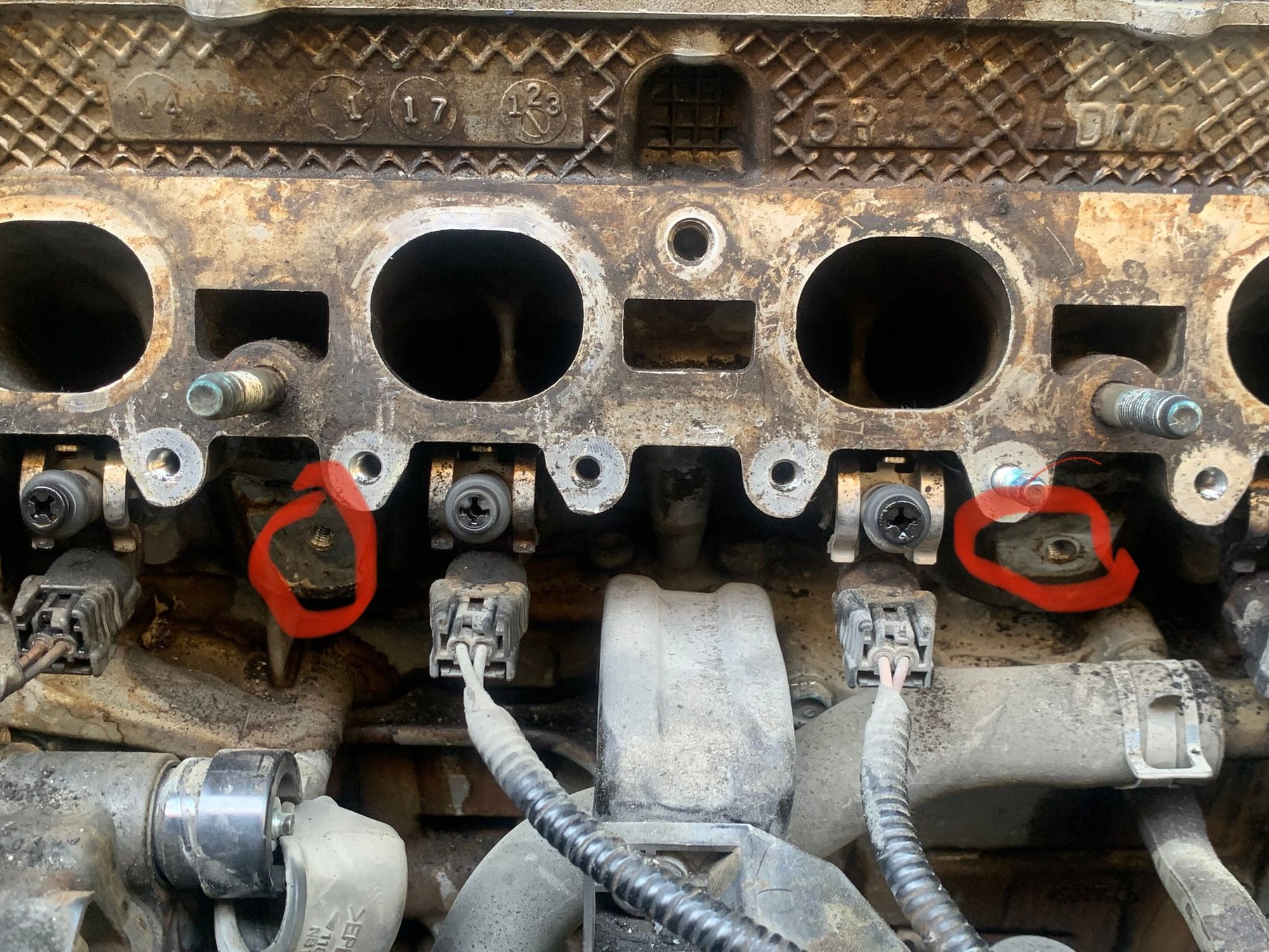

On the injectors I watched youtube videos on removing but turns out the fit has 2 additional bolts under the fuel rail holding them in place. I didn’t see anyone having to deal with that in the videos I saw. Once I got past that they were a breeze because they’re on the front side of the engine.
Before
After
Two extra bolts holding fuel rail on
220k injectors vs new

I bought the new injectors on eBay from a guy in Japan who sells a lot of jdm parts and they were just under $400 for the set so it was pretty big savings from what I found here. They look identical to mine and we’re still wrapped in factory packaging.
