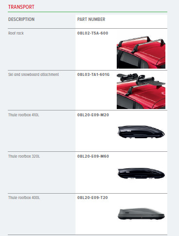

I checked the allowed masses and made a correction to my previous post: max roof load is 35 kg (77 lbs) and max towing with brakes is 1000 kg (2204 lbs)
The part number for the genuine Honda accessory roof rack is 08L02-T5A-600 and it is apparently manufactured by Thule. Honda also offered three different roof boxes for GK varying from 320 litres to 410 litres in volume.
