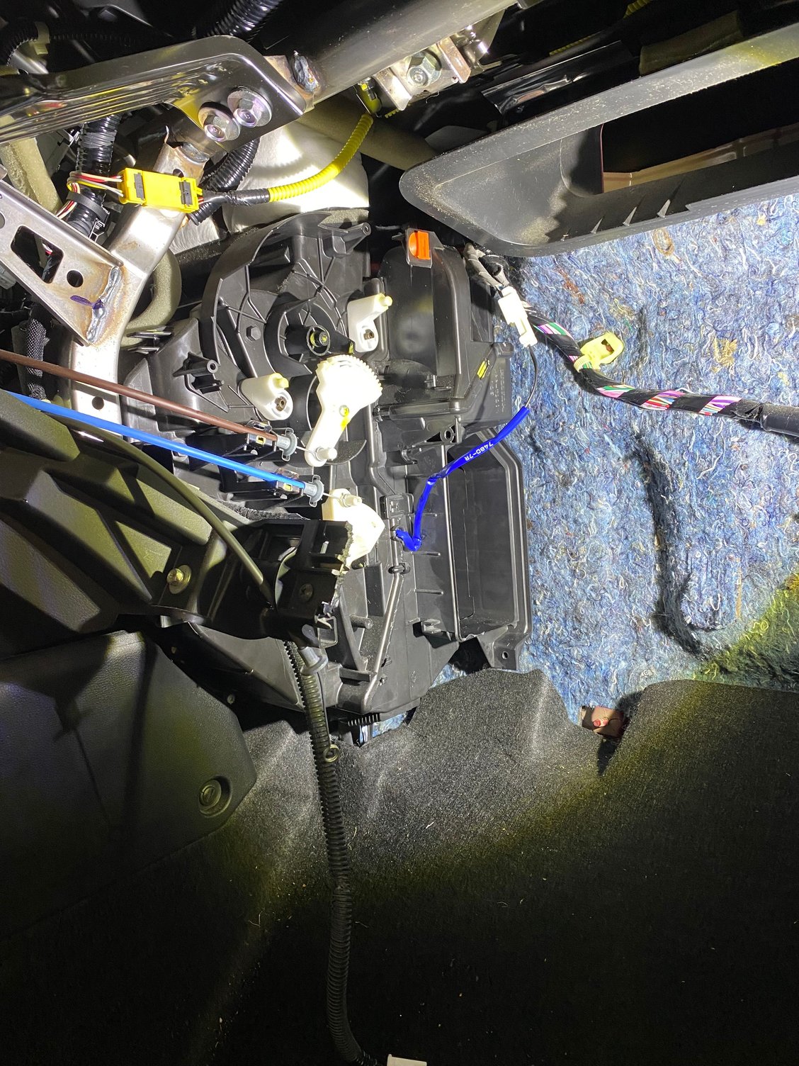

His AC is losing refrigerant somewhere. And searching with a UV light leads no clues around the compressor or condenser or connecting piping. So I’ve turned my attention to the inside. I’ve been able to remove the blower assembly, but I am completely stumped on how to mobilize the evaporator. This is what I see:

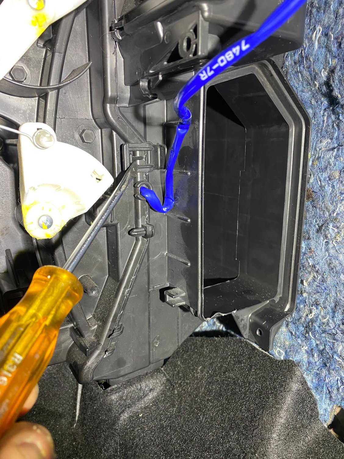

There are these clips, which seem to hold that back section where the evaporator is to the front section, but even releasing the clips both are very tightly together

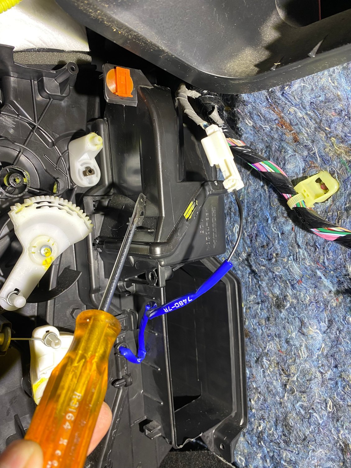

And this is a separate top section where I suspect the pipes go up and through the firewall in the engine compartment. Everything is held together very tightly.

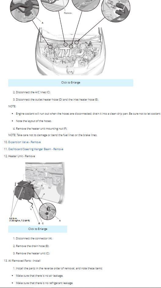

I finally located an accurate service manual that shows the procedure for this.
Check out post #52 on this thread: https://www.fitfreak.net/forums/3rd-...-manual-3.html
Here is the last few steps of evaporator removal...
The procedure entails removing the entire heater/AC box which means even removing the the entire dash... I'm packing it in and looking elsewhere for the problem.. not pulling the dash. If it is the evaporator he will have to bite the bullet and get it done by the dealer.
