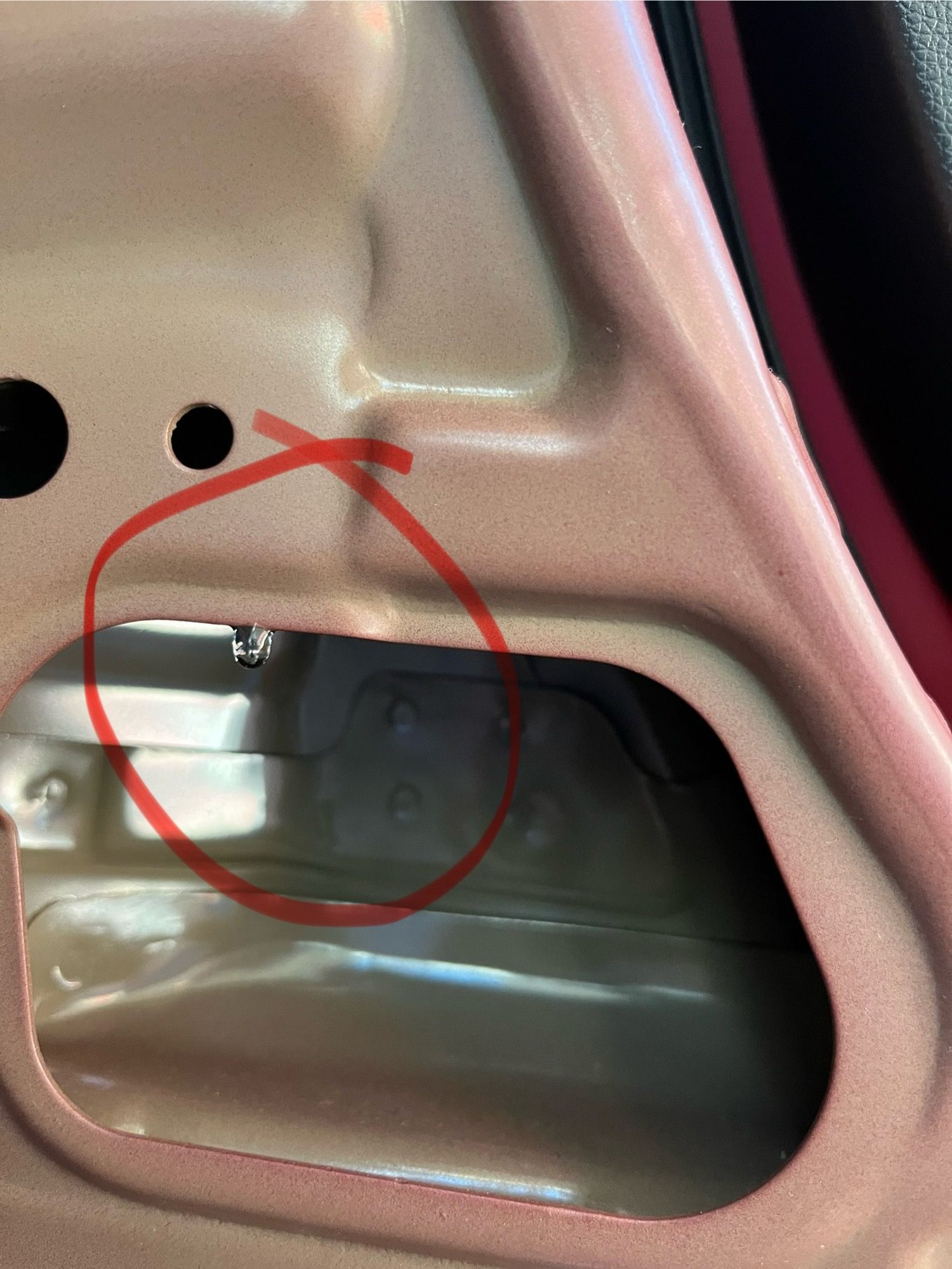

My 7 year old third generation FIT started accumulating water in the spare tire well. No moisture on the interior side panels or carpet. It remained a mystery until I removed the hatch threshold, spare tire cover and side panels. They are easy to remove, you simply peel their connectors up with fingers or plastic pry tool. Sit in the back and have someone rain hose water all over the back. Then watch for drops.
There are four main leak points on each side: the two 8mm hex bolts that connect the taillight assembly to the car and the two nylon guides that hold the taillight assembly in place.
I made rubber gaskets from a bike inner tube, punched holes and glued them to car with contact cement. These sealed the 8mm hex bolts.
I slipped thin Harbor Freight O-rings on the nylon clips to replace the dry and cracked Honda seals.

What sealing material is applied around the seams in the spare tire well? I need some.
As it turns out I have multiple leaks, some are solved. But I discovered another leak at the seam of the spot-welded taillight panel. The left side panel is generously sealed with “Honda sealing goop”, the right side has gaps in the goop and drips form there.

My FIT has not leaked a drop after several storms. I sealed more steel seams than Honda did and I covered some panel holes with HVAC tape. It would have been ideal to find the source of the water intrusion, but that was elusive. I felt good about sealing holes because Honda did that at the factory, I just added to their work. In fact, one of the Honda seals had a pinhole leak.

Im fairly certain that those holes in the last photo are meant for ventilation of the car, probably not too important since the vents on the sides will still push air around but it might actually make the car a little too well sealed. Unfortunately all the fits suffered from trunk leaks, might had many strange little ones that took a little while to solve, but that was on my GE. The gk's seem to have a little more problems with quality control than the other generations, had a few more recalls than the other gen's a s well. I would be concerend about it still leaking behind those places you patched up and water staying there, the moisture/ water will most likely not make it to the interior of the car but it will gather and sit there, maybe causing rust issue in the future.
