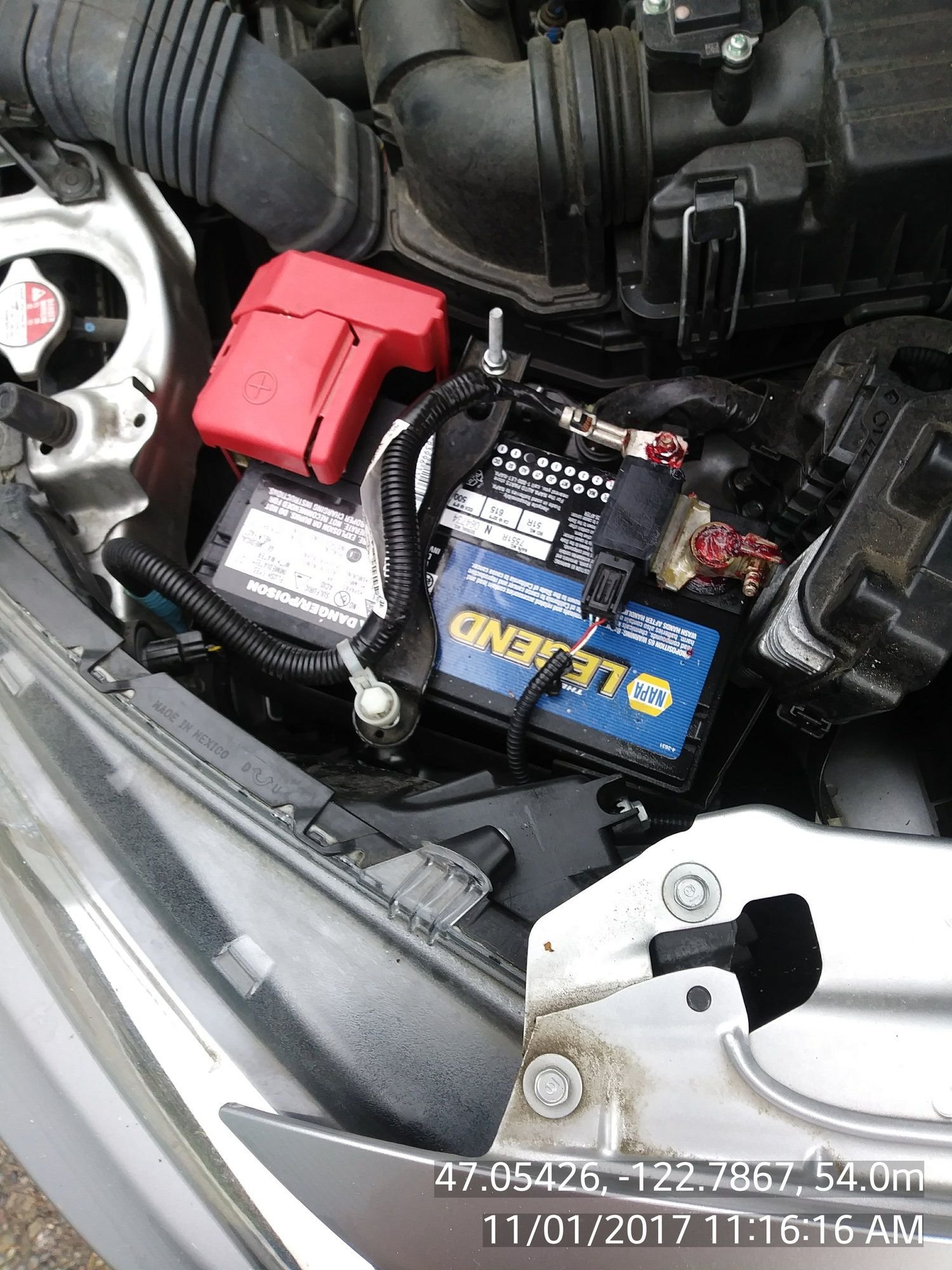

Yes, that black box is the ELD sensor. And you may be right about the injectors causing those lights, (from what I've read).
I wanted to ditch my ELD a few years ago for a new terminal and cable. I tried finding info but, didn't come up with much. I guess the ecu monitors the sensor readings then lowers alternator output by bringing it down from 14+ volts to 12 something volts to conserve when under a minimal load. Some have stated their volts come down often. Personally, I monitored mine passively for over 3 years and had only observed it come down a few times, then in less than a minute, it went back to over 14 without me doing anything.

Original Alternator.
Today, she parked it at 8am, and just now (6pm) tested the battery Voltage at 12.7V before starting and 14.4 right after starting. I'm tending towards the poor ground as the starting issue. She'll keep an eye on the voltage to be safe (and I ordered a replacement ELD to be safe, but won't install it unless it starts giving problems).

I had a weak ground on my battery with a different car OBD1, years ago. It didn't cause starting problems or anything, but it did cause other problems/codes, like injectors and sensors and idled a bit rough. I swapped out the terminal and cable and everything went away.
