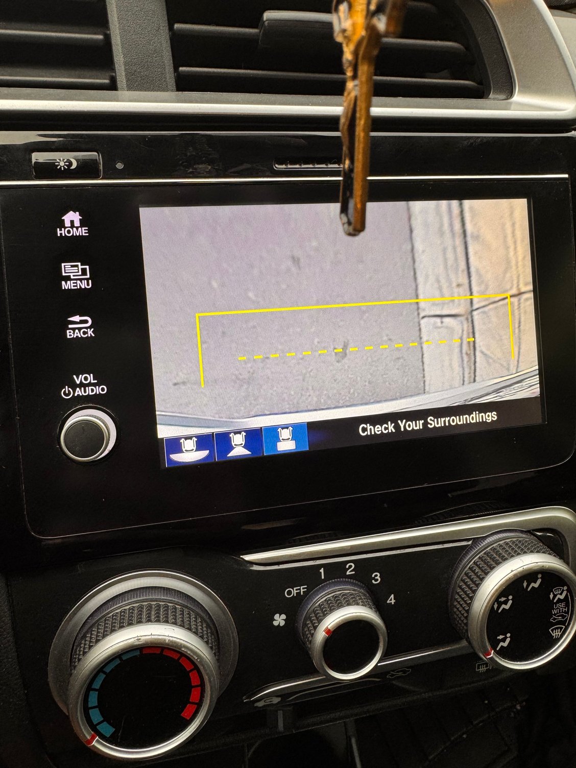

I was able to get a 2020 Honda Fit radio installed in my 2015 Fit.
A Reddit user made a post where he did the same thing, adding a 2019 radio in his 2018 HR-V. He posted the parts needed and wiring diagram as well (Reddit link)
You will have to contact Honda support and they will have to create a case file with tech support. They then will have to contact Denso ten (who makes the radio) and get a code from them. It took me two days (I contacted them Monday, they called me Tuesday afternoon and called back with the code like 5 minutes later) but it might be longer.
Harness made
Backup camera works (lane watch doesn’t)
Trip history works as well

I had seen a Reddit thread where a guy did the same thing for a 2018 HR-V so I figured that all of the connections were the same.
i still haven’t gotten lanewatch working
