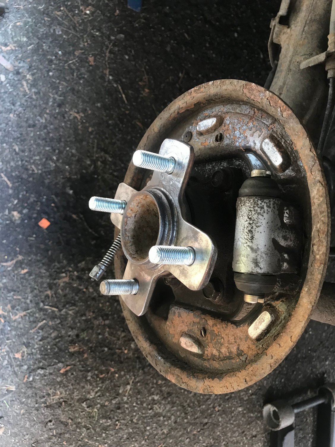

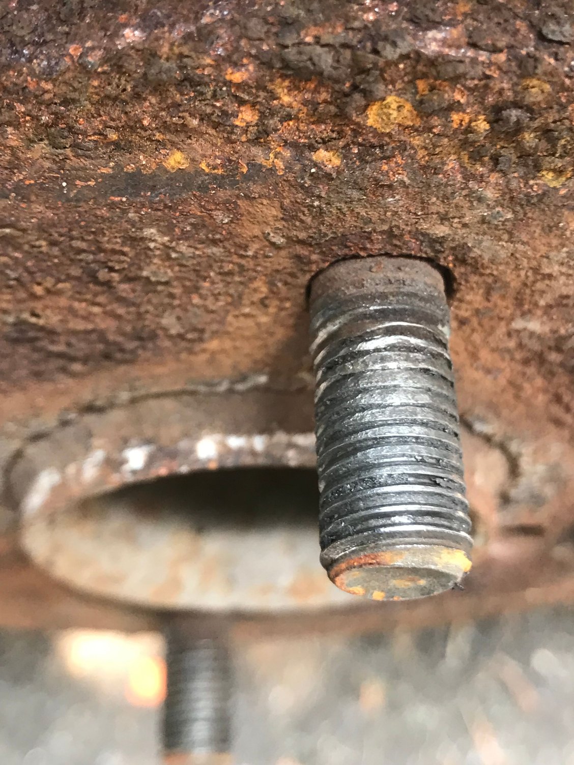

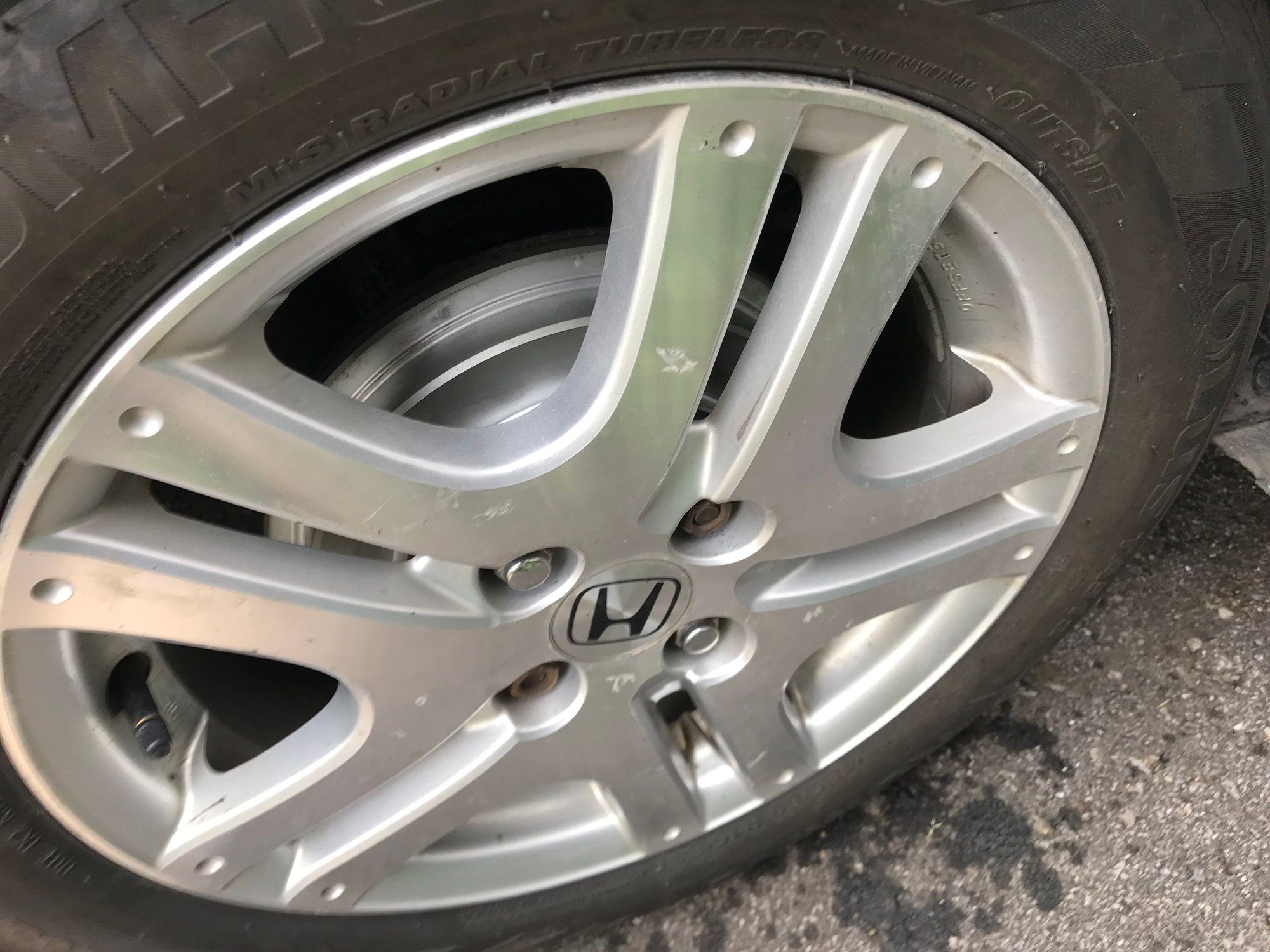

So I did my rear drums today. I also changed out three chowdered wheel studs on the driver side. Last time I tried torquing my left rear wheel, one of the nuts was still turning before my torque could click 😬. I managed to use another nut to grab on the threads. Threw the bad nut in the trash. Anyway, those studs are gone and it's a super easy job. I can’t confirm if it’s possible to remove a stud without removing the drum hardware. I was replacing the shoes so I didn’t bother to find out.
Wheel stud that would hold torque.
Wheel stud that would hold torque. Also you can see the super coroded drum.
I’ve never seen anything like this before. The threads a FUBAR.

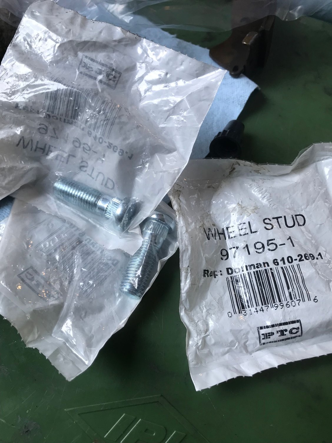

Parts I used.
Parts I used.

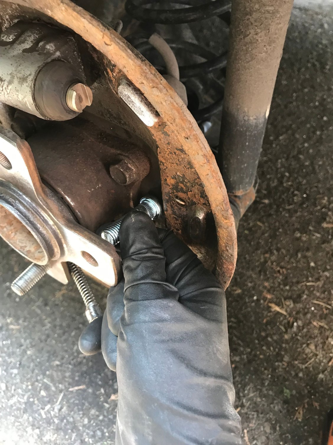

Loads of clearance to install the stud from behind. 2 good whacks from a regular hammer and out came the bad studs. No heat, no penetrating oil, nothing. I couldn’t get the “splines” to align with the old ones and it took nearly the highest setting on my impact driver to pull these through with lug nut. I wouldn’t want to attempt this with a wrench.
3/4 new studs. Yeah! Managed to push out the stupid cylinder piston while installing the new shoes. Told myself I would never do that again then did it again on the other side. I had recently bled the brakes so I easily cracked open the bleeders and bled both sides and got rid of the air.
3/4 new studs. Yeah! Managed to push out the stupid cylinder piston while installing the new shoes and out it came and landed on the ground. Told myself I would never do that again then did it again on the other side. I had recently bled the brakes so I easily cracked open the bleeders and bled both sides and got rid of the air. I truly hate installing drum brake hardware and springs.

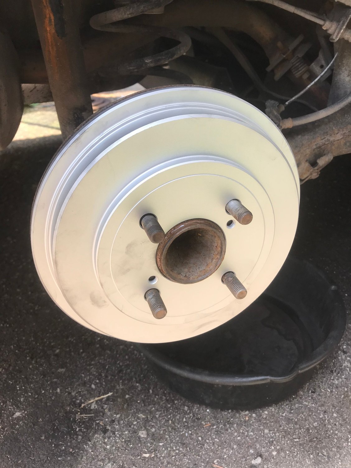

Powerstop Geomet coated drums. Probably due to the coating, when I was adjusting the shoes, no hand brake resulted in slight drag and one click meant impossible to turn by hand. It was possible to turn the wheel with difficultly at 1 click with the wheel on. Easiest adjustment I’ve ever done. The coating inside will likely wear out a bit in the next 100 km of driving.
That’s how the drums look with my GD sport rims. I like GD rims on the GK. It has an OEM look even though I know it’s not the true sport wheels. For those that noticed, I have 2 through style lug nuts which I hate so I have to go to the junk yard and pull off some proper closed Honda lug nuts. When I sent my totaled GD away to car heaven, kept two of every four lug nuts because f* my insurance company and the estimate they did on the repairs. Also kept my sport rims as you can see.

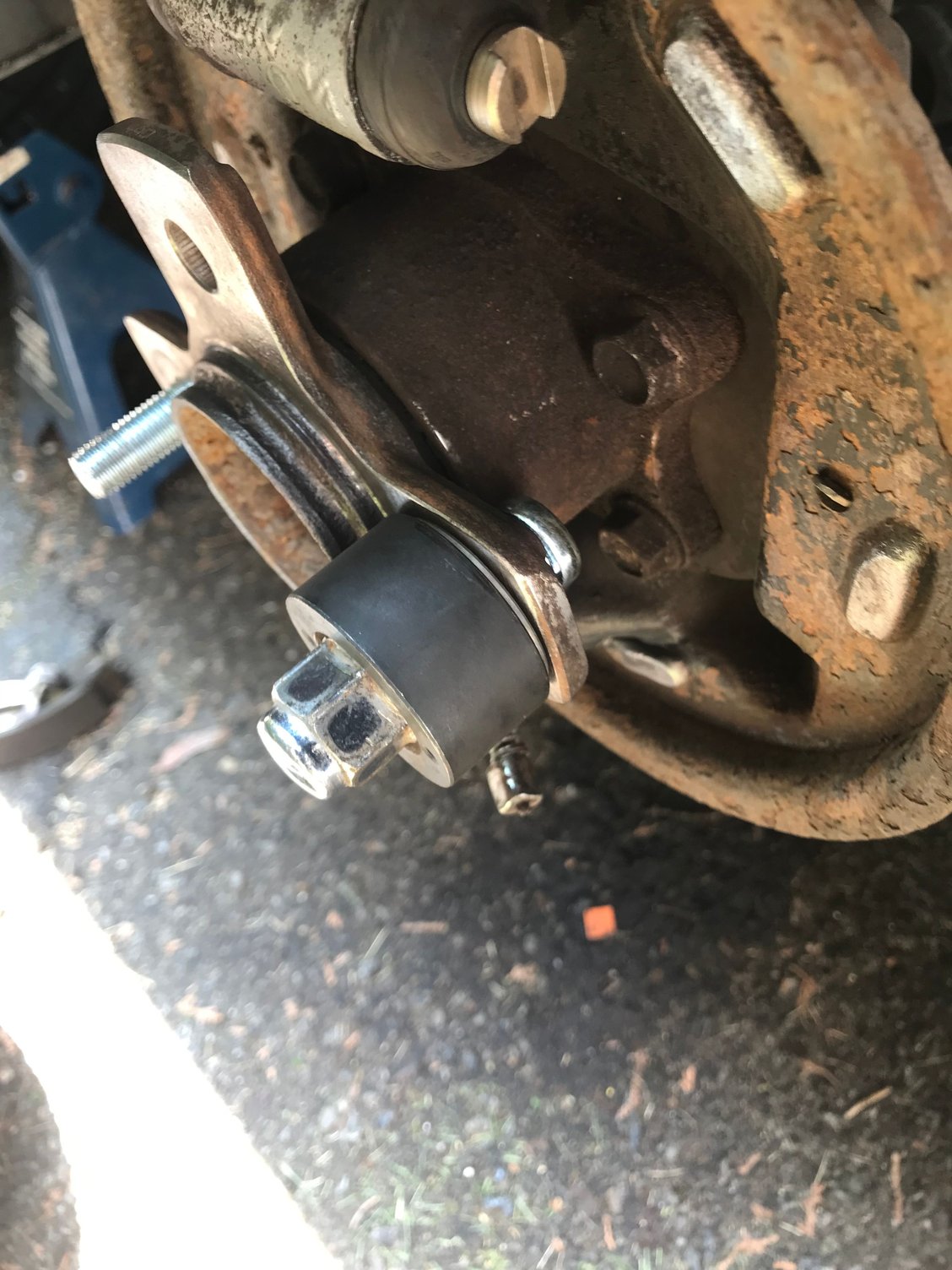

This is a wheel lug installing tool. Got it for less than 10 bucks and it worked like a charm. I highly recommend this tool to anyone attempting to install new wheel lugs. Like I said, I had to go semi hard on my impact to pull these in. Also, not possible to apply the handbrake so the hub is free spinning. You could use a breaker bar through some studs to hold the hub but in that case you can remove three studs like I did.
This is a wheel lug installing tool. Got it for less than 10 bucks and it worked like a charm. I highly recommend this tool to anyone attempting to install new wheel studs. Like I said, I had to go semi hard on my impact to pull these in. Also, not possible to apply the handbrake so the hub is free spinning. You could use a breaker bar through some studs to hold the hub but in that case you can’t remove three studs like I did or else you won’t be able to hold the hub.
now my handbrake can only go about 4 clicks before locking. I couldn’t bother to loosen the cable and like I stated previously, the coating inside the drums will likely wear off and increase the tolerance slightly.

Originally Posted by Mister Coffee
How about a part number or some info on that wheel lug installing tool? Thanks.
certainly! Glad you liked the post and shout out to 2015LXFit that helped me convince
myself I could do this.
[img alt="Price is in $ CDN. I may have said it was less than 10$, so ok, it was 13$. I much prefer this to using a bunch of washers and grease to create a spacer. A few packs of washers would probably cost nearly the price of this tool. It has a conical feature that centers the lug nut which ain’t bad at all.
"]https://cimg6.ibsrv.net/gimg/www.fitfreak.net-vbulletin/1242x1836/481af8ff_e439_4a1e_9b95_f20eb6a43e97_838795eb675aa cc7835fd1994b7b26bef4d609f1.jpeg[/img]
it is obviously a junk Chinese brand but it seems that P/N 22800 will find other similar models. Maybe you can find one from a reputable brand like Lisle.
my concern was that the lug studs are actually pretty short on the Fit but this had plenty of threads protruding when loosely installing the stud/nut prior to ugga dugga’ing it in with my impact.I’ll state again that it would probably have been no fun to do this with wrenches and trying to hold the hub while press fitting the stud. Impact wrench highly recommended.
description also says “stud removal” except I can’t imagine how you would use that to remove a stud.
