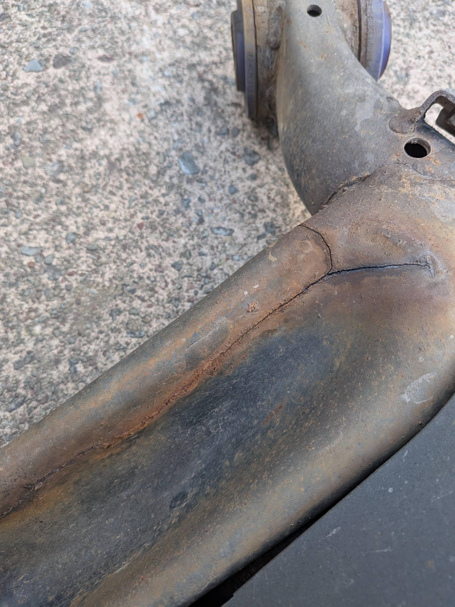

Turns out there was an 8 inch horizontal crack in the rear axle beam. Problem solved, finally.
That's not good, but it's good you found it. Expensive?

Wow, I have the same clunk (2015) and I sure hope it's not the axle beam.
What did they do to fix it, did they weld it?

I just finished installing an axle from the junkyard to fix it, it's not recommended to weld it because the beam will still flex and the weld probably wouldn't hold.
It should be noted that I live in the Northeast where our roads are crap, and I have the habit of driving like it's a rally car + the very high mileage and almost daily use for the past decade, this problem probably isn't likely for your average user.
Maybe an undercarriage wash could have prevented your rear axle beam from rusting through.

It is clearly a stress crack from fatigue load. Of course surface imperfections give a starting point to a crack, but axle beam can not be kept polished when the car is in use. I wish you many trouble-free miles with the new axle.
