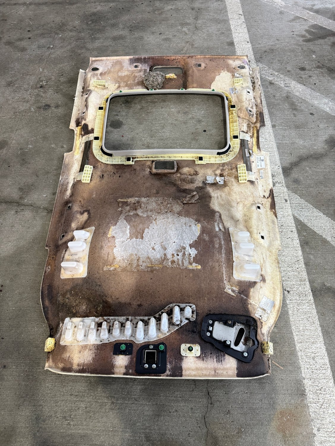

The previous owner must have left it for a while, because a family of squirrels nested there in the interim. While mechanically and electronically sound (thank god), we took it into a detailer for the smell. They told me that the headliner- along with possibly the carpeting due to the pillars- are pretty much ruined with half-chewed hickory nuts, an ocean of droppings, and enough piss stains to make someone gag. The nuts didn't surprise me; they've been throughout the car (inside the hood liner, trunk liner, behind the rear wheel guard, hell even in the interior engine bay liner!). But the droppings were an unpleasant surprise.
I've only had the car for about a month, but the dealership refuses to take responsibility. While we lawyer up, I want to take care of this myself, so a few questions:
1. Can I replace the headliner myself, and what part number/place can I get it from?

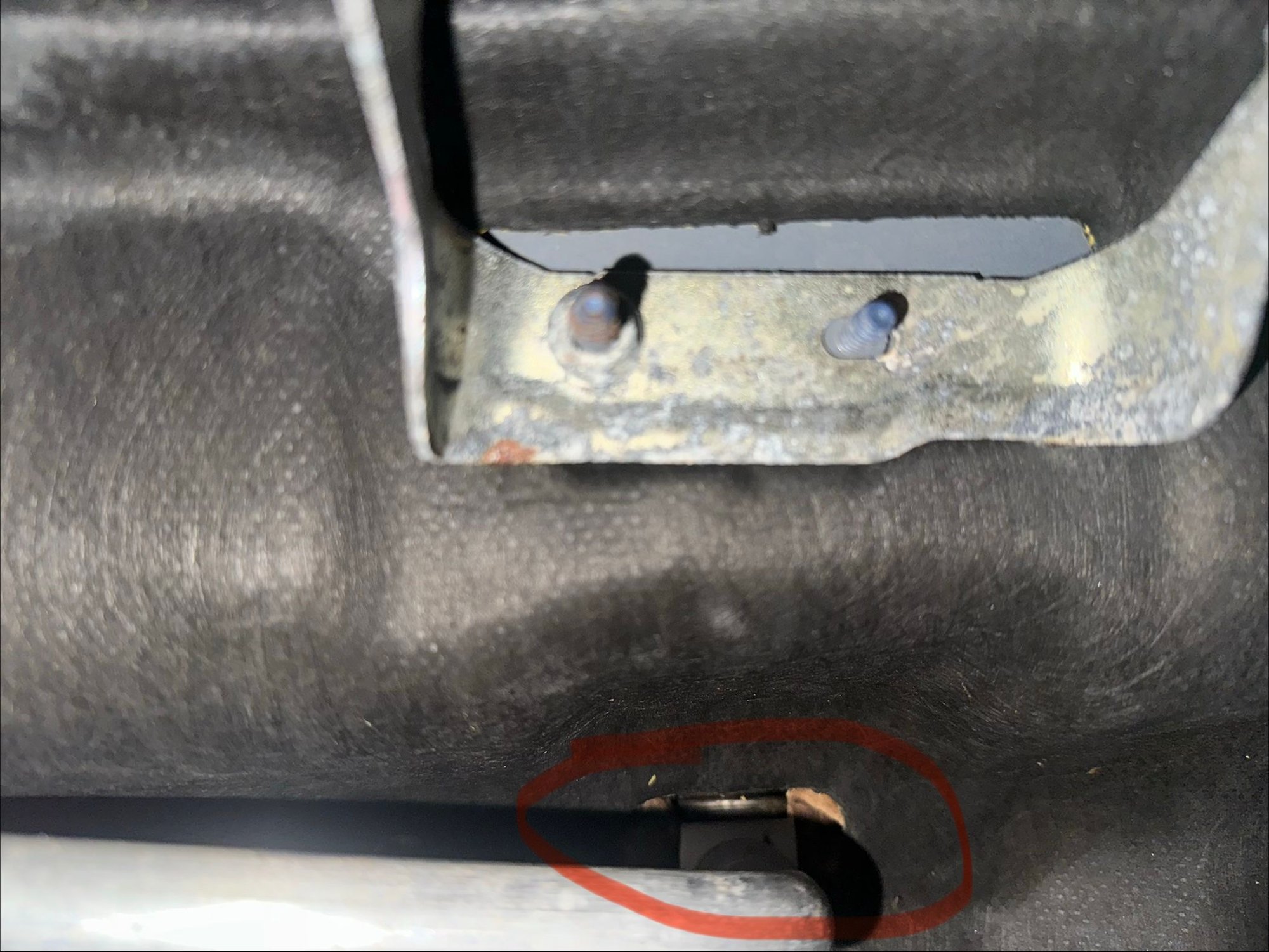

Thanks for your help! A few photos of the headliner, the carpet-removed driver's side cargo area, and the engine bay liner (with some nuts poking out) are included. NSFW. Thank you!
Headliner looks gross

Stupid nuts trapped in the engine bay liner

Wow! Looks like you need a used donee car with a good interior. Probably $1.5k-2k.

The detailer has miraculously cleaned about 95% of the headliner and carpeting. They were also able to get all the nuts out from the back seat cushions (which I had no idea were even there). The smell's not COMPLETELY gone, but it's night and day difference.
