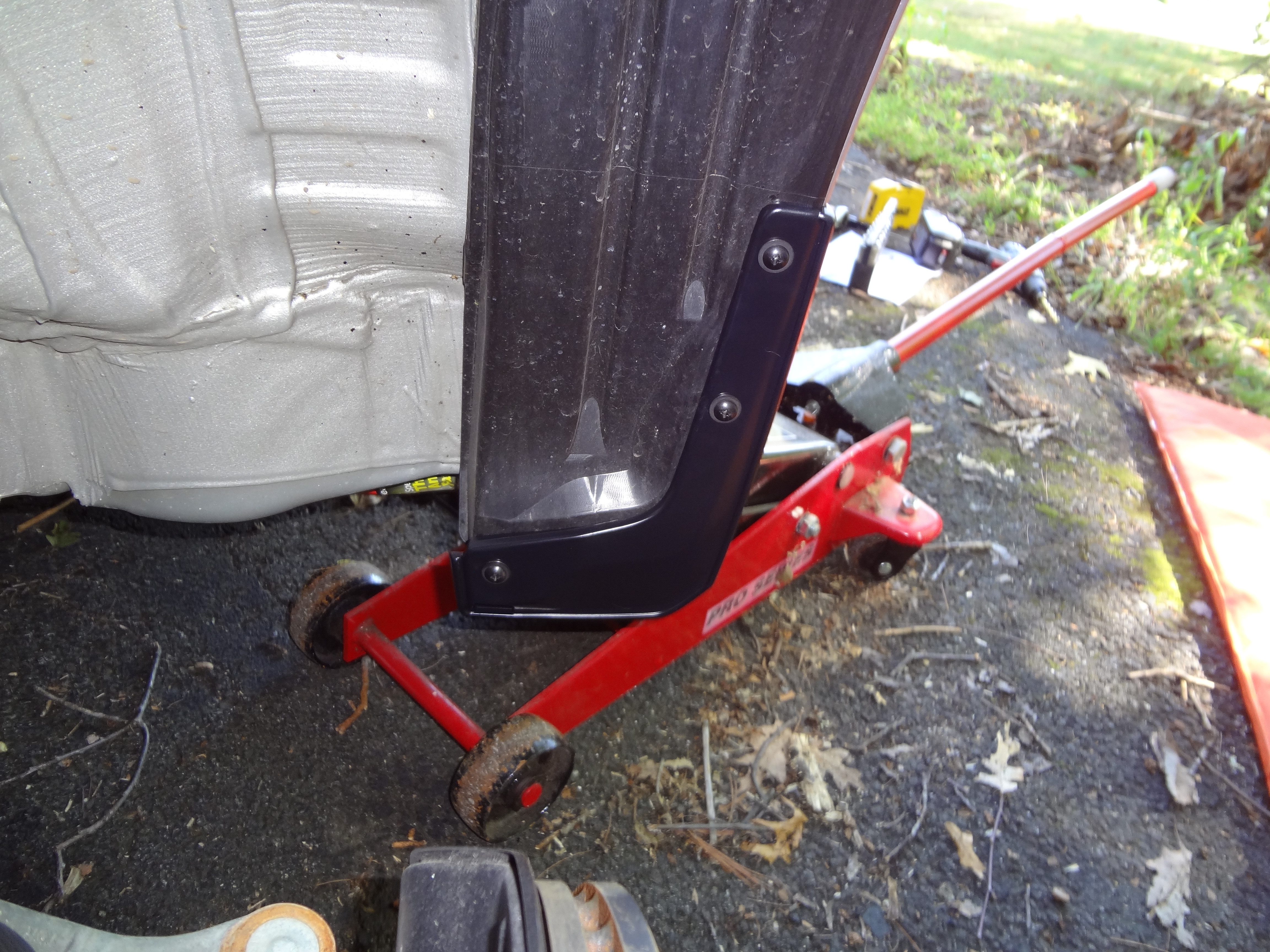

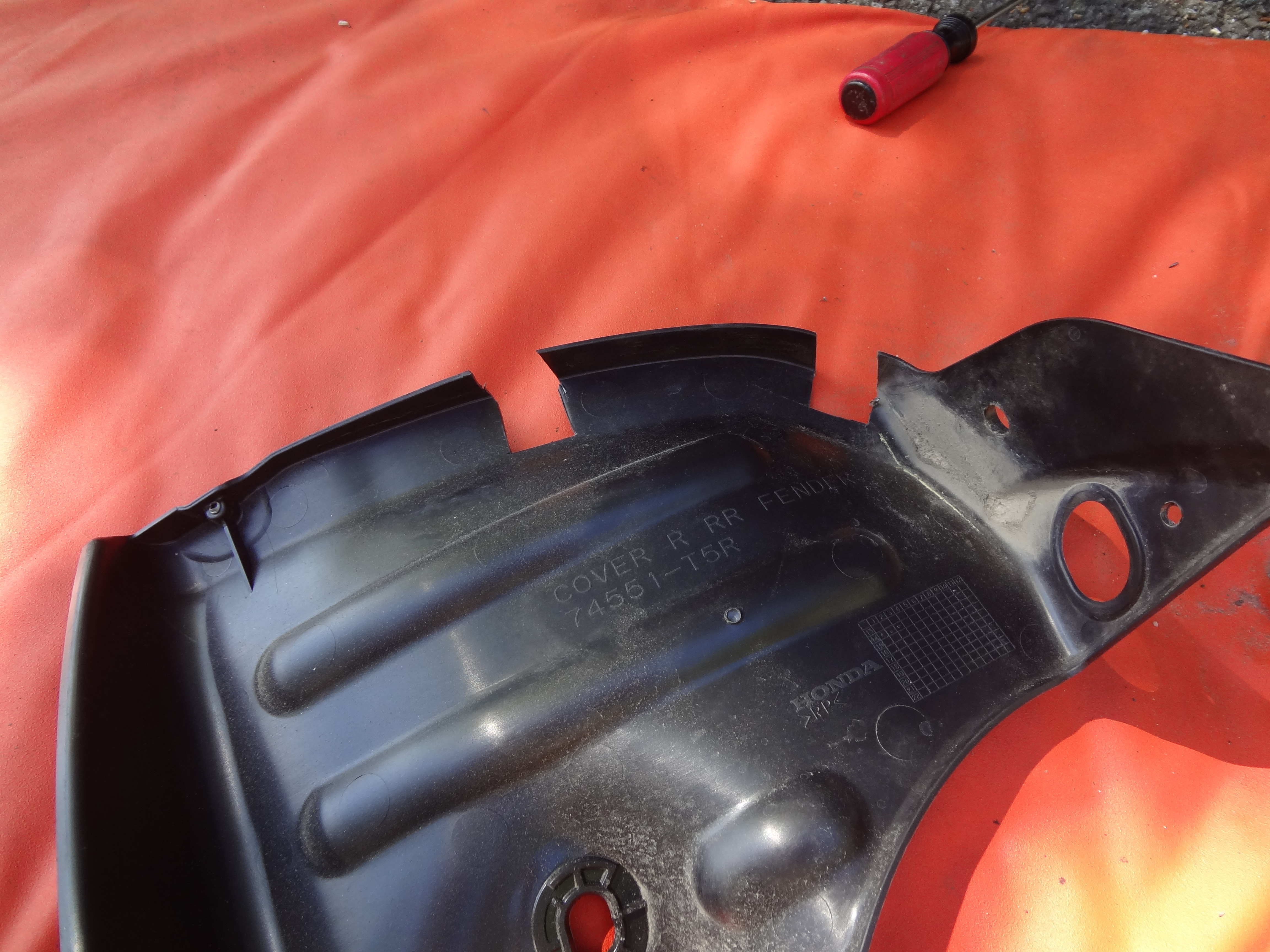

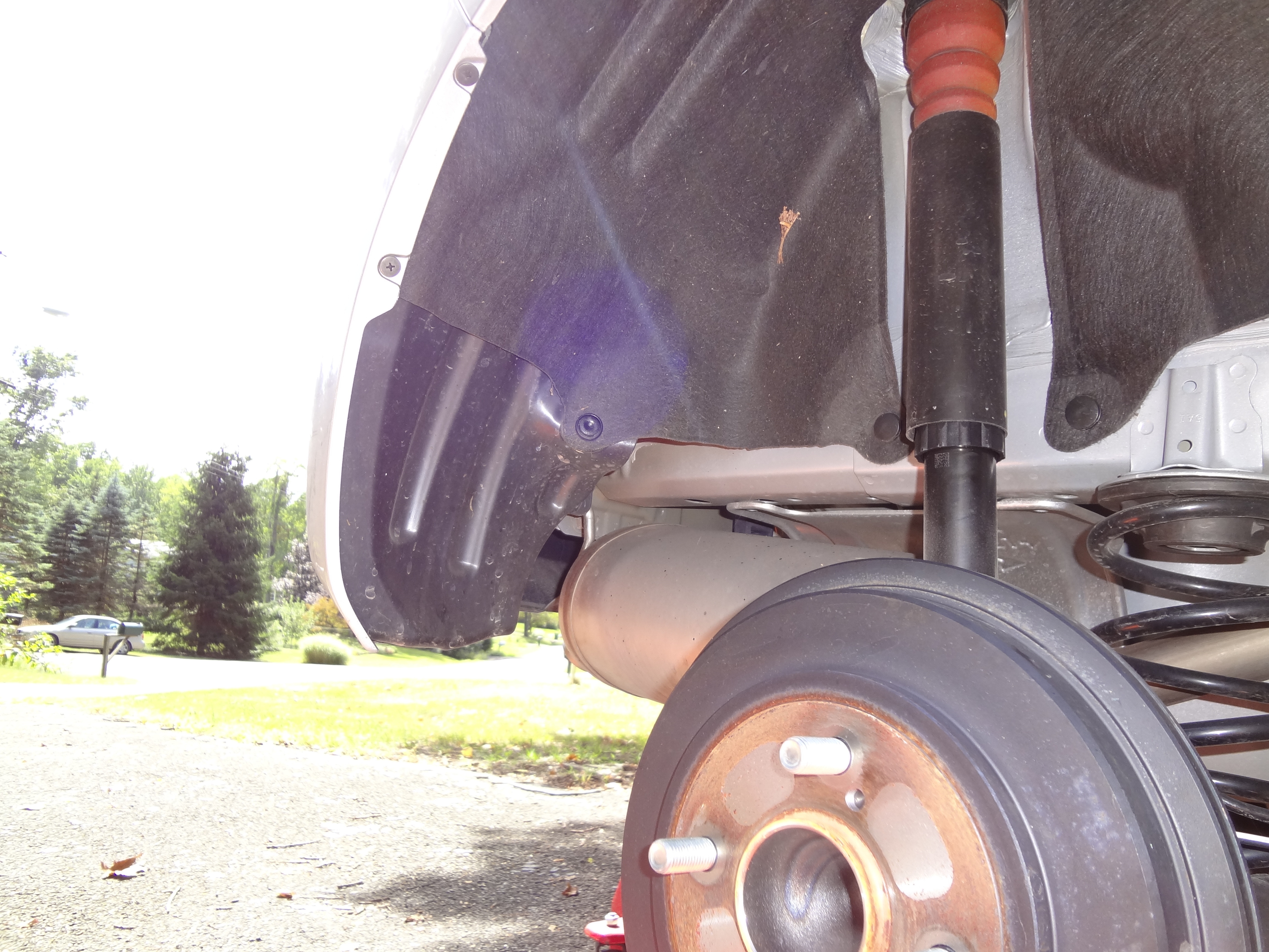

I just put the mud flaps/splash guards on my Fit. The fronts were very easy, but the rears took a bit of effort. I removed each wheel just to give myself room to work. It's interesting how Honda has put marks on the flaps and the fender shield to show you were to drill, poke, or cut.

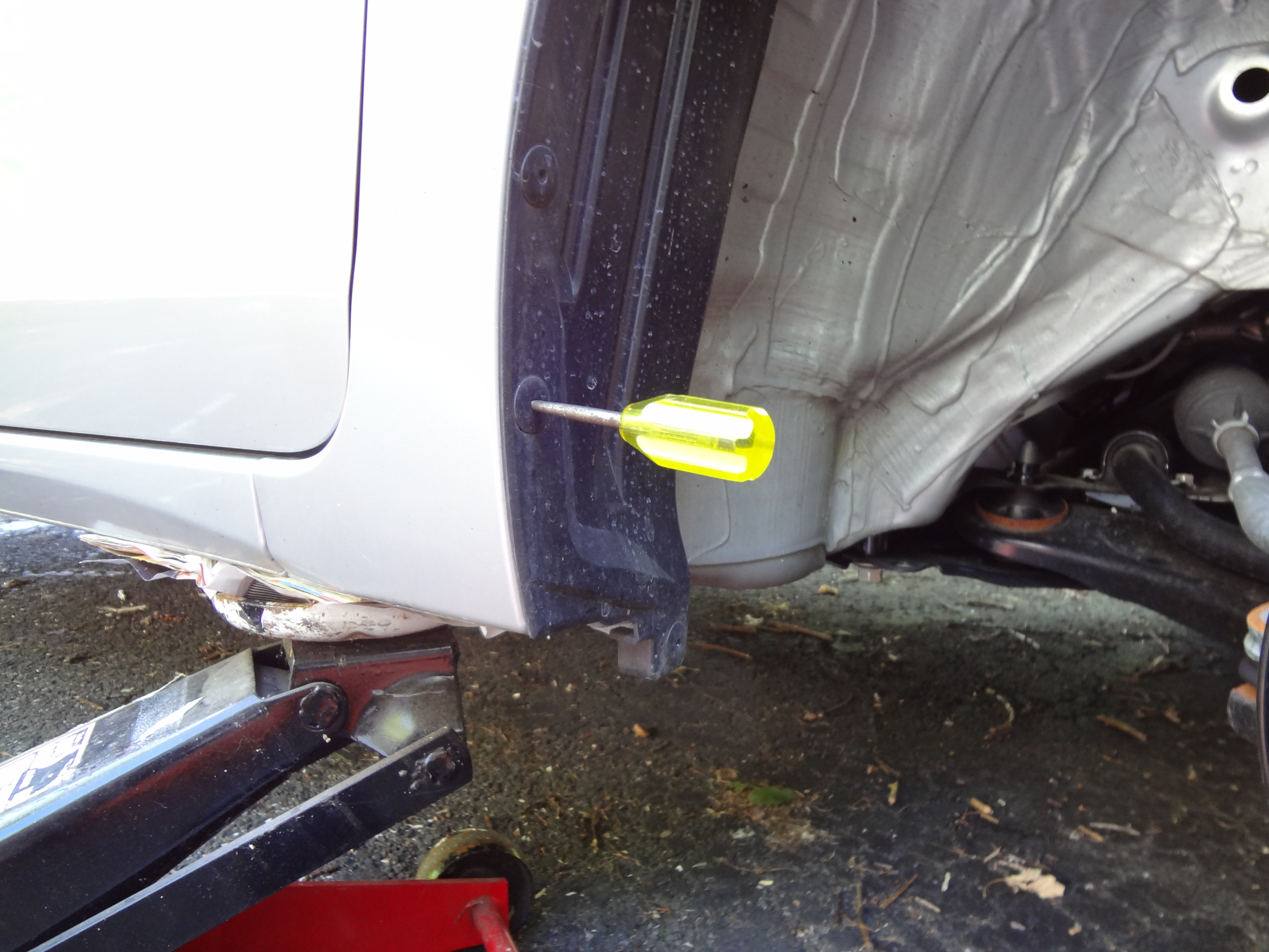

They say to poke a hole in the little dimple on the rear fender guard. Then drill a 3mm hole and then make it 6mm. I had to go into town to find metric drills. I finally found a set at a specialty store. Only kidding. I used 1/8" and then 1/4". That turned out to be a bit small, so I used a 5/16" drill, and that worked fine. After doing the first rear flap, I drilled into the dimple with the 5/16" drill first.

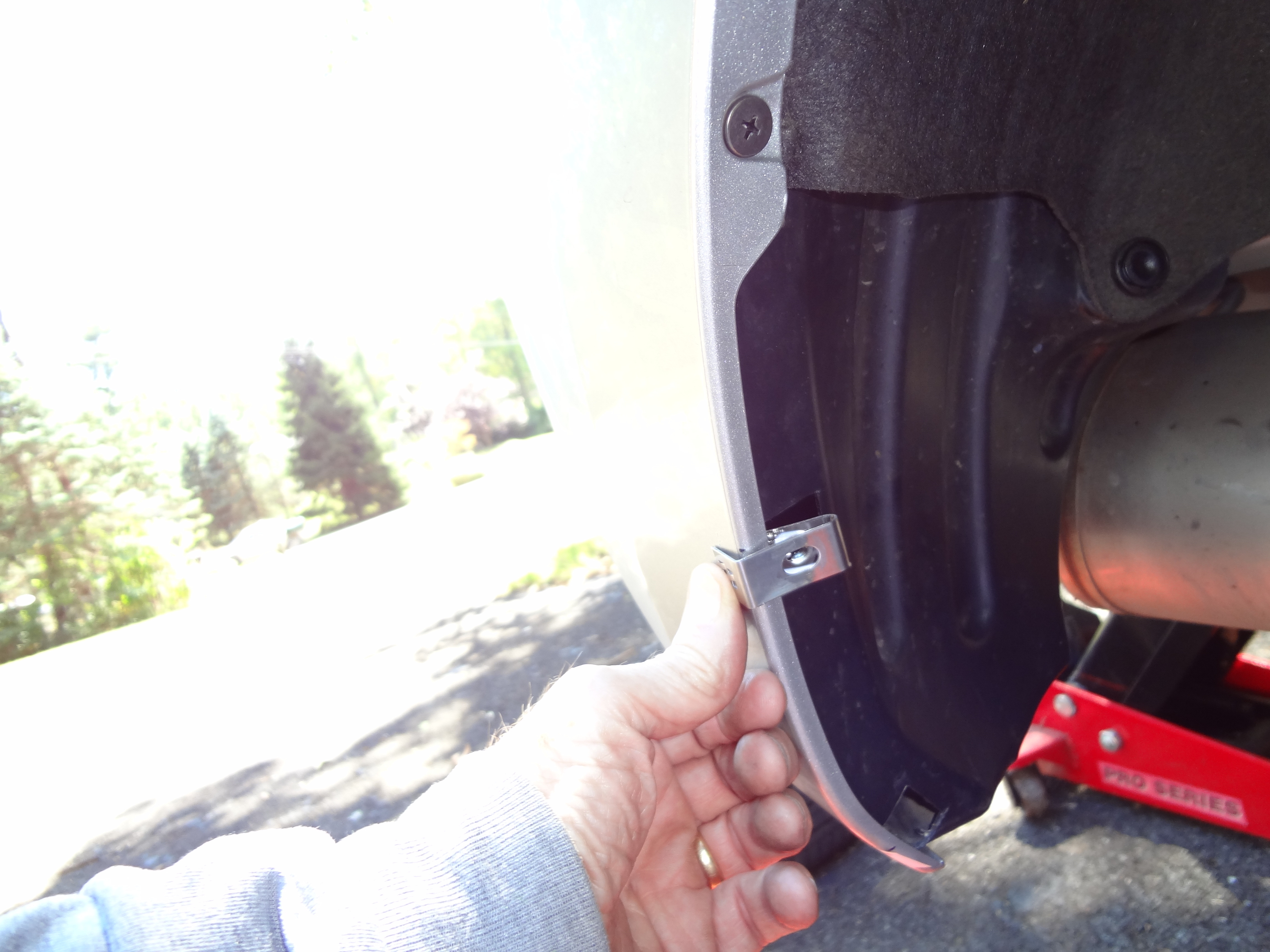

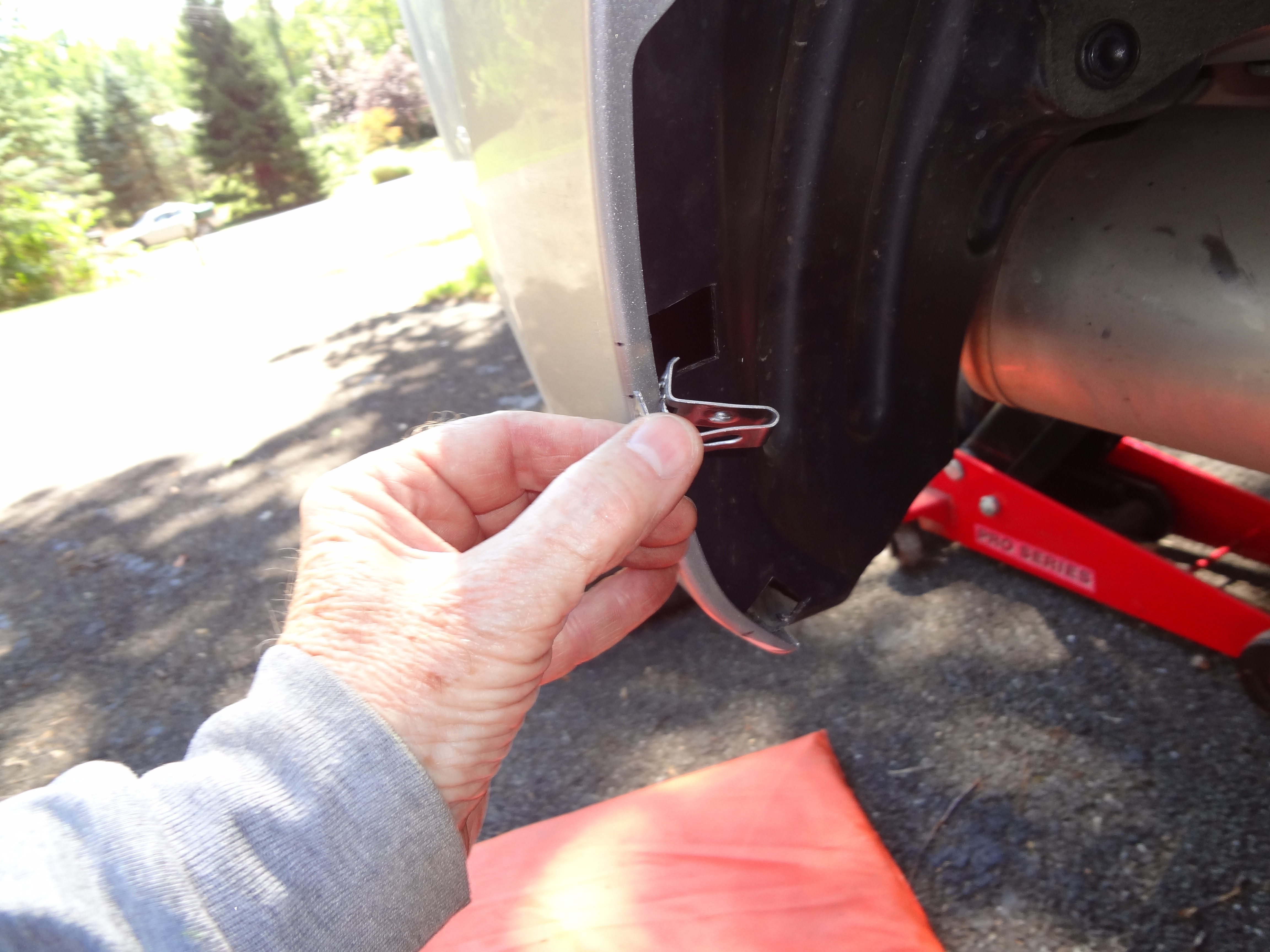

Then you have to cut along the lines on the flap with a box cutter - very easy. After you re-attach the rear fender liner to the car, you have to attach two metal clips. The directions were a bit confusing, but I figured them out. You tighten the screw into each clip, and that holds it onto the car. Then you remove the screw and use that to attach the flap.
Although the directions say to turn the front wheel right or left, depending on which one you doing, I lifted the car and removed the wheel.
The pictures might help, but the text didn't appear with them. You probably won't get directions with the flaps, but you can download a PDF here.
Honda online store : 2015 Fit Accessory installation (DIY) instructions

Nice write up! I was a little confused about how the clips attached as well when I did mine.
