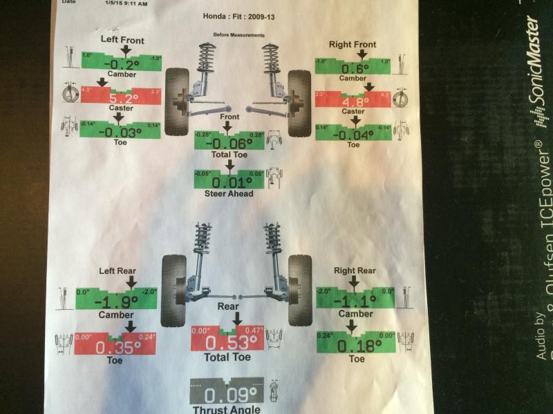

Here's the report on my Fit. I pulls to the right. I don't know what to do. They are ordering a "rear sub frame." Can the rear wheel being out of spec affect it pulling to the right? I'm bummed and don't know what to do to get the car to track straight. Advice is greatly appreciated.

Yes excessive rear toe can cause pulling to one side. An ezshim can certainly correct the left rear tire which has the problem the camber specs look fine. I'm not sure if your alignment shop would even install a shin and I'm not positive what they mean by rear subframe. It is not terribly difficult to install the shim but if you're not familiar with car mechanics it will be a daunting challenge.
report back and let us know. if I was in your position, and with the mechanical ability I have, I would simply install the shim myself, then return it back to the alignment shop and have them rerun the alignment specs again. Hopefully it would be corrected after the installation of the shim.

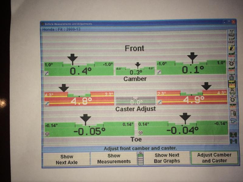

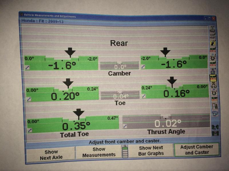

Here's the new numbers after picking up my Fit from having the rear suspension beam replaced. The before numbers are in my post above this one. Do the numbers shown below look OK? I need to drive the car more to see if it still drifts to the right.

Rear alignment numbers look much better and are within spec. You shouldn't have any tracking issues or major wear issues.

The front toe is easily adjustable and i would have them adjust it to be on the positive side of center. That's if they will? But ideally you want the toe to be on the positive side not negative. Will it hurt anything? NO. But it will help tire wear in the long run as you get a lot of miles on it.

Thanks for the info on my new numbers. I doubt I can get them to adjust the front toe though. I don't think they want to see/hear from me again on my alignment. I wish I knew about about the car stuff. I would have talked to them about getting a positive toe on the front before I left.
