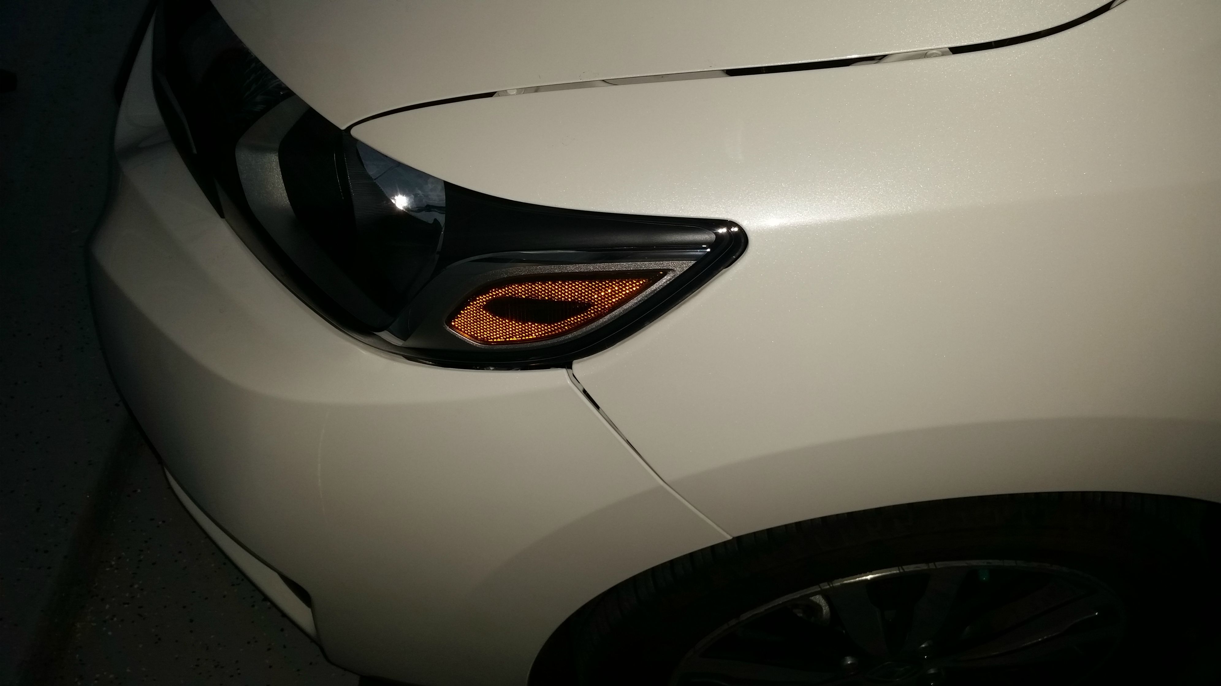

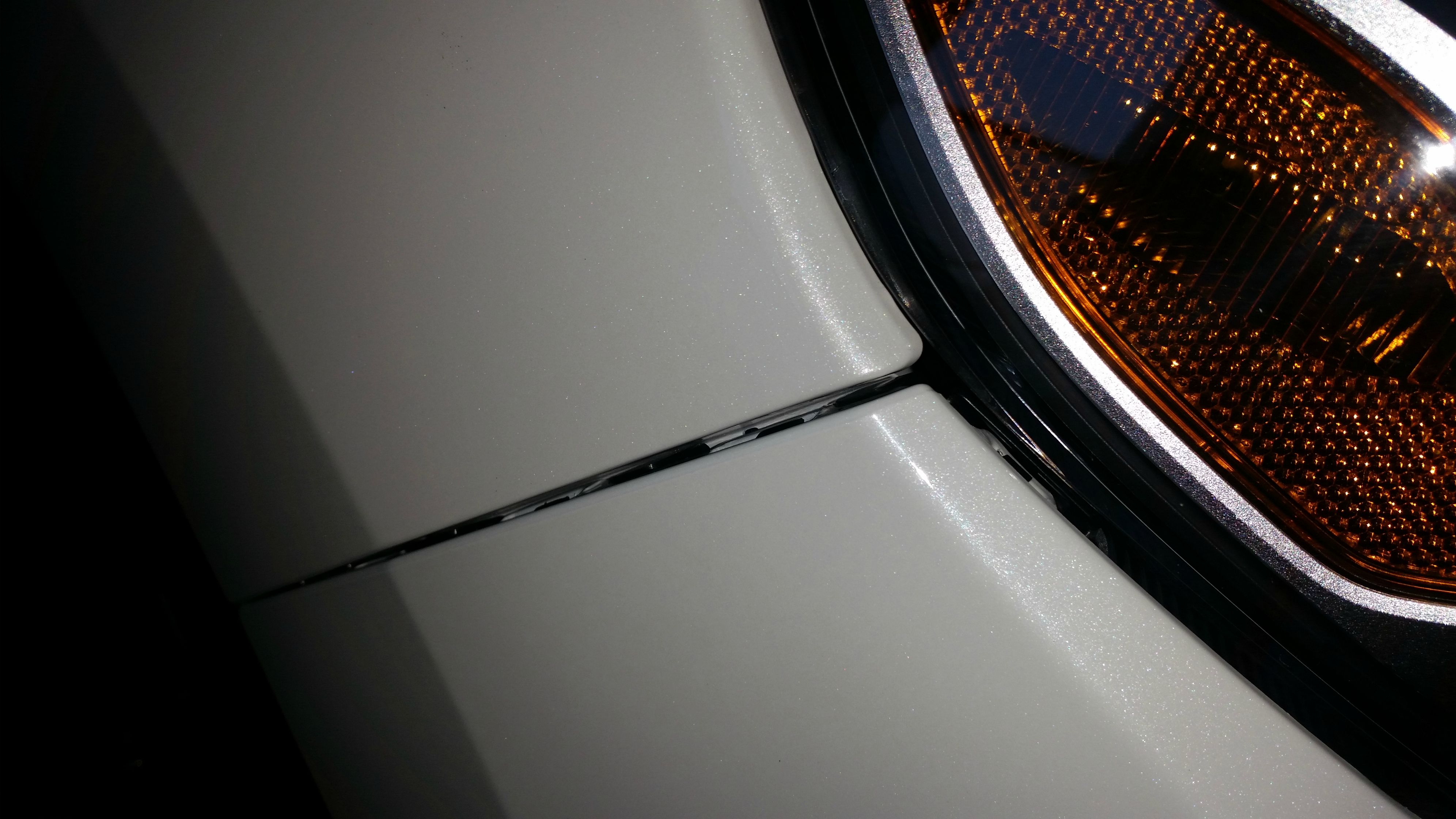

So I purchased this car at Honda of Katy. I noticed this bumper issue before buying the car. I asked them to fix it before I took delivery of the car. I am assuming they just pushed it up and or taped it or something. Because the second I got home and looked at it was back to normal.
Fast forward two months and the car went to Round Rock Honda Service because my sun visor kept falling off when turning it to the left. They also looked at the bumper alignment. Kept the car overnight to have a Honda Rep look at it.
They took the bumper off, inspected clips and mounting points, everything looked like normal. Go to put it back on and it just wont line up. They got approval to send my car to a body shop and attempt to clip it into place. However he doesn't even know if they can push it up and fix it.
I went so far because I remember when I bought the car the bumper fix was on paper somewhere. I pulled out all my docs from purchase and its not on the WE OWE, or any other document. I now believe it was on the Sales Quote worksheet which doesn't get filed or saved. Meaning that I don't have documentation I asked to fix it ever before purchasing. It now becomes a who said what battle. So for all you other buyers. DO NOT BUY SOMETHINGS THAT'S BROKE, GO FIND ONE THAT'S NOT! ITS YOUR MONEY DON'T LET THEM SCREW YOU OVER.
Problem #1 - If I even need a new bumper for whatever reason, my car has been or will be modified with new bumper tabs. So any normal OEM bumper will no longer be able to fit without the same modifications.
Problem #2 - If they cant fix it. I was told there is nothing they can do and I am stuck with a misaligned bumper forever just because Honda cant produce products in Mexico with the same standards like they do in Japan. The worst part being I saw it before I bought it. I should have just left and never bought something that wasn't 100%. The dealer has that way of making you feel good when selling you terd.
Dont get me wrong I love this new fit. I bought it outright with no loan, so I planned on keeping it a while. Ive owned tons of Honda's with no trouble at all. Every time I walk past the front of my car this will leave a bitter taste in my mouth associated with that large H emblem I've come to love.

Onto the Pictures.

I too have recently noticed my front bumper being misaligned after 8000 miles. I know for a fact that everything was lined up perfectly before I had taken delivery. The gap between the headlights and bumper is where it's most noticeable while washing the car.

Both my front and rear bumper are misaligned as well and seems pushed in. Didn't notice the rear bumper was misaligned till about 1 month of owning the car while I was washing my car. I checked the front and it was okay. Then couple months later, I noticed the front was misaligned.

Hey, that looks just like mine! Yeah, you can find several posts about that in the forum. In Houston also, finally seeing some 2015 fits around town! Had mine for 8 months at this point. I think one post said that their bumper was like that after the bumper recall but not before?

Mine is the same way. My theory is because the new bumpers were designed for the us market only, Honda half assed it and did not account for the extra strain a longer overhang bumper would put on the mounting tabs. This is evident because a JDM bumper fits on the usdm fit without modification of the mounting tabs. I suppose with the different bumper structure underneath it could support the newer bumper without sagging... But evidently not.

I have my Fit on 1,500 miles now and front left bumber is start showing misalignment now. When I bought it from delar, it was pretty aligned but the gap is a little wide & I didn't give attention. After I drove a few hundred miles on freeways, the air push down the front bumber and getting misaligned now IMO. I will post the picture later.

My story
I have a 2015 fit that I bought in June. I took it in for the refitted bumper in February and it came back to me just like the pictures above.
I pitched an absolute fit (lol) about the issue. I even took pictures of brand new cars for comparison.
I troubleshoot computers for a living, so I ended up directing the service manager and his team on how to fix this. What we found was that there are clips where the plastic bumper meets the body. These clips had stress damage when the bumper cover was removed to get access to the bumper beam.
The service manager pulled a brand new car into the shop and we removed it's front clip and put it on my car. We still had the issue. So what he did was remove the mounting clips on either side of the bumper and put them on my car. Then the new bumper cover fit perfectly.
In the end, I have a completely new front flip, including the bumper cover, the bumper and the mounting clips on my car. But it fits perfectly.
If your bumper looks like this you need to replace the bumper mounting clips. It isn't the bumper or the cover that is the problem.
