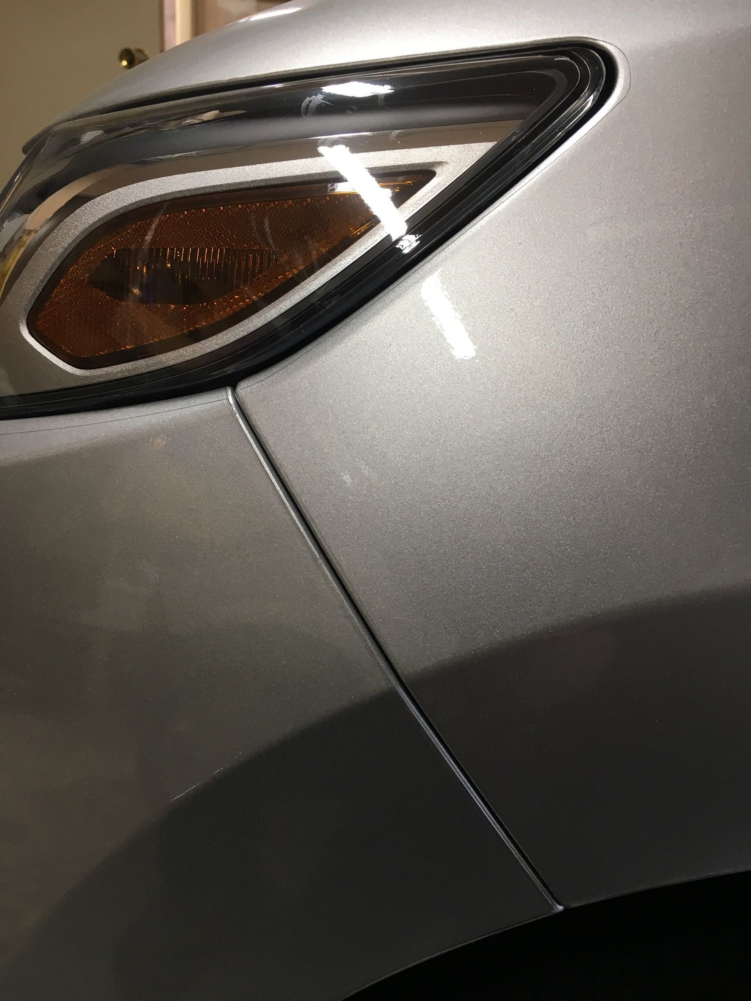

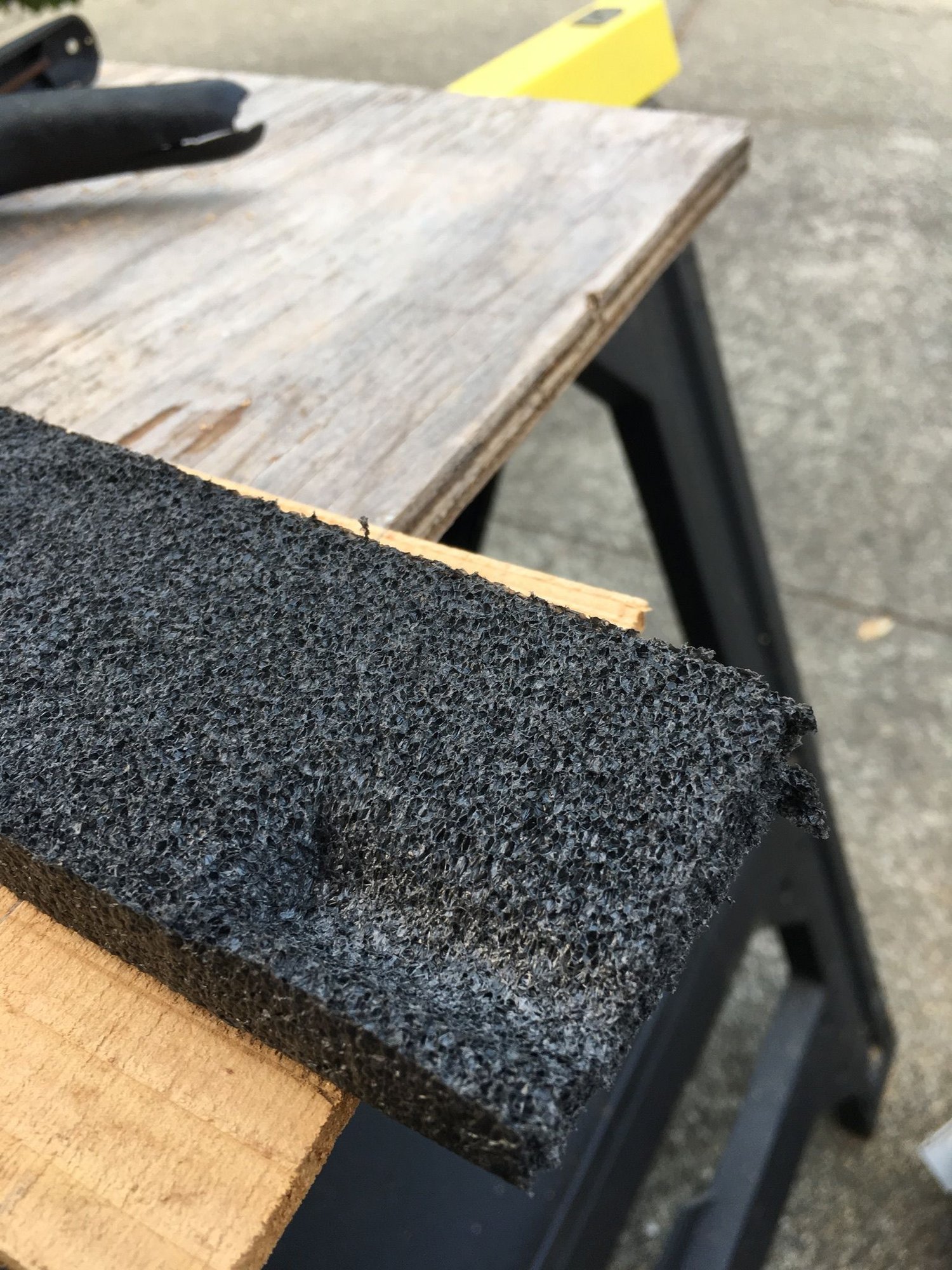

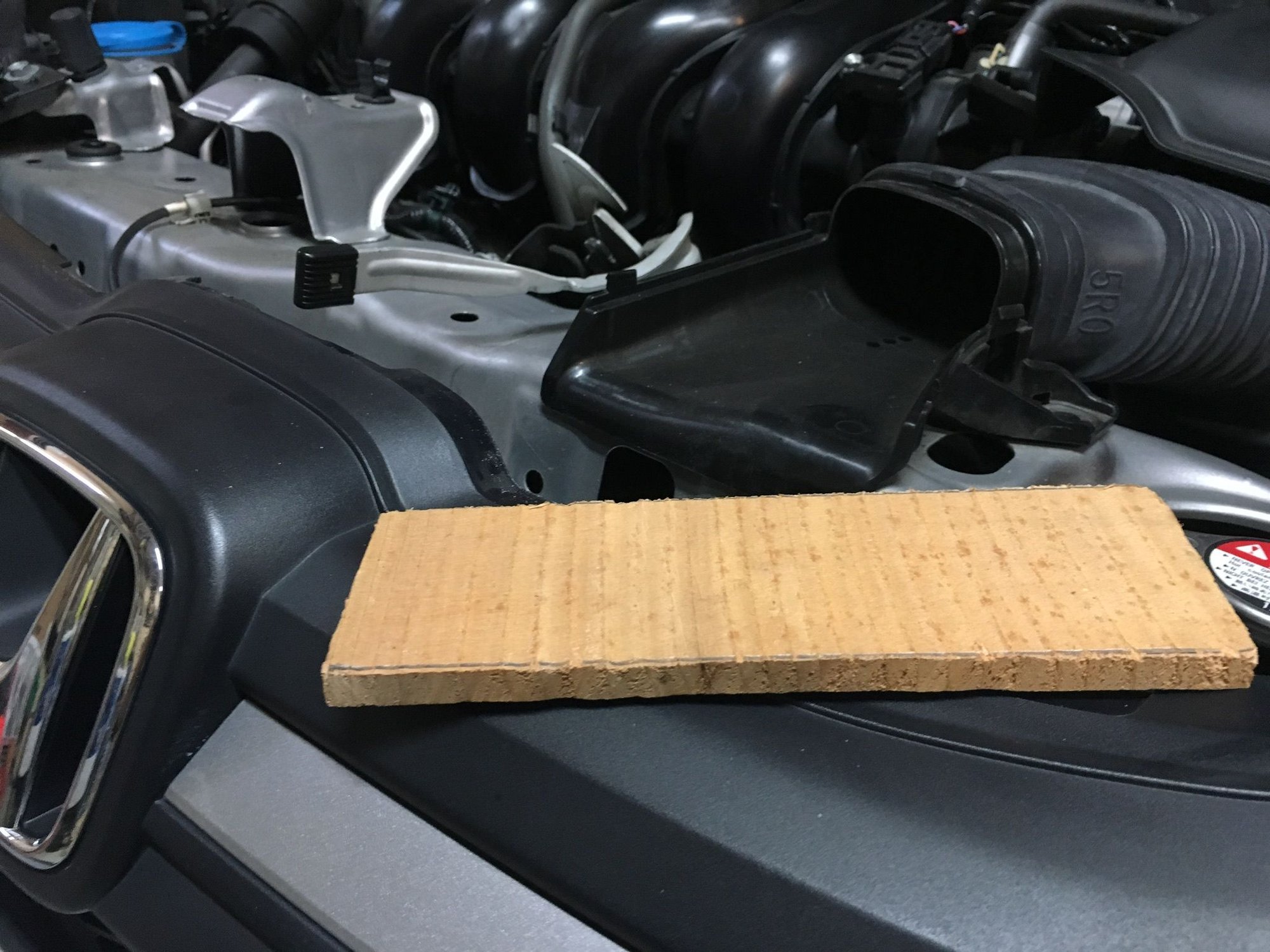

I was not happy with the foam fix. The gap came back some after about 600 Miles highway driving. The foam compressed. I replaced the foam with two pieces of wood wedged in the same spots. It tightened up the gap perfectly. Will see if it stays this way.
