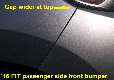

  #36
Odie's Avatar
Joined: Apr 2011
Posts: 724
From: usa
Thumbs down
The '16s have the same issue fresh from the factory of Japan . Drove this in late February .
Attached Thumbnails 2015 Fit Factory Front Bumper Mis-Alignment-dscf6460.jpg   2015 Fit Factory Front Bumper Mis-Alignment-dscf6459.jpg   2015 Fit Factory Front Bumper Mis-Alignment-dscf6454.jpg   2015 Fit Factory Front Bumper Mis-Alignment-dscf6455.jpg   2015 Fit Factory Front Bumper Mis-Alignment-dscf6462.jpg
2015 Fit Factory Front Bumper Mis-Alignment-dscf6464.jpg   2015 Fit Factory Front Bumper Mis-Alignment-dscf6465.jpg
