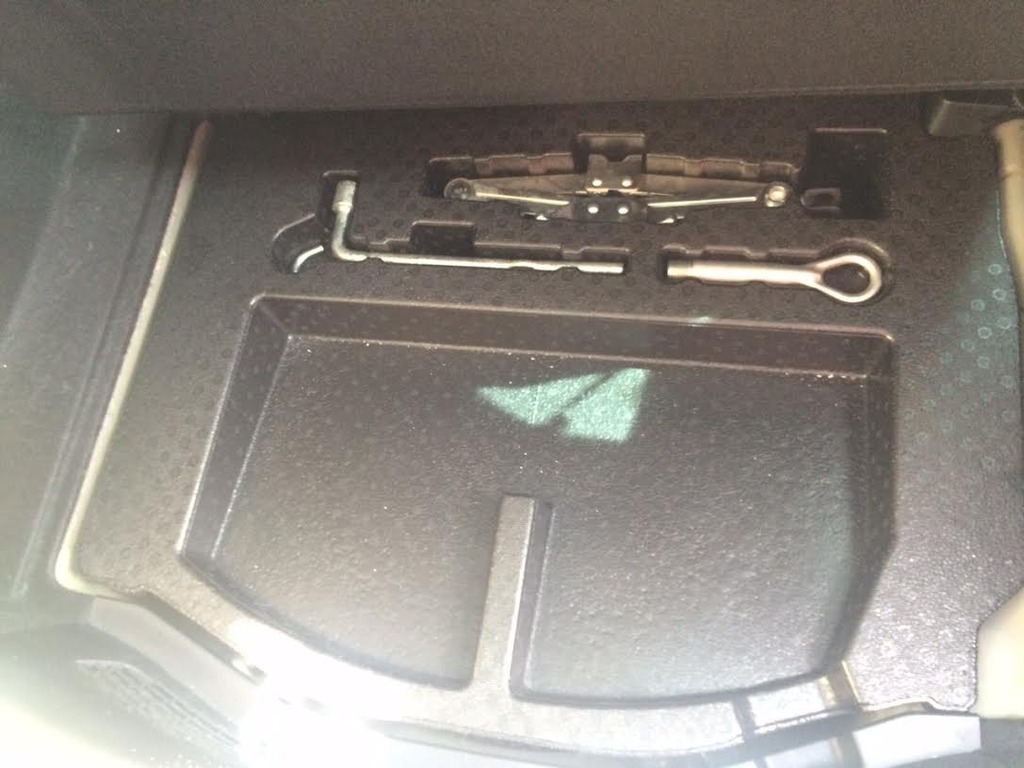

I just put 3000 miles on my fit and put some subs in the back around 1000 miles. I started hearing a squeek/crunchy sound after I put them in especially when I would go over speed bumps. I was cleaning my car a few days ago trying to vacuum out dog hair and I figured out what mine was from. In the rear of the hatch there's a floor cover that you can lift up. There is a piece of black styrofoam stuff that holds the tools for the spare tire. My subs sit over part of it and it squeaks when I go over speed bumps. I thought my shocks could be defective or something at first as well. Not sure if you guys have the same problem but that's what it was for me. Damn that styrofoam.

Thanks for the tip. My car is at the dealer's shop now. I left it there yesterday for the week and am awaiting an update in a couple of days on what the fix is/was. If no solution is apparent, I suspect we will have some very pointed discussions on what the Plan B options are.
I looked at the foam storage piece and it seemed to be secure, with nothing rubbing it. The spare was also securely fastened. But if I had the car right now I might remove both just to eliminate them as suspects.
