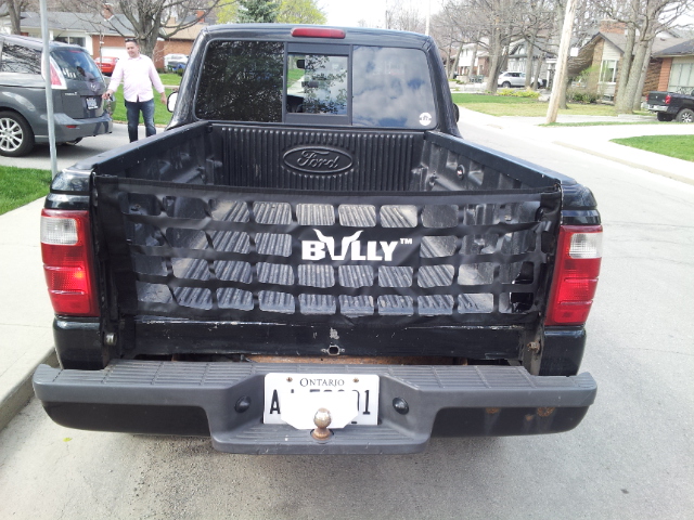

Correct, easily removable with two pins. Ramp weighs around 80 pounds I estimate. Recently I've been using one of those net tailgates for trucks on there. Sure Trac does not make a solid tailgate for their utility trailers unfortunately. See example below.
As a result of removing the ramp the tongue weight increases slightly when empty since I'm taking weight off the rear. Easily compensated for by loading more towards the rear of the axle to keep the tongue weight around 100 pounds or so.
