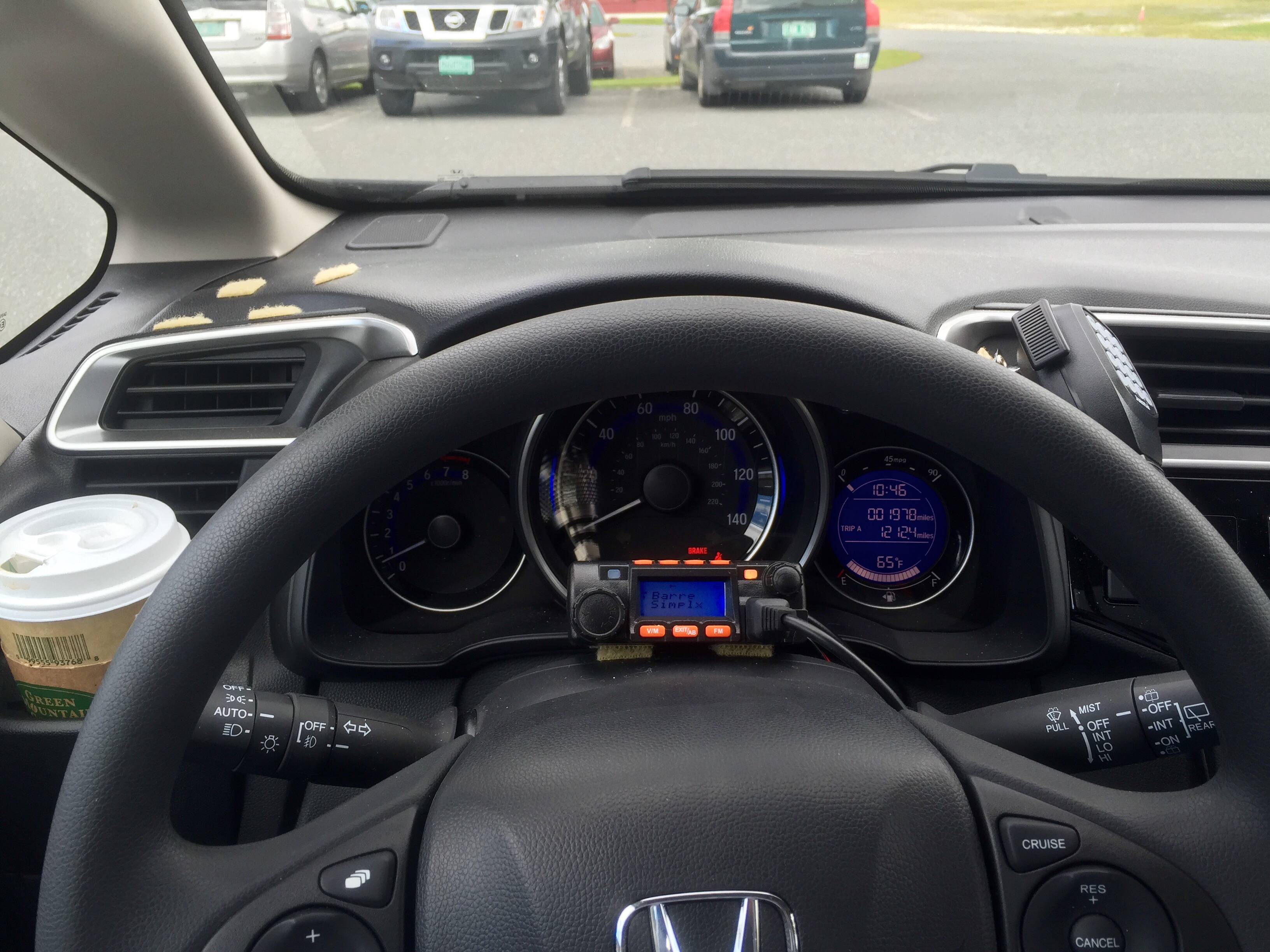

I'll pull it back in. Here is what I went with for mounting.
It sits well right on top of the steering column, and don't cover anything I need for driving.

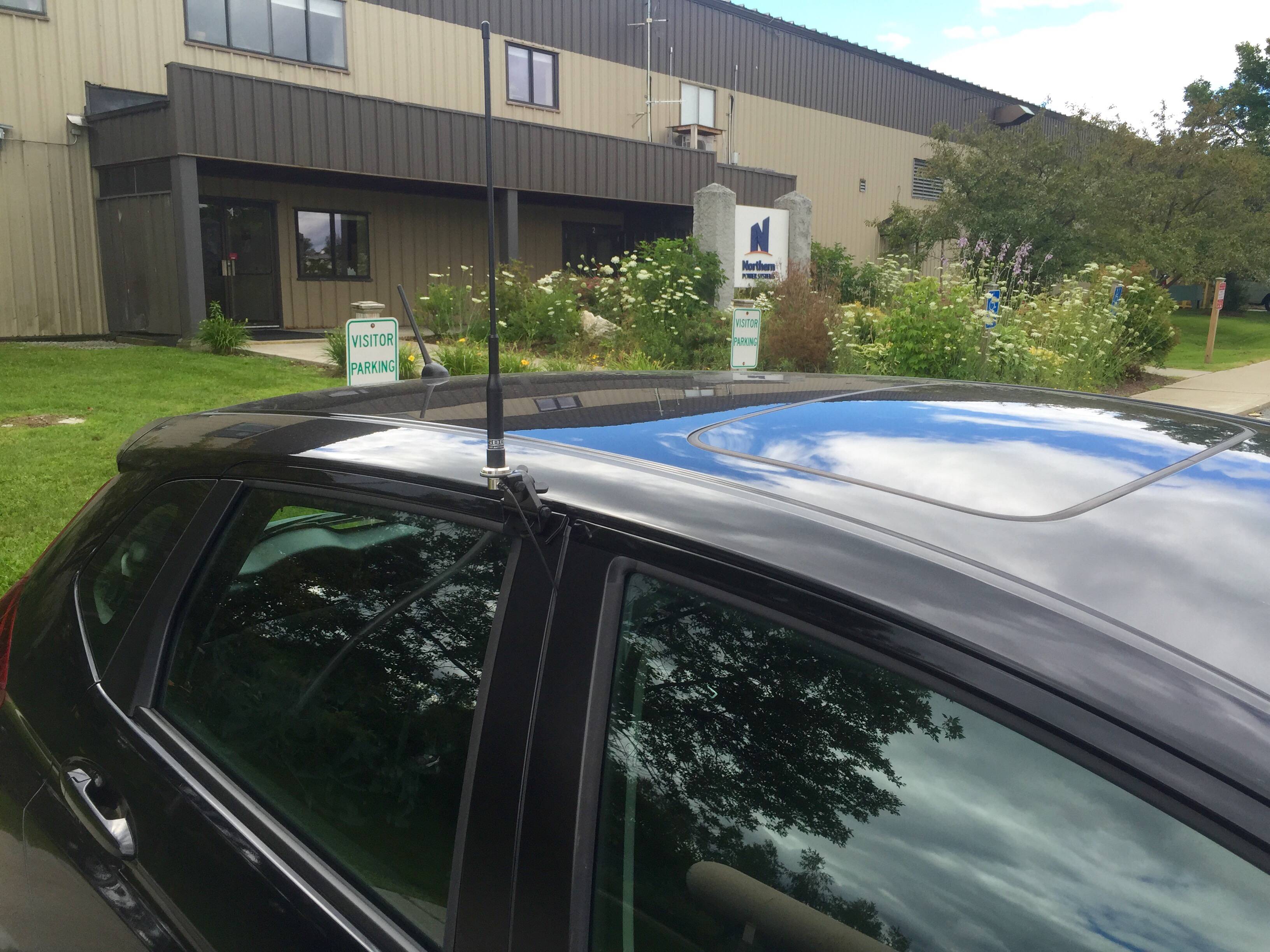

The antenna is mounted to the rear passenger door, and it actually looks pretty good there.

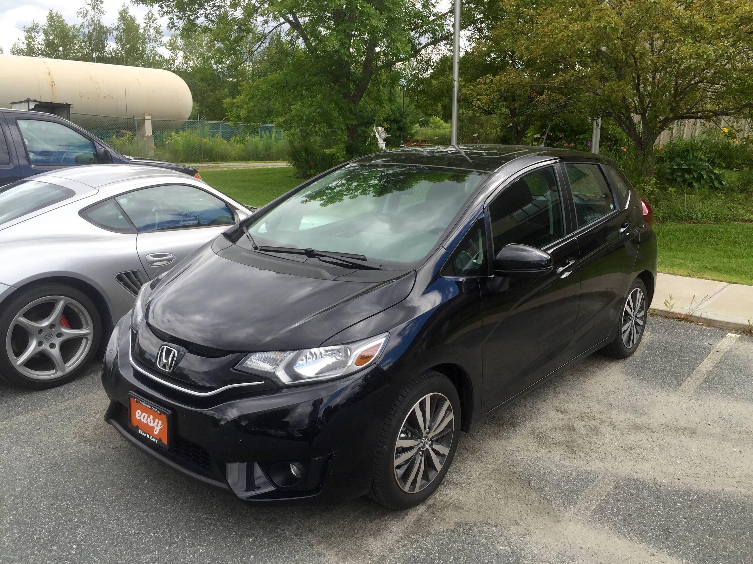

For the lulz, here is a picture from the front. I cannot wait to get this thing dipped.

Wow, you're not kidding, that unit is very small. I was thinking of the CB/Ham radios from the past that were the size of a small toaster. Your location on top of the steering column is exactly where I keep my ScanGauge. Fits perfectly and doesn't obstruct anything.
BTW, nice Cayman.

The radio is a cheap Chinese radio, a Juentai JT-6188. It's a 25 watt dual band radio, and it cost about $125. That's less than half of what a decent dual band radio would cost from one of the better known manufacturers, and less than it cost for the antenna system I have it on.
For anyone else interested in mounting a ham radio station on their car, I've got a Comet SBB-1 mounted to a HD-5M on the door. I've got the coax running down the door, across the rear passenger side floor (under the mat), up under the center console, and up through the steering column. There is a gap you can fit your hand through to pass a cable up if you unlock the column. I am using 3M Velcro squares to mount the radio and the mic clip, but I plan on screwing the mic clip down later.
