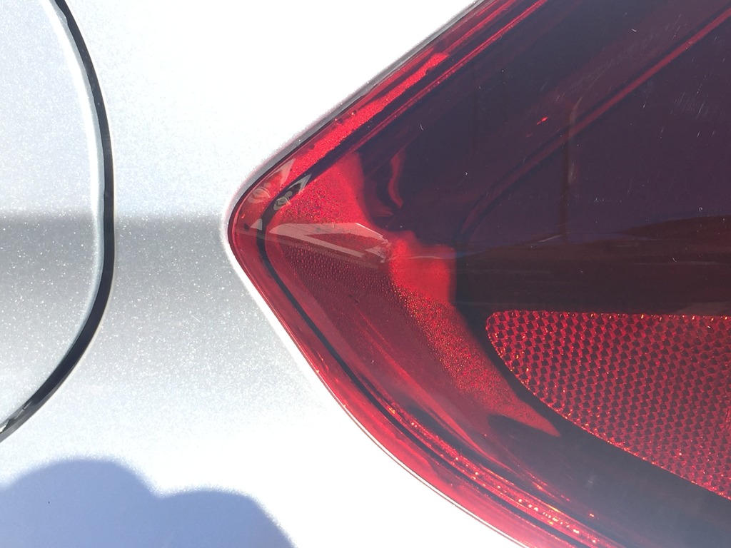

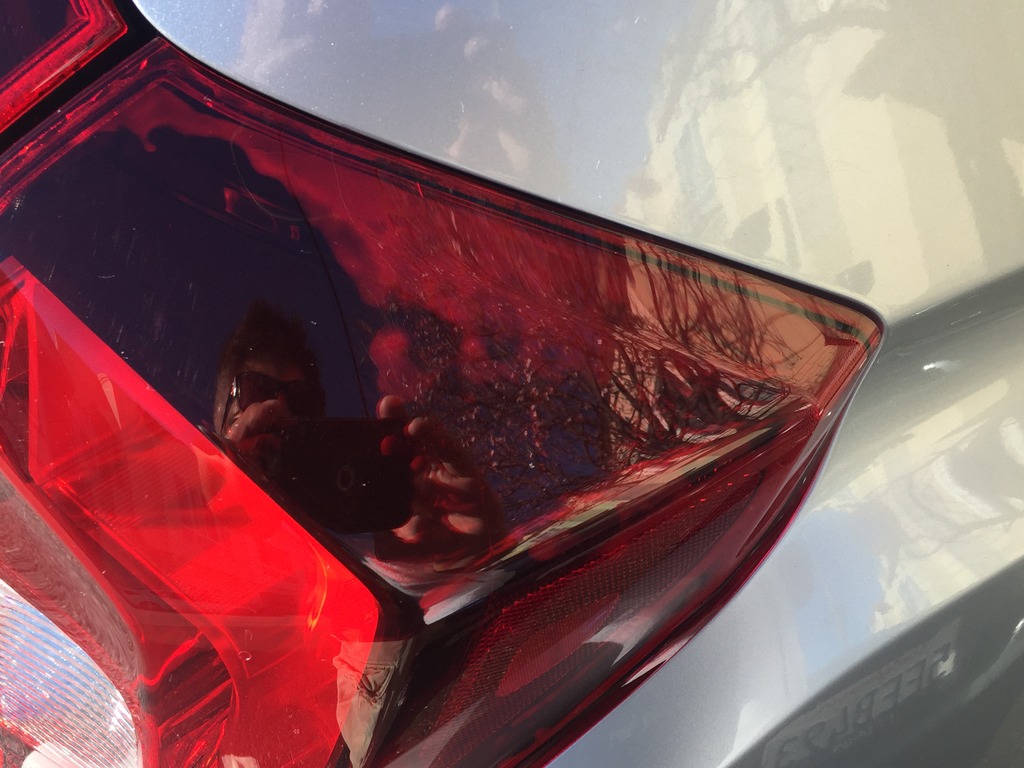

Anyone else experiencing this?
It's happening in both.

I am seeing it in both back up light lenses.

I wonder if these can be replaced under warranty? I'll find out when I take it in for the door handle recall.
Let us know how that turns out.
According to the 2016 FIT manual on page 400, this is considered normal. So they may play that back to you instead of replacing them.

I had some in mine when it was new. It disappeared after driving it a while and it hasn't come back.
The owner's manual says a bit of this is "normal" but yours looks like more than I had. I'd see the dealer about it.

The owner's manual does say it's normal. Only if water starts to build up inside you should go to the dealer. Funny. Oh well.

Its not normal there just covering there asses. I would take the tail light off and check that all the bulb are snapped in and tight. when I put my LED lights in they where not snapped in all the way from the factory

Some amount of condensation is normal since the housings breathe and, when shutdown hot at night and full of hot and humid air, they draw in warm humid air as they cool. By next morning the warm humid air is cold humid air and condensed water.

Yesterday I was mesmerized by the water in the backup light fixture of the CR-V driving ahead of me. The fixture was half full! I could see it slosh around as the CR-V turned and stopped. I would have loved to watch the driver backup so I could see if the bulb still worked.
