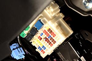

I am looking at going LED on turn signals and would rather swap out the turn signal flasher relay than add resistors. Where is the flasher located ?

I suspect it is in fuse box A, under the dash, left side, just like all other Honda. One of the three rectangular modules.

I don't know. Should your LED kit come with the replacement flasher if you decide not to use resistors? Sometimes those LED kits already come with resistors in the assembly, no? Then you don't have to replace the relay. It becomes plug and play.

If it is anything like the GDs it is in the cluster and not replaceable.

Flasher is internal to the MICU (in the underdash fusebox)

You have 2 options because I was trying to do the same thing but the relay is integrated with the cluster unless you want to take it to the dealership and have them do it for you then the only way to do LED turn signals without hyper flash is to use resistors or order led bulbs that are made to stop hyper flashing which is around $70 because I checked there is only one company that has them and they have a patent on it.
7443 7444 CANBUS Error Free Anti Hyper Flash Switchback LED Turn Signal Light Dual Color Blinker Bulb
you can order them at www.lasfit.com search 7443 led
