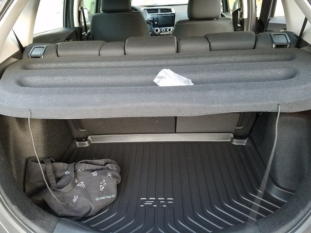

I bought a Cargo Cover for my Fit and it doesn't seem to fit right. I bought it off Ebay and the listing says it was for the 2018 Fit. The seller was a Honda dealer.

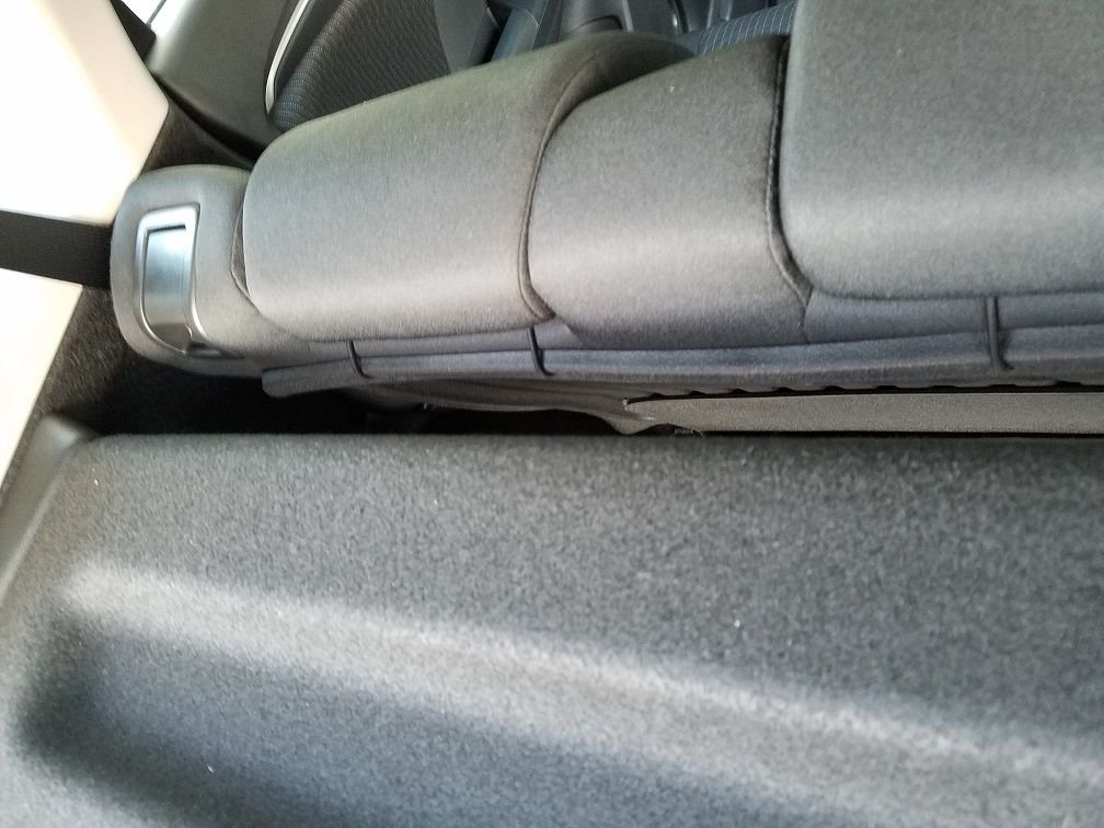

There is a big gap inbetween the back seat and the cargo cover, which completely defeats the purpose. You can look in the tiny back windows on the sides and see all my trunk contents.
My seats are moved back all the way.

Did you release the plastic latches on each side the rear seats so they will recline?

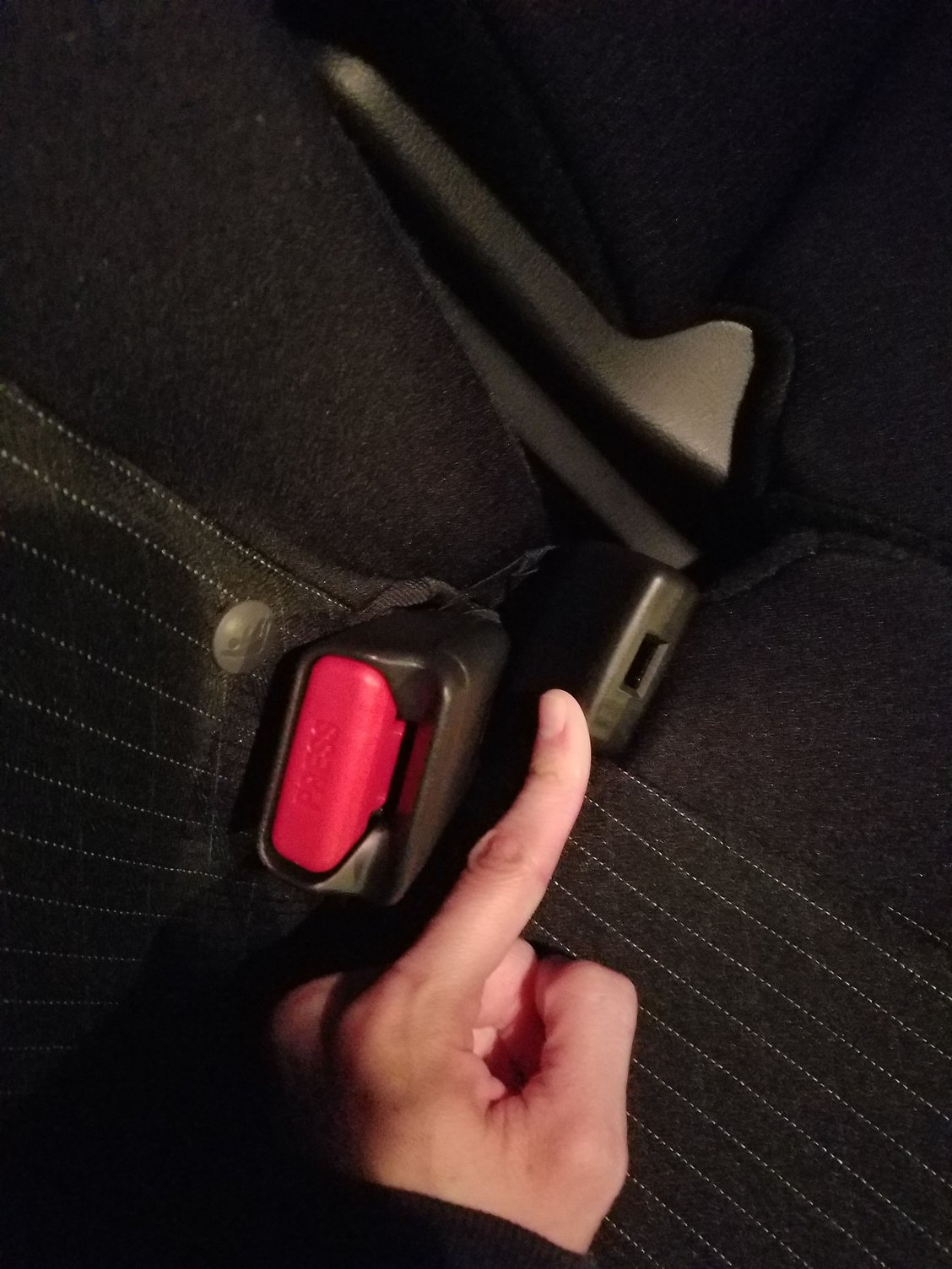

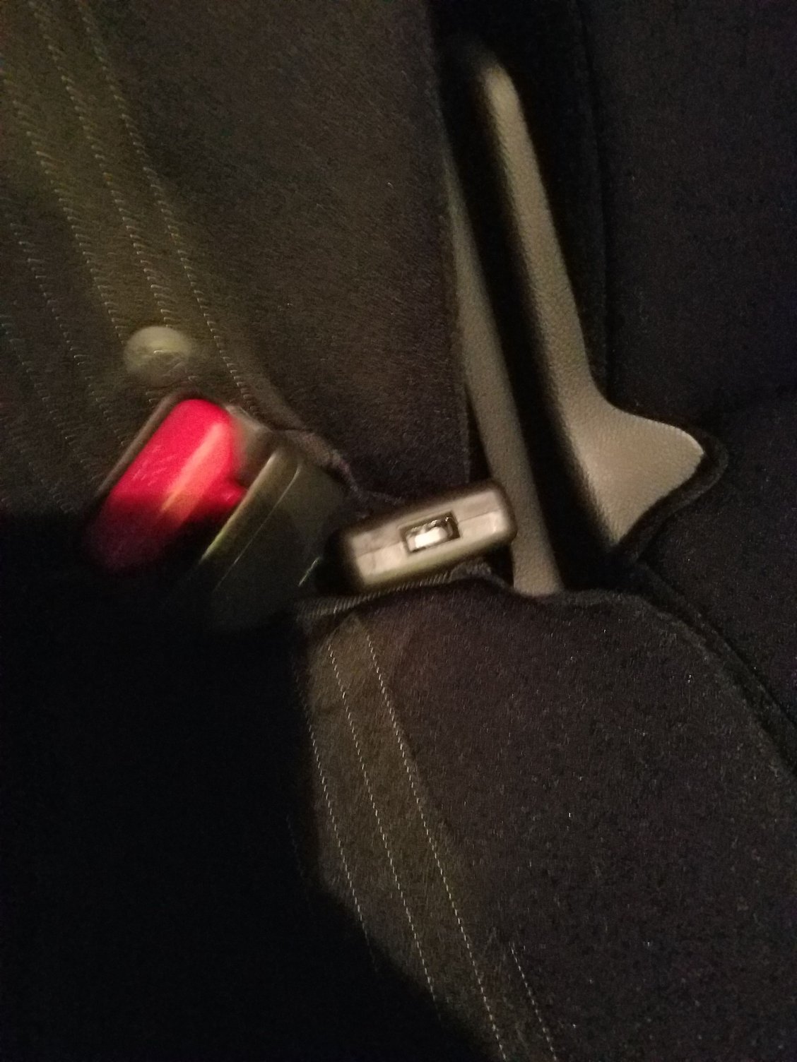

Well since I'm here in the back seats looking at things can someone tell me what this thing is?

was that the latch that hooks up to the ceiling belt? cant remember
Yes! Neat.

Yes.
The back seats slightly recline.
In my owners manual, it's under "adjusting the rear seats".
Recline them back and the gap will disappear.

I did, the gap went away lol I thought they were already reclined.
