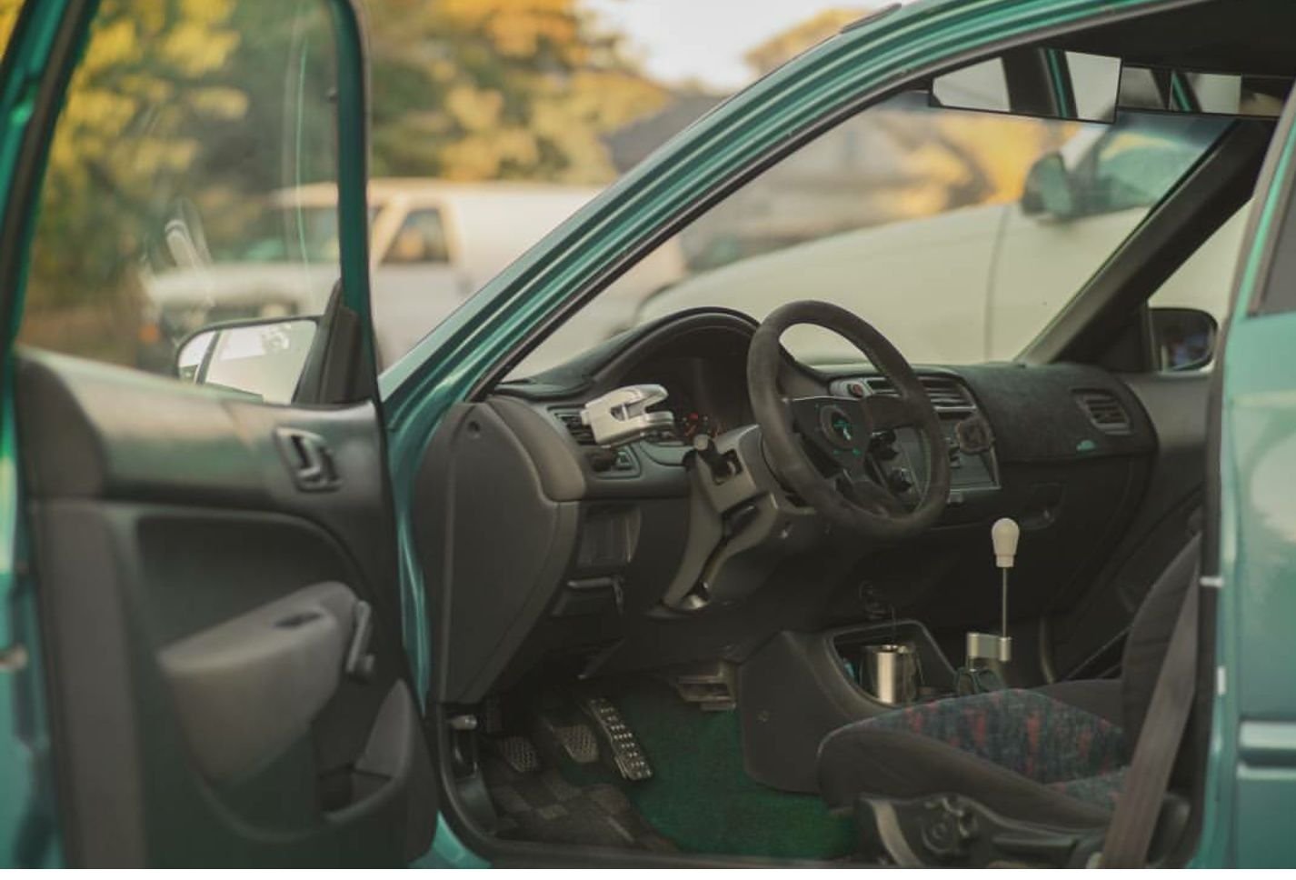

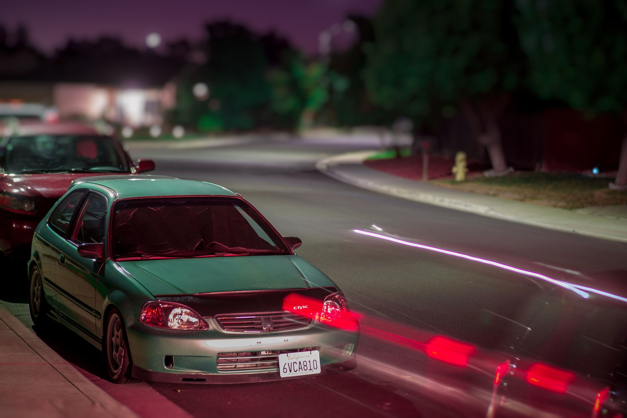

This is my dedicated touge machine, 2100lbs, 200 crank HP semi built b16b with port matched and polished usdm p30 intake manifold, 4.7 final drive 98 spec itr trans with lsd, i can harass fk8 type Rs, 2018 sti, e46/e90m3, ap1/ap2 s2000. Of course driver skill is a huge variable, and ive been driving those kinds of roads almost 20 years now.
