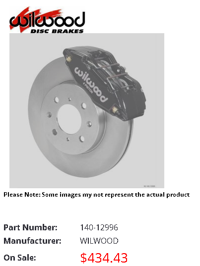

LAST suggest:
$434.43
WILWOOD 140-12996
https://sportcompactwarehouse.com/wi...D=pwf320585g1&
