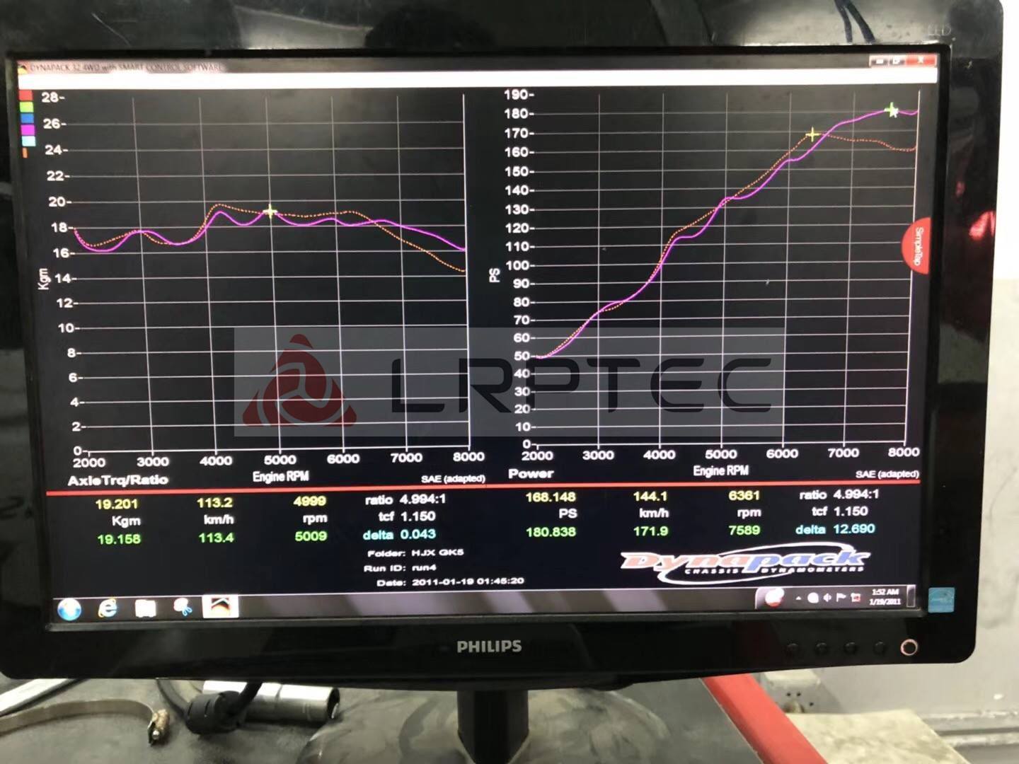

Stock intake manifold with 60mm throttle body max torque19kgm,max power 168ps,the new one with 60mm throttle body max 19kgm,max power 180ps.+12ps,Just one pull and the ecu was not remap because of insufficient material strength. Otherwise the result will be better.

That must be pretty extensively internally modified to be putting 180hp to a dynapack, also see that you are revving up past 7500 rpm? share some details of your motor setup please.
