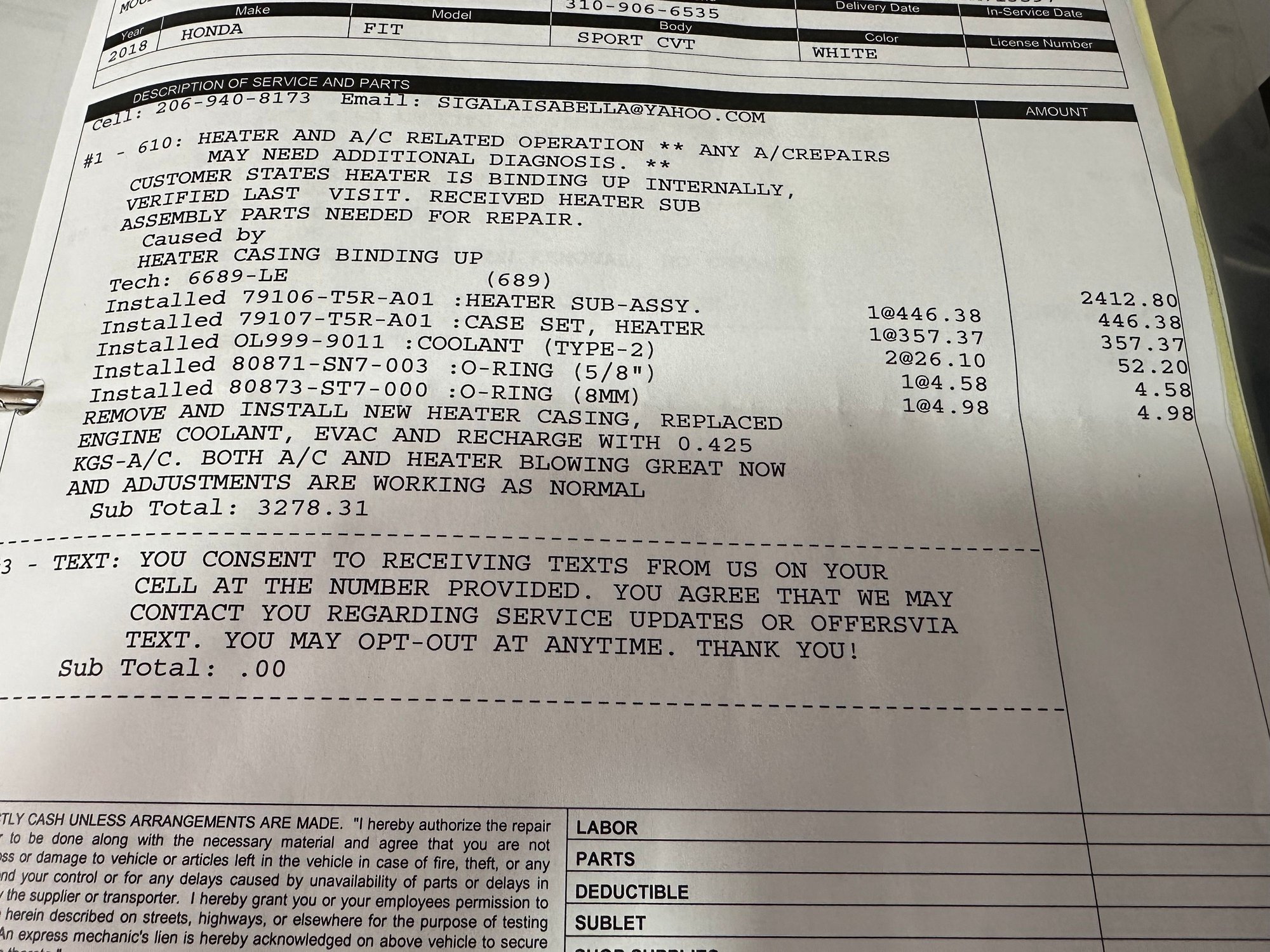

We just had our climate control replace in our 2018 for the same reason. The climate control selector broke inside and was stuck on hot last Summer. Get ready for a $3,500+ fix from Honda. It's not a cheap or easy fix sadly. The whole dash has to come out, and the part was replaced. It works fine now.
$2,400 of it was for labor alone. So you can see that is is no easy job to tackle.
