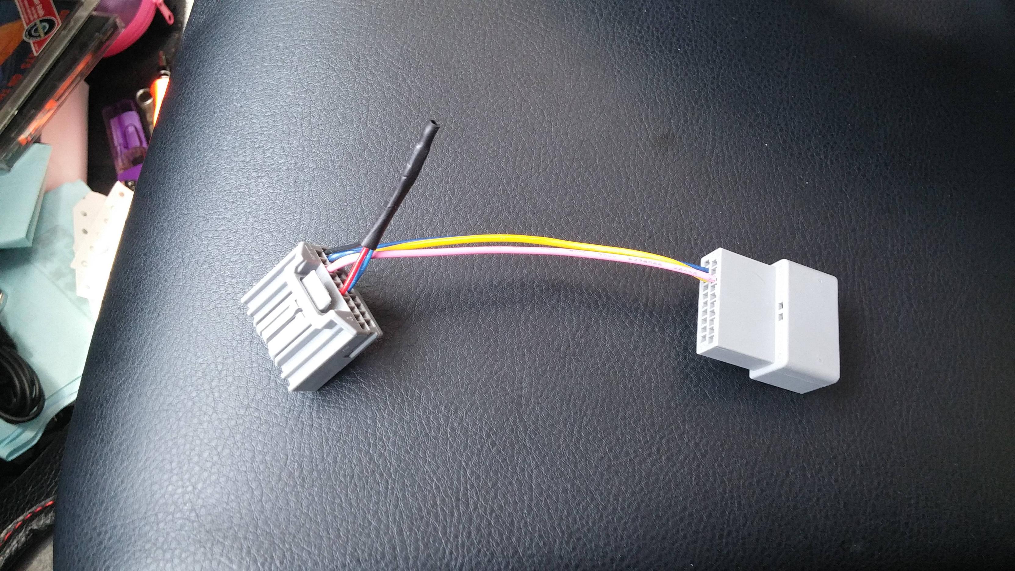

What I've found so far is that with music playing, maps running and bt connected my 1.5A charger in lighter socket isn't able to keep the phone charged so the battery eventually dies, after some 600 km.
Most importantly, phone gets hot. Above conditions were while phone was in the cupholder and ac vent was directed at it.
Photos of the harness and the pinout:

Okay, to reiterate so I understand clearly, can you confirm..
1. I can control phone call volume from the steering wheel but not change source or skip tracks/songs
2. I can start, end, and use voice commands without any issue?
3. USB off the HU is not adequate to keep the battery charged while multitasking various functions of the phone.
I too have noticed that the charge amperage off the HU USB socket is not enough. When i use my mirror MHL adapter with my Note 4 i see that the mirror function constantly drops out as it is unable to power it. It is dropping out because the system is going into overload protection to prevent failure. If I connect the MHL adapters USB A type power cord into an external charger port capable of 2.1 A it does not drop out at all.
One can easily by a Y adapter that has a female USB A type, and two male USB A types. One will go to the HU port for data transfer, and the other for power needs to a dedicated power source. You can even make one yourself if need be. Common issue for higher powered devices. This will prevent your phone battery from dying when mirroring your phone.
Final question, where the hell can I buy this harness, I want to see it work. can you post a video possibly?

1. Tbh haven't tried yet but it should be possible as the bt input is separate and if handsfree works, this should work too. Will test out but sunday probably.
2. I haven't set up any voice commands on the hu as I'm not actively using it at all. Will test out but again, this is hu related and if the phone is connected through bt too it should work independently.
3. Maybe I wasn't clear. I use MHL cable and the usb cable is connected to additional cigarette lighter socket that is rated at 1.5 A. Newer smartphones selfregulate charging so if the phone is getting hot it will decrease amps. Same goes for the charge percentage, higher it is less amps it will take. While 2.1 A is ok as far as potential charger quality goes, I really doubt it will take anithing more than 1.5~1.6 at max charging rate.
I guess actual difference between mirrorlink and hdmi is that hdmi runs on both screens which pushes GPU on the phone harder while on mirrorlink output goes only to hu screen.
I did use screen standby app from playstore to disable the phone screen (root) but the only thing it does is it puts black pic on the screen and minimizes the brightness.
Nevertheless, so far I have extensively tested how it works for me and it has previously mentioned drawbacks, heat and charge rate.
I can probably send you the cable eventualy if we can both be bothered, even free of charge as it is only some 5 bucks here. It is probably better if you can take a pic of the exsiting cable from the same perspective so I can see the pinout. You'd have to take out the hu though.
I can't be bothered with a video now and there's really no need, it just works. I'm having a cvt so both D and handbrake permissives are overridden.

The cameras are separate inputs and while I don't know how the whole thing acrually works (you seem to be quite clear what is happening there) I can say that it works. At least rv camera, we don't have linewatch cameras available in any trim unfortunately. I'd need a picture of the cable socket that plugs in the unit to be clear on the mirror cam part.
This cable works on all hondas here that have the touchscreen unit installed.
