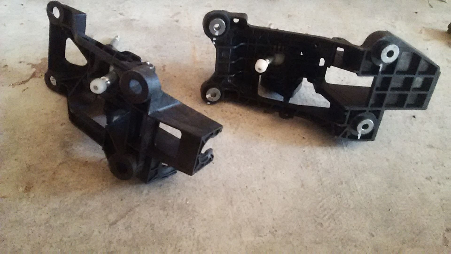

Buddy Club on left, stock on right
So got the Buddy Club short shifter installed this afternoon. What an immediate difference! Gears shifts are much closer and seem to engage with stronger feel. Biggest complaint on this guy is that the fit and finish don't seem to match the price. $160 is fairly steep for injection molded plastic, some springs, and a few clips. Particularly when I had to file down some points to make fitment proper. Overall, I would recommend this. It completely changes the feel of the car. Just seems more eager...

how long have you had the short shifter in? does it make the shifter feel heavier as well? ive been wanting to try and see if GE8 or CRZ shifter bushings would fit
I've had it in since Wednesday eve. It makes it feel much heavier. It's extremely satisfying to use. They make one specifically for the CRZ, which the one for the GK is based on.
