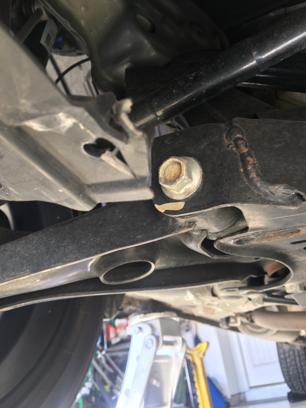

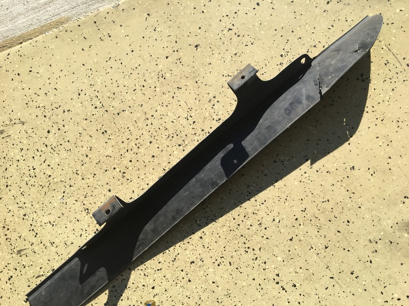

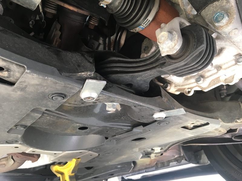

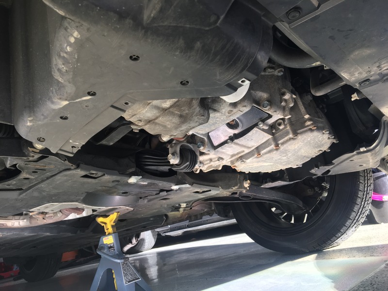

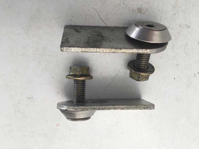

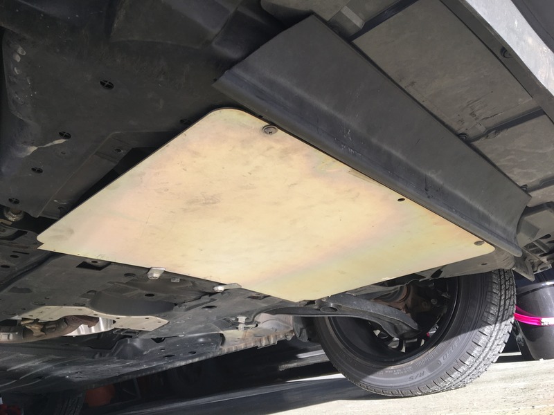

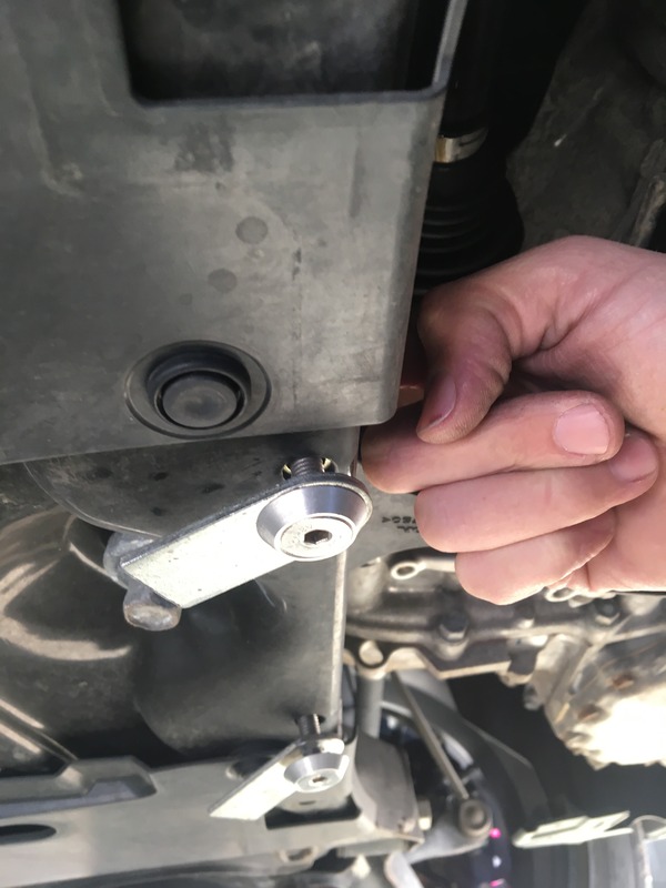

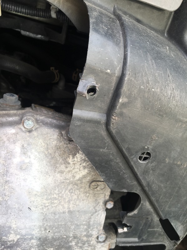

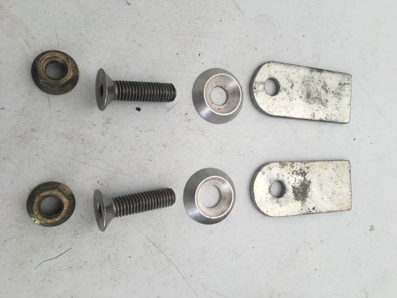

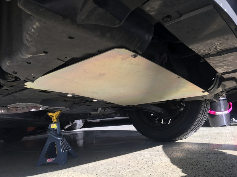

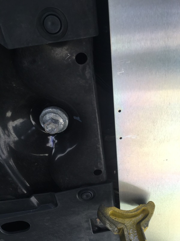

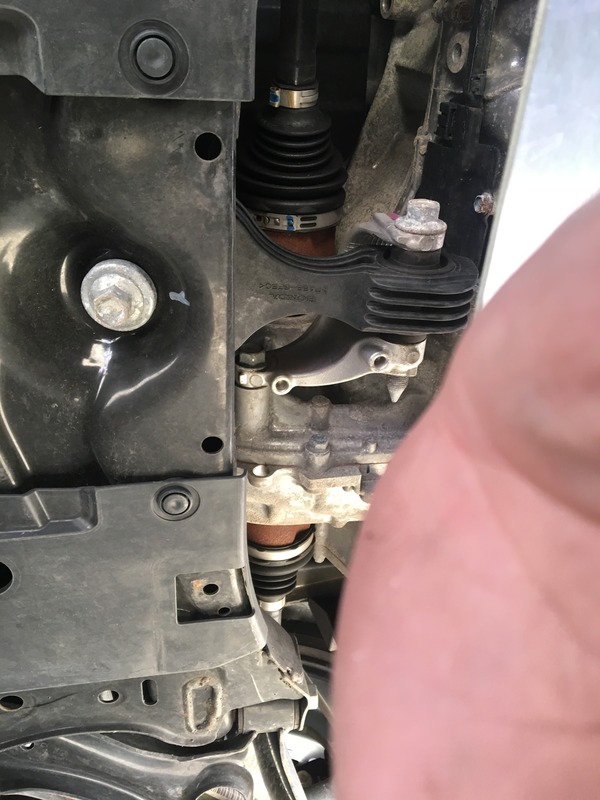

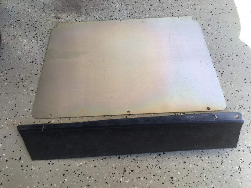

Originally Posted by axlline
So my mileage on the Fit after the first month and a half was 40.9mpg(on 87). I decided to try something. So, the last two tanks, I filled up with premium(92 octane). Mileage jumped to 43.5mpg. Noticed when we bought the Fit the under engine aero cover was missing(had been ripped off). The cheapest I've found the replacement for is $149😮 You can see in the photos where the hardware was ripped away, well I had this piece of aluminum that's about the right size. Today's project, fix the"aero" hole 😜 The front 2 hole in the aluminum panel lined up perfectly, yay no drilling in the heat treated aluminum😝 Wanted it sort of quick to remove but secure, so I made these finger that you wedge the panel in between those an the frame. I used the 2 middle holes as opposed to the original mounting spots because I could easily get to the back of these 2 holes. To remove, just remove the front two screws and pull forward(for oil changes). Had a slight gap at the front, so I took an air dam I had from the wife's old car. Reshaped it to cover the gap. Now to see if there are any mileage gains
Attachment 9910
Attachment 9911
Attachment 9912
Attachment 9913
Attachment 9914
Attachment 9915
Attachment 9916
Attachment 9917
Attachment 9918
Attachment 9919
Attachment 9920
Attachment 9921
Attachment 9922
Attachment 9923
What are the measurements of the sheet you used?

2 questions for ya:
1 = did we conclude, if the under tray/aerodynamics improved mpg?
2 = any write ups, on that kenstyle steering wheel?

1. No I think I just got better at hyper milling.
