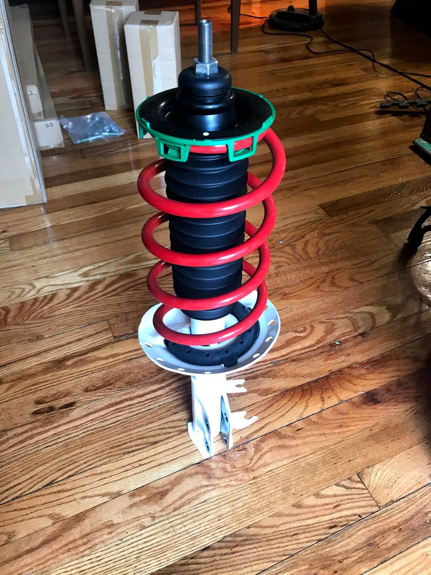

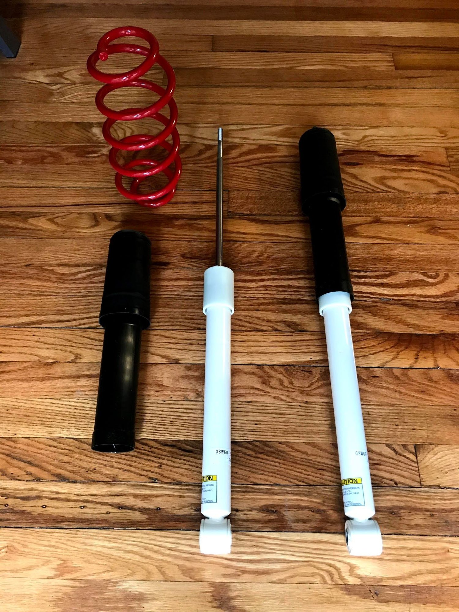

All,
Ive been looking for solid info saying that the MY18 HFP suspension fits onto the MY16 Fits but couldn't find any posts saying this for sure. Lots of "should fit" but nobody that's actually done it. I assumed they were the same as there were no chassis changes that I could tell, and rolled the dice a little and ordered a kit from Majestic Honda.
I ordered the Automatic kit: 08W60-T5A-100
The Manual kit is: 08W60-T5A-100A
I'm assuming a slightly lighter spring at the front?
Either way super easy to install (lots of vids on youtube and threads here) and they fit with no issues at all. Alignment looks good, although even with the slight drop the wheels look even more sunk in at this point. Handling is sharper and more flat as expected.
I would suggest ordering new sway bar end links as well as even after 4 years of winter driving I had to destroy one and cut the other to get them off.
