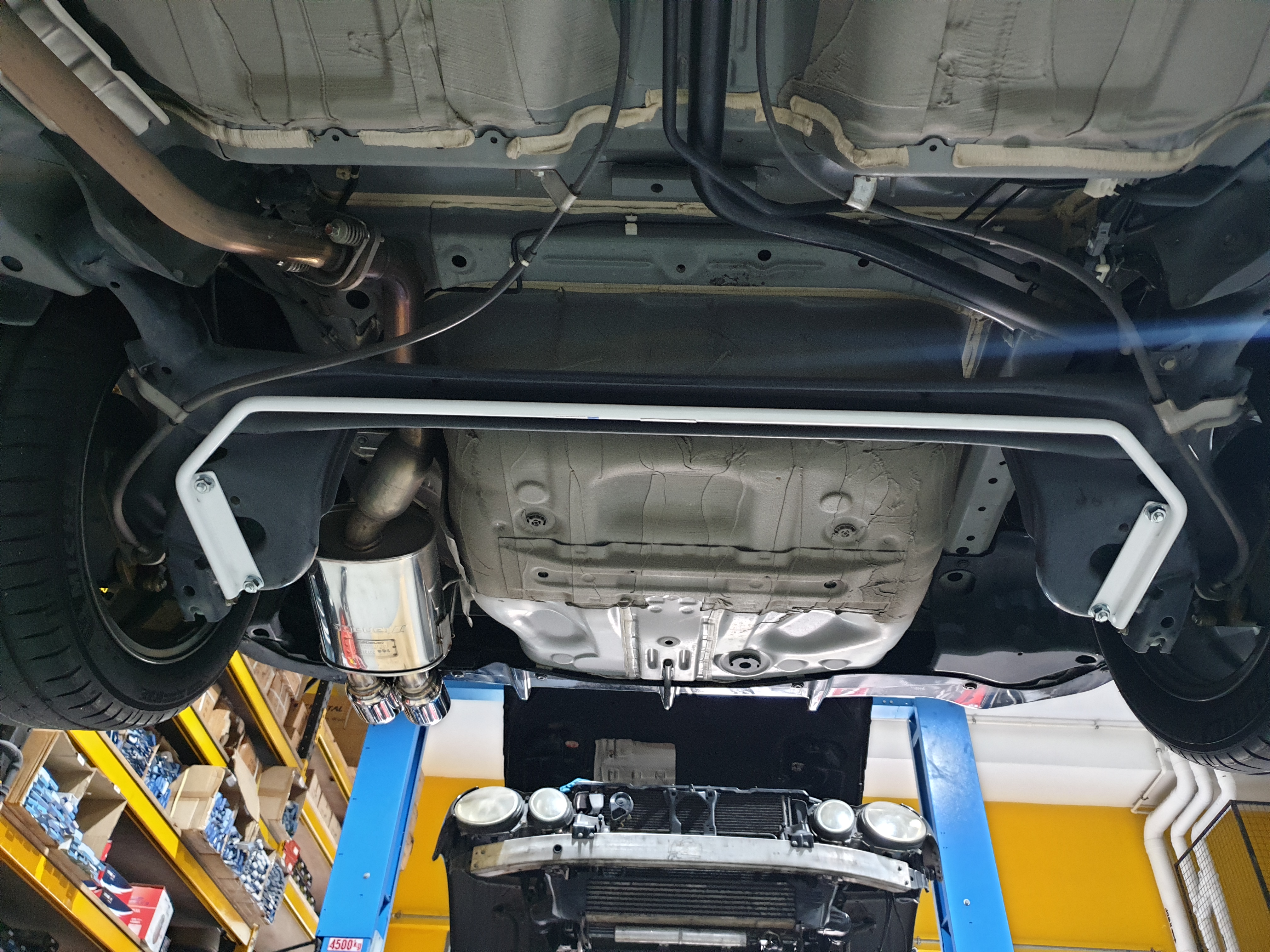

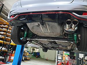

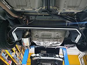

There’s a Canadian website for UR but no GK parts listed . If you do get this part for a 2018+/facelift model can you please post pics and confirm no rubbing?
I can confirm no rubbing for the UR bar
Attached Thumbnails Gen3 owners who have installed rear sway bars-20200811-ur-rear-anti-roll-bar-2-.jpg   Gen3 owners who have installed rear sway bars-20200811-ur-rear-anti-roll-bar-1-.jpg
the progress bar goes beside he axle where as the UR looks like it's under the axle. Makes sense.
Thank you for posting pics!!
