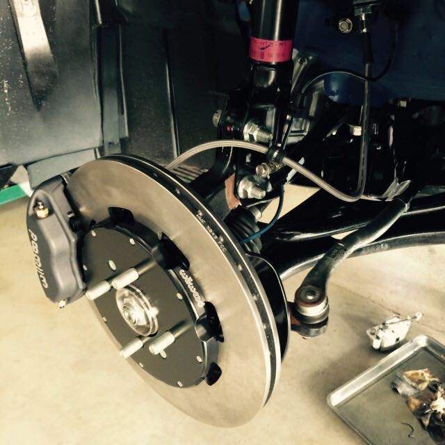

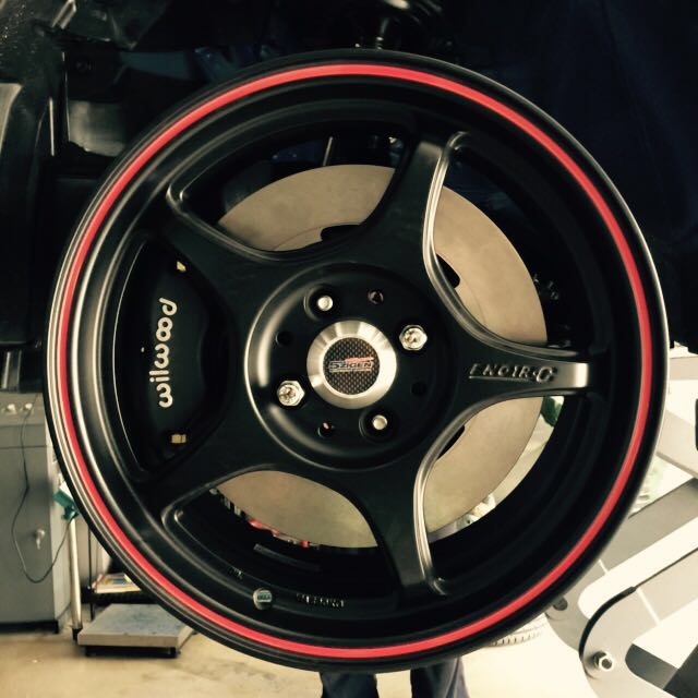

Oh so I can't find my old account, haven't been on this forum for years, so I registered a new one.
Recently spent lot time build our GK5 race car in China, didn't see much post here regarding to the Wilwood honda kit that fits the 2nd gen, thought I should share some experiences.
The Wilwood kit for 2nd gen will directly bolt on the 3rd gen GK5, brake lines are same, basically all 2nd gen brake kit should bolt on to 3rd gen without any issue.
Kits will fit:
Wilwood Disc Brakes - Search Wilwood Brake Kits
DP: If you are running 15 inch wheels, you can probably use the 140-12996 kit only. Although Wilwood claimed their 12.19" kit requires minimum 15" wheels, I'v tested tons of 15" wheels, nearly nothing can clear. So I would call 16" is minimum requirement for 12.19" kit.
Hope this could help
Some pictures of testing work, 1st picture is 140-12996 kit, 2nd and 3rd are 140-6163 kit, with 16" 5Zigen, last pictures was taken my first race with our GK5 early this year.
Attached Thumbnails Wilwood kit on GK5-pic_20150814_173604_144.jpg   Wilwood kit on GK5-pic_20150824_164355_ab0.jpg   Wilwood kit on GK5-pic_20150824_164359_55f.jpg   Wilwood kit on GK5-pic_20151007_000059_d55.jpg

GK5 has pretty good factory brake, I don't feel much brake power different over the Wilwood with factory size rotor, I changed it because I'd like to use Wilwood H-Compound race pads. The 12.19 kit has noticeable different, but can't fit 15" wheels.
