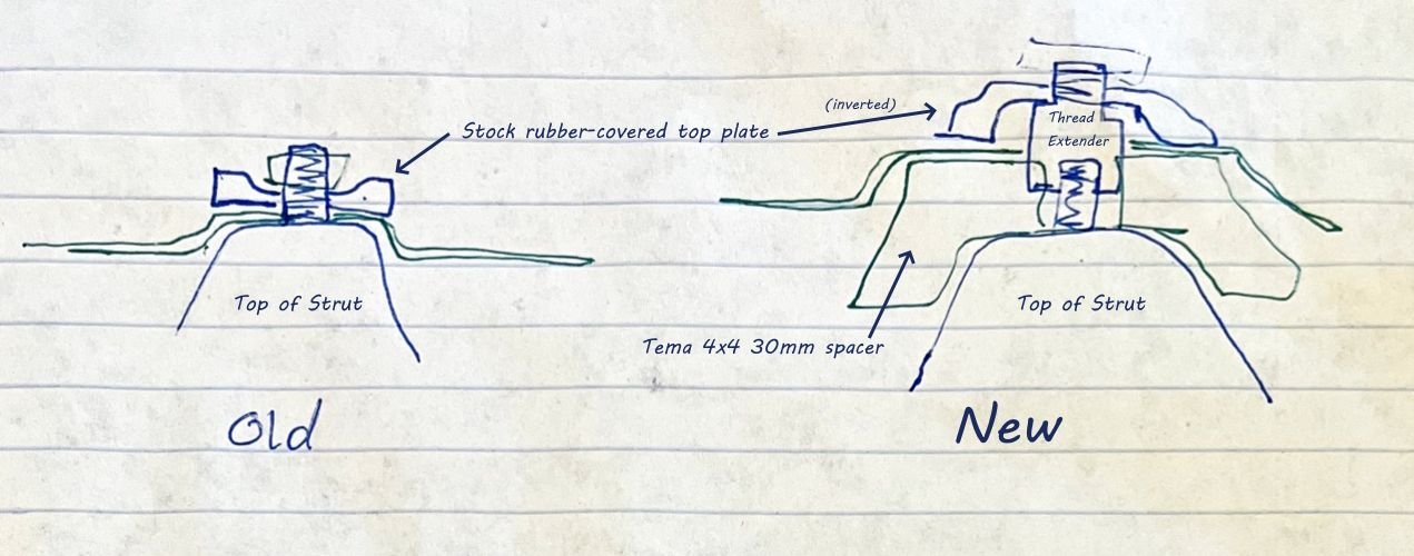

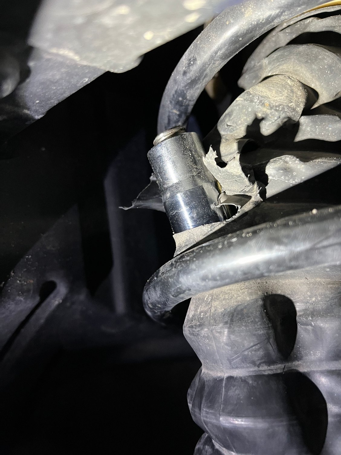

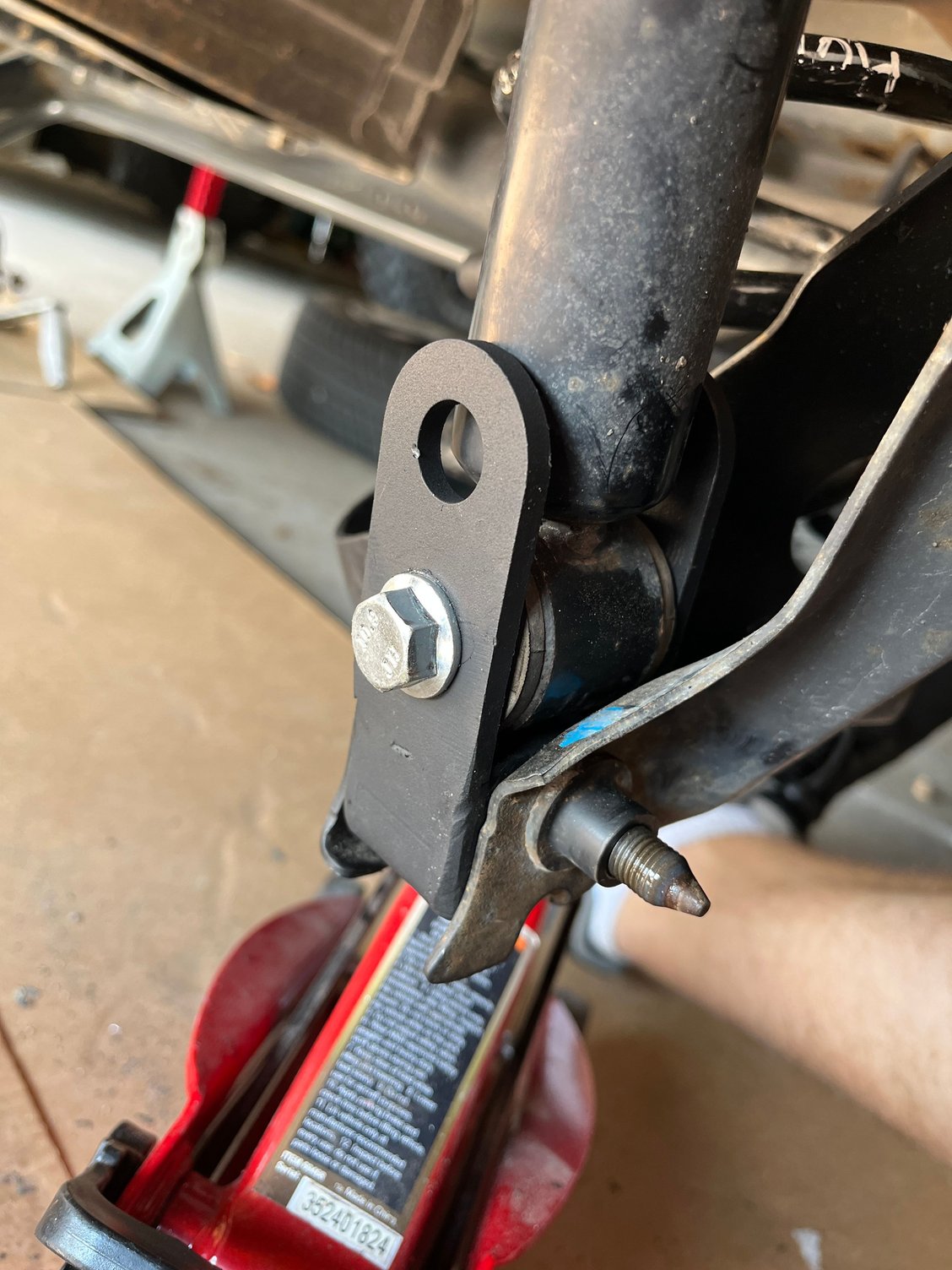

Last winter I lifted the front and rear of my 2012 Fit, and I've been meaning to post about it here.
In the rear, I did the progress rear sway bar and 2010 Insight springs. I wasn't sure if the stock Honda dampers had enough travel, so I modified some truck shock extenders from Amazon that were called "1-3" Front Shock/Suspension Extension Leveling Lift Kit Compatible with Chevy Chevrolet Avalanche/Silverado 1500 Tahoe Fit GMC Sierra 1500 Yukon & Cadillac Escalade". That has worked fine, but maybe it wasn't necessary.
In the front, I used the 30mm Tema 4x4 spacers above the struts. I did not have to disassemble the strut, but, when tightening everything back up, when I installed the stock rubber-covered top plate, I wasn't able to get it to clamp tightly (as I learned later). The top nut tightned onto the included strut-top-thread-extenders clamped the top plate to the strut-top-thread-extender only, because it ran out of threads and bottomed out before drawing the strut with the Tema 4x4 tight and upwards into its mounting position. Thus, everything felt tight, but when hitting bumps, there was some side-to-side movement of the strut top spacer (and strut), making a sound I wasn't able to reproduce when stationary, even with a pry bar. This only was a problem on the front right (passenger) side. About six months later, the top threads of the strut snapped, maybe when I went over a speed bump or made a tight turn in the driveway.
I replaced both struts, but to solve the clamping problem, I removed the rubber from the rubber-covered top plate, flipped the plate over, and put the rubber back on it. Then, I was able to install the strut with the spacer, with the top plate clamping the strut, strut top spacer, and car strut mount as one big sandwich, before the threads bottomed out on the top nut. I did this on both the left and right sides, and then got an alignment. I've been driving fine since then with no problems.
I've attached some pictures and a diagram showing what I did. Hope it helps!
