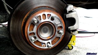

Alright, so my 10mm spacers came in the mail today. The quality looks good on them, so on they went. It took about an hour to complete, including pressing out the old studs and pressing in the new longer ones with a ball joint press (he scissors kind, not the C clamp style). I ran into no problems. One thing though: It did take a bit of manipulation to get the longer studs in. I think if they were any longer, like for 15mm spacers, I might have had to disassemble the hubs. I am very glad the 10mm longer than stock studs went in without a hitch.
Here's the pics you asked for. The studs are pressed in and I re-installed the drum. That's anti-seize that I haven't cleaned up yet:
First I slid on the spacer:
Then I slipped in the hubcentric adapter. This positions the spacer perfectly centered to prevent vibration:
Next is the hubcentric adapter that fits the 73mm center bore of the aftermarket wheel to the 56.1mm hub on the car. I am test fitting it here but I put it in the wheel, then put the wheel on the car, not like you see here:
Remount the wheels and take it for a test ride. You can see the spacer in there:
I'm really happy with this set-up. No rubbing whatsoever and I hit a few G'd out dips in the road in my area to test it out. U-turns without rubbing.No vibration @ 80mph. I have 185/55/16 (OEM) tires with 16X7 (+42), w/ 10mm spacers rear only (effectively making them +32mm spaced rear wheels). Fender to tire ratio looks much better now. I'm done messing with wheels for a while. On to some new suspension changes. Dang this is fun...
