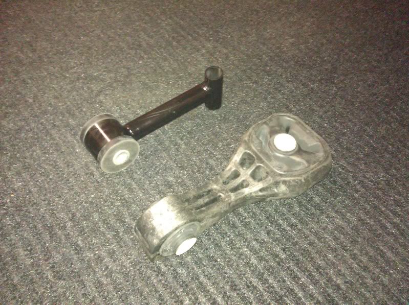

Hey guys just went tonight and had a local shop fab up and install a solid motor mount for the rear. The motor mounts on the sides are great as they are but I felt like we needed a little more rigidity out of the fit! below is a stock motor mount and the new one
new one side by side with the stock one
Big difference! Now this is the prototype of the mount and the shop is willing to put this into production after some more testing and my review.

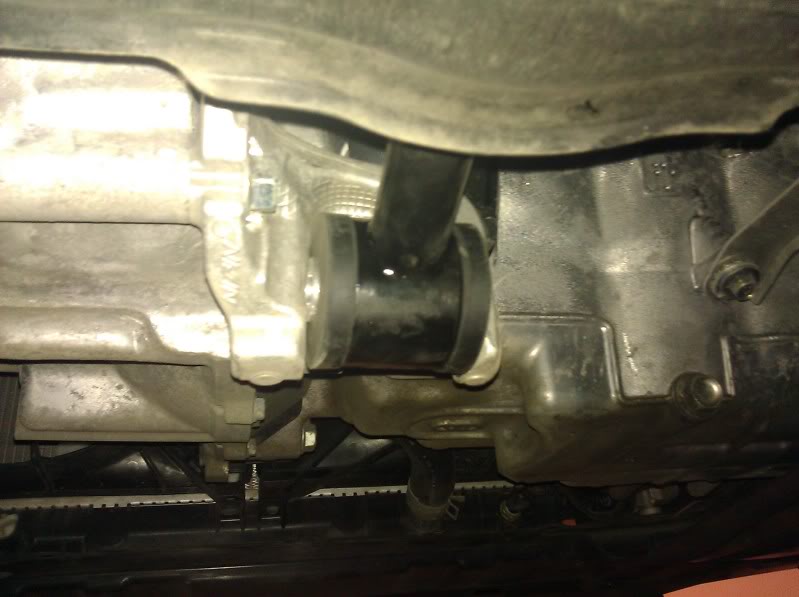

i will say first off that i love this, absolutely love the shift response, no wheel hop, and no more sloppy downshifts. very stiff and that's the way i like it. makes driving more enjoyable, now there is alot more vibration. Remember when removing all the rubber and making it solid the motor doesn't have anywhere to move front to back. The stock motor mount is ment for comfort this is ment for feeling the road and reducing wheel hop. Noise in cabin does increase a little but I have no resonator so mine is an extreme case. When slamming through the gears the car doesn't lurch anymore, no dip on the front in between gears. Wheels feel more planted and stable. super easy install, maybe 30 minutes at the most, fitment is perfect and uses all stock parts aside from stock mount. I drive about 70 miles a day to and from work so I will have more info tmw, just my initial thoughts... Love it!
any questions let me know and if your interested leave a comment below and maybe we can get a group buy going
installed

Question though, the new one seems... skinny compared the original. It just doesnt look like it would be that strong. Just an immediate observation by someone who really doesnt know lol. Feel free to educate me

the stock one is made out of plastic so anything is better, and im going back to the shop on tuesday to install my coils so we should have a few more made and i think were going to try another design too. i will talk to him about making some more and im thinking were going to do a gb soon so if anyone really wants one let me know post up in the thread. i need a local with a gd to get on this too, i will call the dealership and see if the part numbers are the same then we can make one for the gd too

not to be negative, cause i love the concept, but i give it two months and you're re-welding it, it goesnt look like it can hold the stress it will endure on the solid side.
i'm interested if it can hold up for a few months, i'll eat a crow sandwitch, i do want to know what kinda driving you are doing/planning, as i plan on tracking my 2010 a lot this summer, on a real track with pretty high speeds and rumble strips - i have a MT too and will be watching this thread

^i think he said stock is plastic, should be fine?? not much tq anyways
