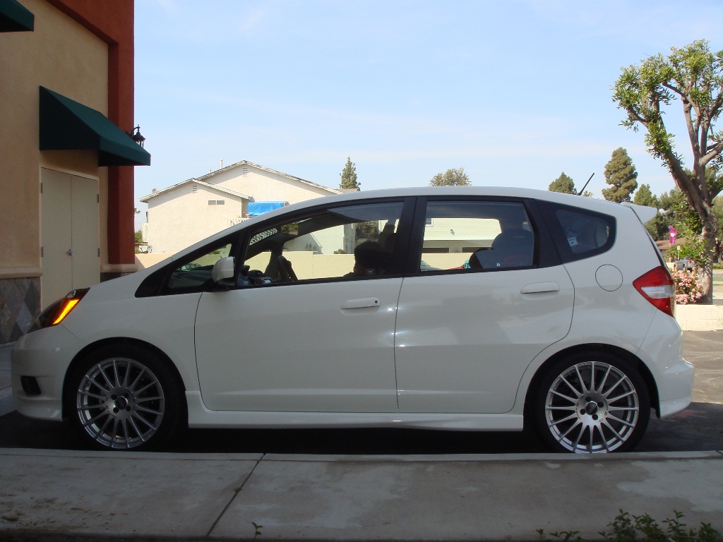

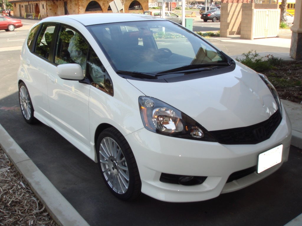

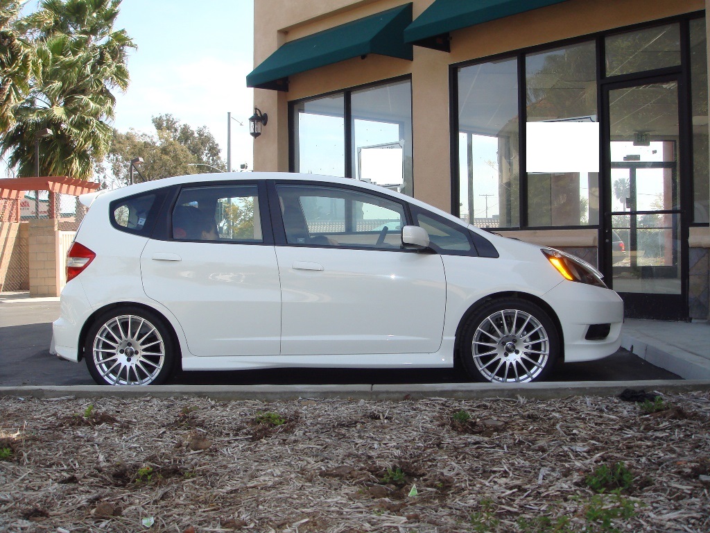

My 18in OZ Racing Superturismo GT + 225/40ZR18 Michelin Pilot Super Sport
TireRack never import this wheel in the spec that I want,
They had to special ordered it from Italy.
and the wheel will be shipped together with their regular order shipping container.
So after waiting for almost 2 months, My Wheel finally arrive today.
My wheel is OZ Racing SUPERTURISMO GT.
Color : Race Silver
Size : 18in x 7in
Offset : et42
The Tire is Michelin Pilot Super Sport, size: 225/40ZR18
I had NOT lowered my car yet,
with this configuration,
The Front Wheel do NOT rub at all,
but
The REAR Wheel do rub on large dip and bump with 4 people on the car.
if I am driving alone it do not rub at all.
I plan to roll my fender soon.
Will surely lower the car with Coil Over once I can decide which one to choose
between Bilstein, Koni (the one offered in this forum), or AMR Engineering.
Actually my favorite is the JDM Ohlins coil over, but they cost too much (after shipping cost).
When I lowered my car, I will surely install the SPC Camber bolt too.
Ok here are the pictures:

13. Overall View:Name:  DSC06094_zpsbf80f9de.jpg

I bet I front lip would really set that look off

Man those wheels look sharp and really give the Fit a Euro look.
I doubt I would even lower it and if so it would be mild like Swifts.
Thats just me though I do not like the slammed look.

Totally agree with you, I am NOT going to slammed it,
but
I will lower it with coil over for about 1inch maximum.
I need to do this because my wheel and tire combo is about 1inch larger in TOTAL diameter compare to stock wheel and tire
and that mean the car now is about 0.5in Taller (1inch divide by 2 = 0.5inch radius)
so the current center of gravity is even higher than stock,
that is why I need to lower it for about 1inch so the car will handle better then stock and look good while not giving me problem with scraping my bumper.
but first I need to ROLL my Fender before I can lower the car, hopefully tomorrow, ...

It's always the rears that are tough on the Fit, GD or GE
NICE choice on tires! I've always been a fan of the multi-spoke OZ wheels.
Rolling will be a good start, but if the GE rear is anything like the GD, you should also consider having the bumper mounting tab shaved/relocated. That's where things tend to rub most, even after a solid fender Roll.
+1 for Mugen front, cost concerns aside, it really looks the best.
As far as Swift's vs Coils, how soon do you want to be low? If its BEFORE NOW, you will not regret the Swifts, and if you shop about or look used $250 should get you setup. They hold value OK and can be re-sold when you decide on coils.
When you do that alignment with the camber bolts, I recommend throwing them in the lower hole and going at least -1.5 camber. MORE importantly have the front toe set to zero. Saves you some tire wear and sharpens up that turn in
ALL the coil options you have listed are solid (no joke on the Ohlin$), BUT honestly, I vote you wait for the Redshift Koni's. Chris has been great with updates and info, and the flexibility of ANY spring rate, with the easily rebuilt or replaced Koni strut inserts = easy repair/maintenance/any future upgrades.

It's look like for my GE, the place where it rub at the rear fender is the metal part of the fender, specifically the center part of the fender lips.
but of course if I lowered it, maybe it will rub the bumper mounting tab as you said, ... will found out after I lower it
I prefer to get coil over right away, that way I don't have to install/uninstall and do alignment 2 times, so for now I just have to drive slower (although our car can not go fast anyway hahaha)...
I do have question regarding the Camber bolt,
if I use 2 camber bolt per side, what is the maximum negative camber I could get?
cause I heard if you only using 1 bolt, you can only get around minus 1.25 only... is this true?
and which camber bolt is better, SPC or Eibach?
