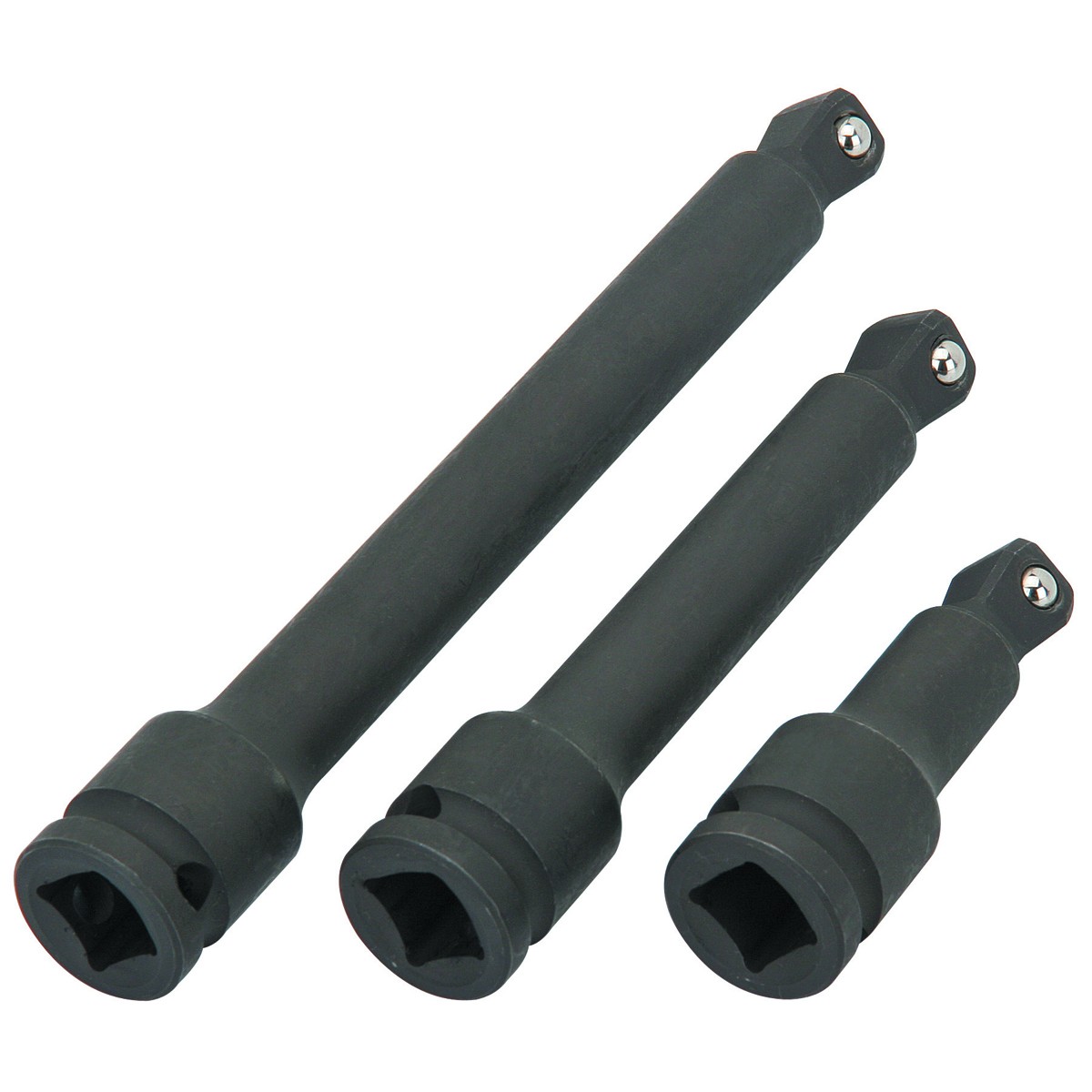

If your concern is that bottom pivot bolt, yeah you need wobble extensions for your ratchet to put any torque on it. Straight sets won't work.
You can get either impact type or regular.
3 Piece 1/2" Drive Impact Wobble Socket Extension Set
These are some of the most-used tools in my toolbox.
Awesome. Thanks!
A friend of mine provided a diagram showing how to get at the lower bolt (I didn't realize that it went in the other direction from the upper bolt). Looks like I'll just need to shell out a few bucks for some of those, and I'll be good to go!

I managed to get the "new" alternator installed last Friday. I was a little scared that I'd damage an AC line, but I was able to squeeze the alternators by it without too much trouble. I didn't even need the wobble extensions! Though they did make it easier to remove the bolts once they started to back out, so I'm really glad I got them.
