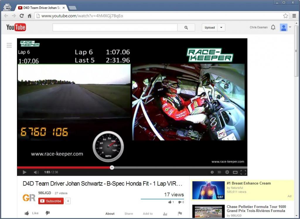

That is a Fit, accelerating steadily uphill to 106mph @ 6760rpm at the gear change.
Thanks for playing.
Just in case you missed it the first time:
6760 rpm at 106 mph; thats a very seriously prepared B spec. I suspect way more than 119 hp and much shorter final gear ratio. Its not that the Fit cannot go faster, the dis here was its how fast stock. All Hondas can be 'coaxed' to more speds and hp. I had a CRX that dynoed 176 hp starting with 116 hp stock. Many others had more. as for the lap tuime of 1:07.06 that wasn't at VIR competition course, even the north course. It does appear to be the 'hump' approaching the back strauight corner stand but hard to tell from the photo but there's a tree missing. In that section its downhill from Oak Tree then uphill to the corner station. Maybe if the lap was just the south section a lap of 1:07 is feasible but thats one Ive never run. I think motorcycles run that fairly often.
In any case presenting that as 'proof' a stock Fit will exceed 110 mph is not quite honest.
Engineers know horsepower is derived from torque, now take a good long look at the BS you dropped in here and then go watch that video you told me to check out.
Thanks for playing.
Thanks for playing.

105-106 at the top of fourth sounds exactly right from my experience and that screenshot agrees. This is in a GE and that is a GE in the screenshot as far as I can tell. IDK about GD, i've never driven one.
The car doesn't fall on it's face on the 4-5 upshift. C'mon man.

you really think your engine will turn 6760 rpm in 4th? at 106 mph? Perhaps you should remember redline is 6500.
Thats not any OEM Fit but one seriously and soundly modified. I'm wondering if I remember B spec rules that shot would be a legal car.
Any race tabs on it?
