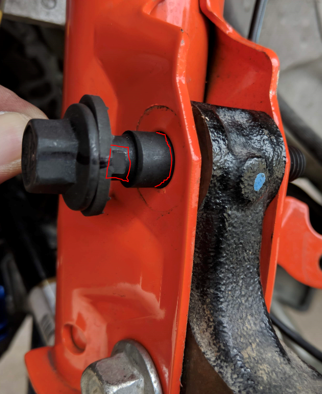

in the case of koni (which I believe you run koni oranges), the bottom hole is elongated/oval ish shaped, and the top hole is round. I was not able to get the washer/tab in the top hole, for the life of me:
the general knowledge of "THE TOP HOLE IS THE CORRECT HOLE" to shove camber bolts into, in this case, is wrong. the bottom hole will get you much more adjustability. buy an el-cheap-o bubble camber gauge, and test it for yourself, something like this thing:
OKAY, back on topic. I have no doubt you're doing anything wrong, but just to confirm.... you're bolt and washer orientation is like THIS..... correct?
double check to see what the manual calls for, but this example "should" be the right way.

if you dont own one.... buy a camber gauge. the cheap bubble one is like $15 on amazon and with the magic of prime, you can get it in a day or 2
for me, I was able to get much more neg camber, with the oem bolt on top, and the camber bolt in the bottom. my method:
-loosen the top (oem) bolt
-insert camber bolt into lower hole, and make sure your tab/washer is oriented correctly (see my pic above, or the manual)
-tighten the camber bolt's nut down, snug (dont over snug)
-on the bolt side, use an open ended wrench and spin it slowly .... watch your car gain camber. at some point.... spinning it will feel like "nothing" is happening.... and if you continue to turn, you'll notice the camber starts going in the opposite direction, this is your "max" .... back off a bit until you get your neg camber where you want it
-grab the top of the brake rotor, and TIP it inward, is there play? can you manually force inward more neg camber? if yes .... GREAT! using a 2nd jack (and if possible a JACK PAD so you dont damage the ball joint), go under your hub and use it to raise up, and aid in your "tilt" efforts. and just like that, more camber!
-once u get it where you want it, tighten down the oem bolt's nut side (helps to have a friend hold/tip inward)
-measure camber, if things are good for ya.... you're done. -2 is probably where you'll end up using the inward TIP
-if you need MORE neg camber.... remove top oem bolt, and insert another camber bolt in its place (no washer/tab) and repeat the above steps. this time around, you should be able to dial in a little extra camber (-3 max is my prediction for ya)
GL D'Art, you got this!
