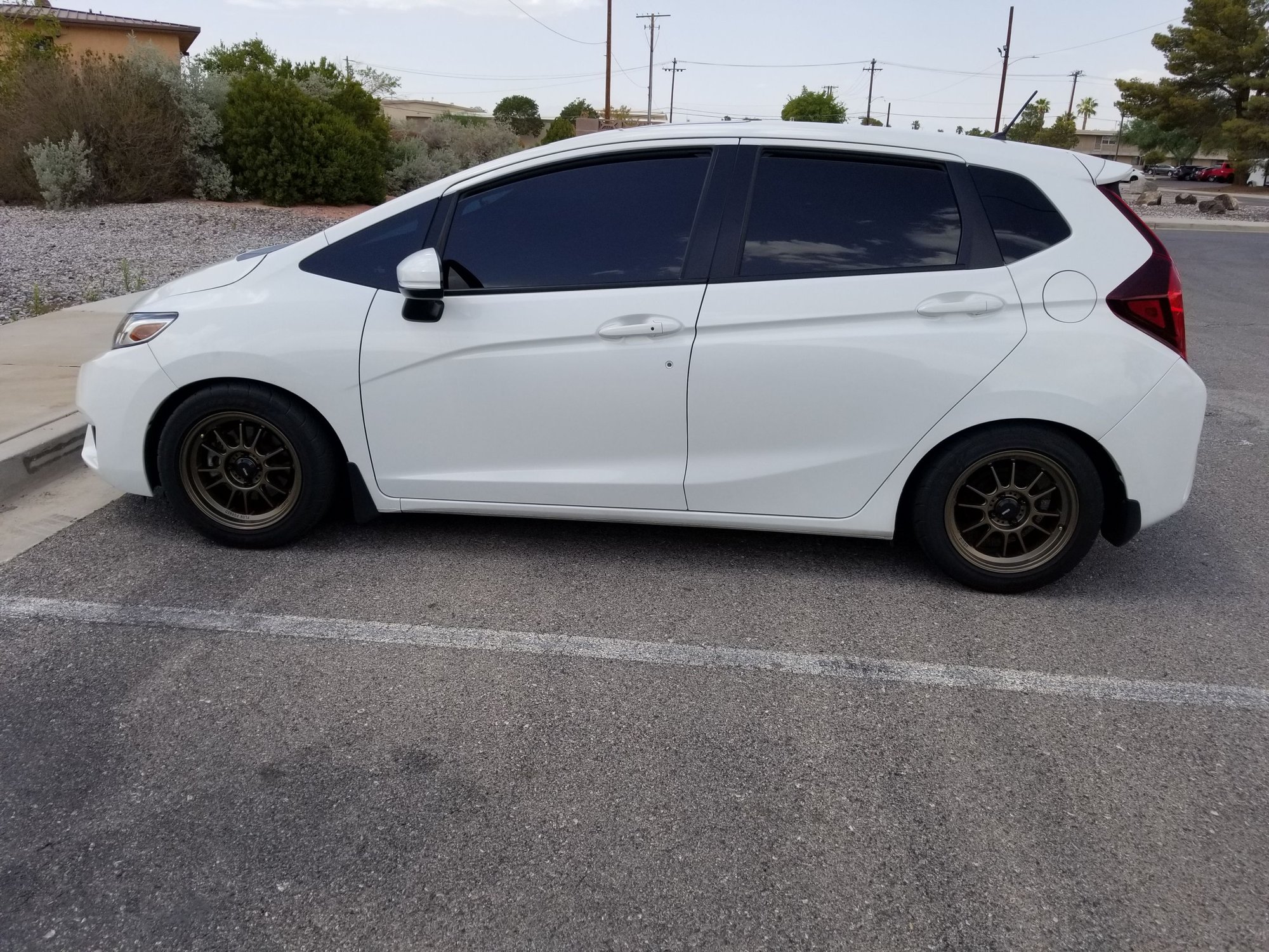

OK, so quick update, I have owned my Fit for 4 years this month. It went from my daily driver to my HPDE car. I have a fully built L15B1 motor, and was going for the N/A world record. Unfortunately, I switched goals and am fully pushing to Global Time Attack. At this point, I am preparing to boost the engine, finish the roll cage, install all safety equipment, upgrade brakes, suspension, tires, and build carbon fiber aero. Then shakedown runs and tune. I have a Link ECU which supports direct injection and boost. I have a few folks who are helping me build the car, namely Hotboii Factory in San Antonio owned by Josh Brown. I am hoping to be in a Grid Life event in August so we will see.
Goal is 505 Crank Horsepower @ 2,000 lbs, same as my Z06, just half a ton lighter!
Mods so far:
ENGINE:
1.6L L15B1 block built and assembled by Golden Eagle. Align bore honed, sleeved, custom Traum 12.5:1 pistons, Maxpeeding rods, ARP hardware throughout
