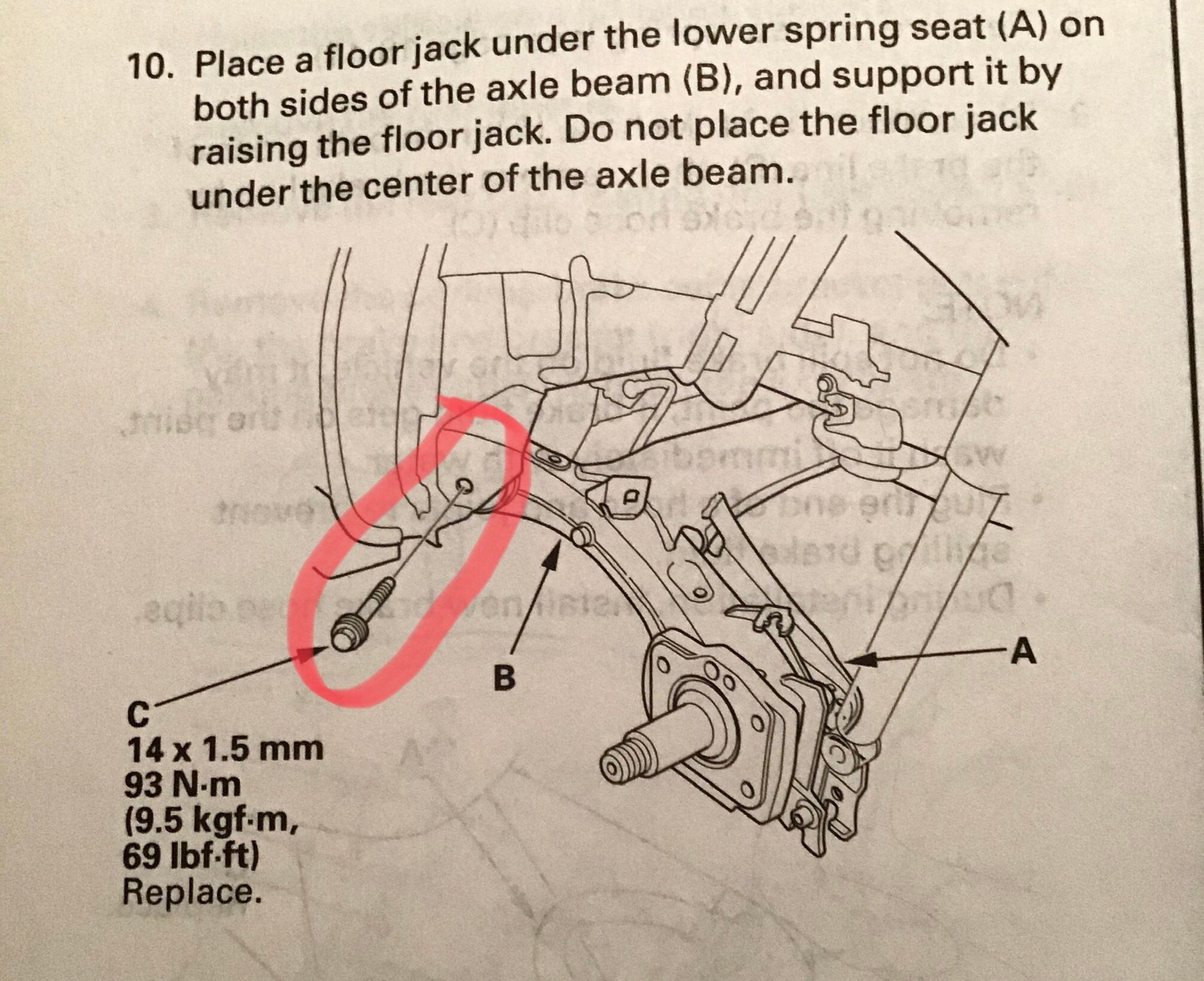

Hi,
Changed the rear trailing arm bushes on my 2009 Fit but I cant align that 19mm bolt to the threaded hole. and tricks or pics of where to jack or support ? been trying for a couple of hours without succes
Pat

Did you get it to work?

Where did you find replacement bushings? The only option I'm finding is to replace the entire rear axle assembly.
