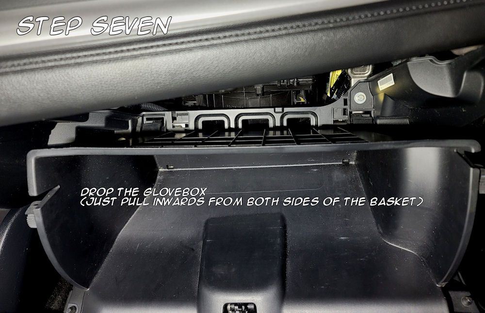

7) You cannot see the third bolt until you do this step. Drop the passenger console (pull inwards on each side, and it'll drop).
