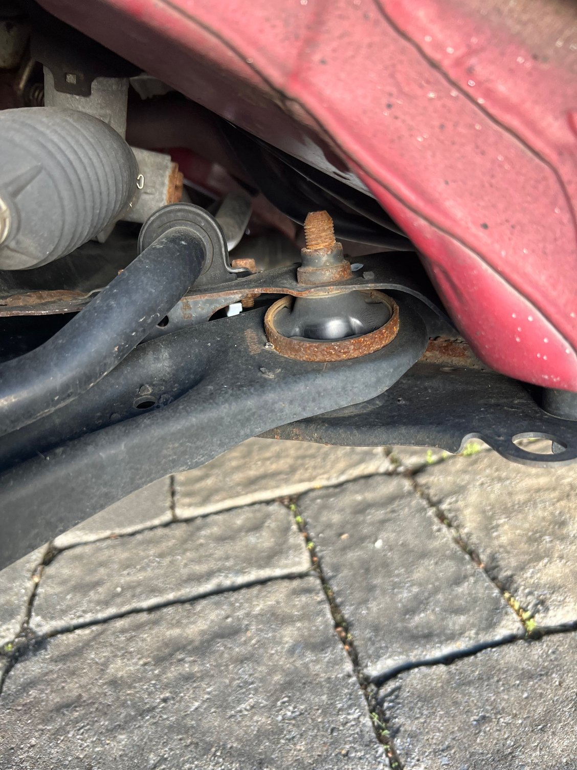

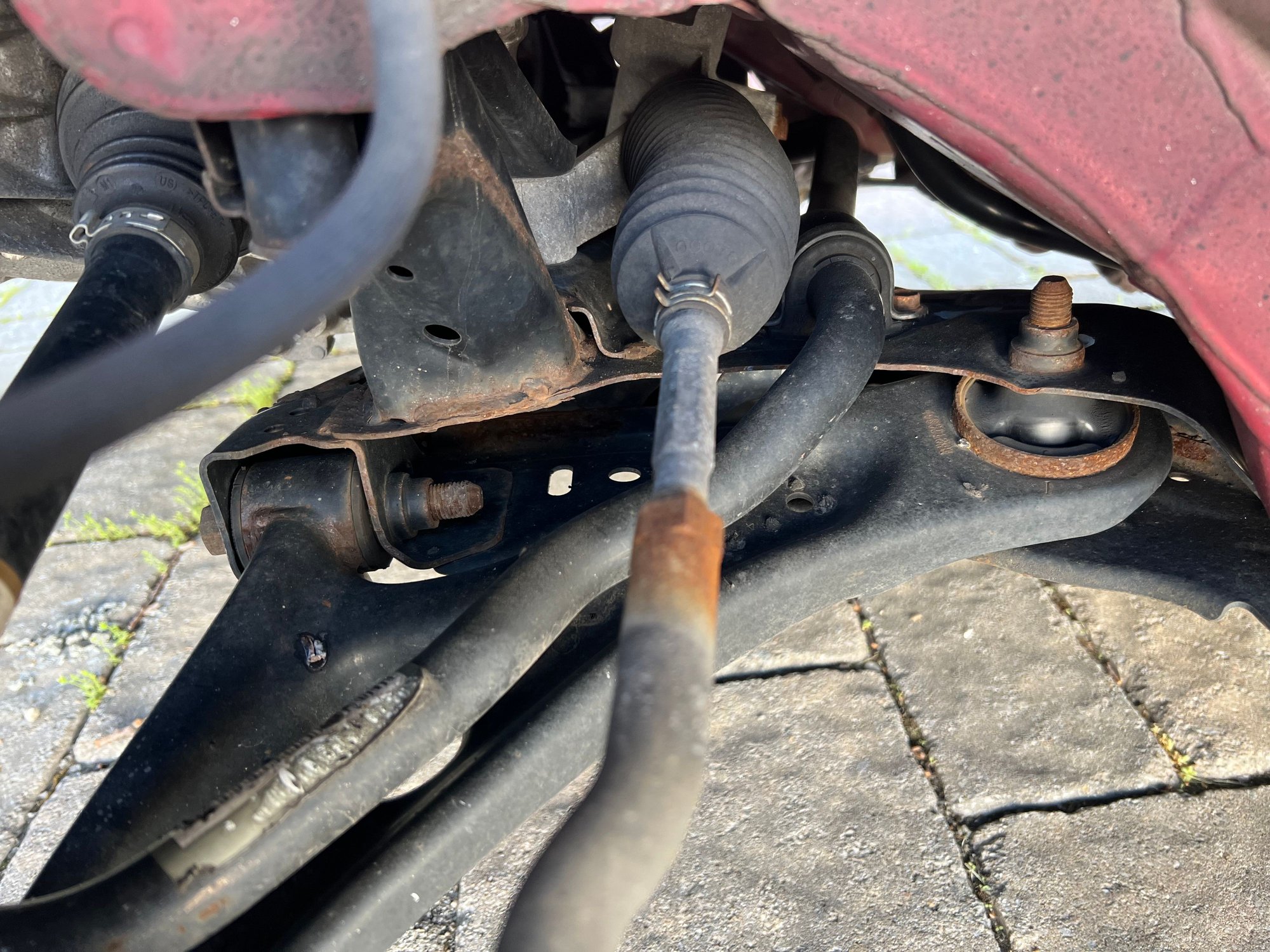

Hello all,
So for the past year I’ve been chasing a back and forth judder while braking. Replaced all brakes, got an alignment and have new tires/balanced (were needed)
Between reading and what not, I was advised to replace the front lower control arms. However, while testing with the wheels off, there is no play, bushings also look fine.
Im kinda lost, but just realized the parking brake is engaging on one side only, could this be the issue? The car is a 2015 lx btw. It’s been a peach other than this issue of late.
Thanks in advance
