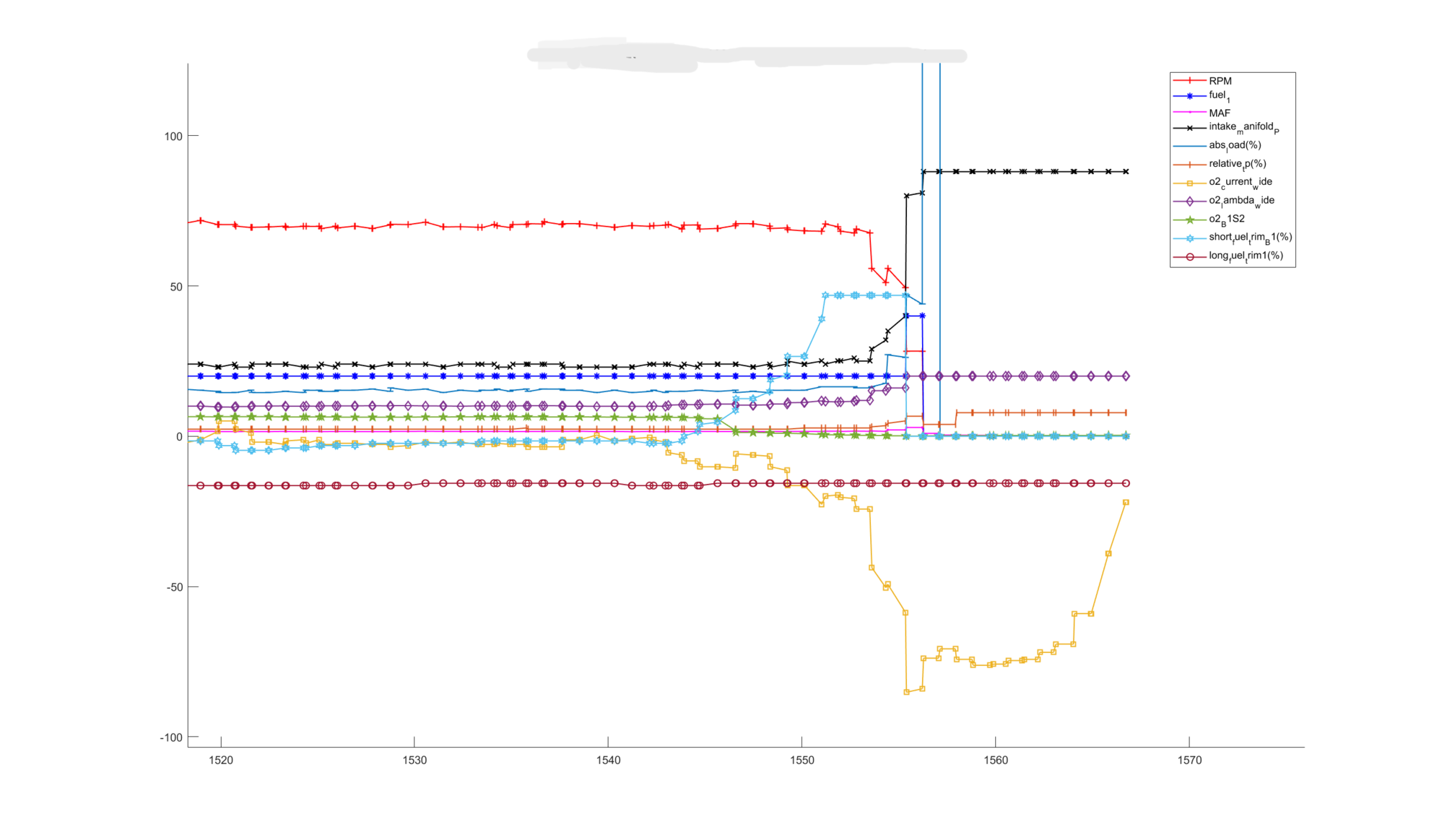

I came to know a tool of OBD scanner which can tell me some parameters.
So, I ordered an OBDLink for $107CAD from which I can receive data on a laptop and view real-time graphics.
That began my days recording data.
I drove around frequently carrying this device, trying to catch the moment when the issue happens.
I did get the moments several times.
By analyzing the data, I still could not tell what was wrong. Everything looks fine to me.
This fit does not have fuel pressure data very unfortunately.
I compared the data with that from a Toyota. I found that the O2 sensor had a different response (opposite).

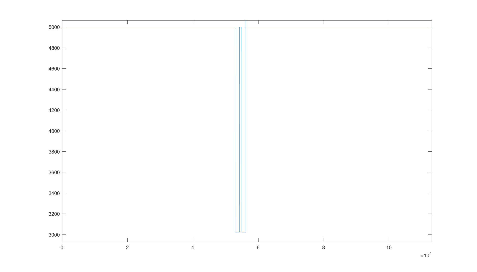

One day, I got an idea that I could check the power supply to fuel pump. I believe if the power was there, the fuel pump would be working.
Of course, measuring the voltage using a multimeter gave me normal reading.
But I know that could not tell the whole story because I could not keep monitoring the voltage by my eyes while driving, and the issue is so random and a short process.
I thought I could record the voltage signal using an analog-to-digital device and data logger.
Luckly, I have these devices.
I used a usb data acquisition (DAQ) device, making some wires connecting to fuel pump plugs, making software keeping receiving data from DAQ and save on the laptop.
I started driving out of the city carrying this system.
Not even out of the city, the issue happened while I was climbing uphill!
So, I turned around, drove back home, and looked at the data.
And I saw what happened: the power supply voltage dropped from 12V (should be but the DAQ range is +/- 5V) to 3V for about 1 second, back to 12V for less 1s, then dropped to 3V for 1s, then normal again.
At this time, I can confirm that the problem was caused because the power supply to fuel pump was cut off!
What will make the fuel pump power cutoff?
I did some search and came to a name called camshaft sensor, whose signal would affect fuel supply.
But replacing it might not be easy and I was unwilling to start.
I kept searching and came to names of fuses and relays.
The more I figured out the function of relay, the more I believed that was where the problem was.
So, I ordered 5 for $20CAD.
But they would come two days later, I could not wait and replaced the fuel pump relay with the one controlling rear window defogging.
I drove the car out of the city for several hours on the road I usually test driving.
The problem was GONE!
Finally, a several-bucks problem bothering me for a year was solved!
And I learned so much during the process: the deal, the dealer, and the car repairing.
The process is actually much longer than the description here, like the first time I tried to open and replace the fuel pump...
Stall while idling (some parameters are scaled for better viewing).
Fuel pump power voltage (+5V is the maximal range of the DAQ device).
