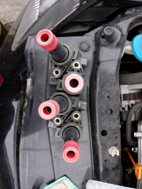

2) Just replaced all of the coils, car runs like new. It Friggin' Purrs. Didn't realize how rough it was running until today.
3) For my 2007 base Fit, the plugs and coils are in the rear of the engine. Makes for a tight fit doing the replacement, but I'm no mechanic and I managed it in about 1/2 hour.

My coilpacks looked exactly like the old ones (red tip), though it seemed to me like there was NO dielectric grease in the original factory installation.
