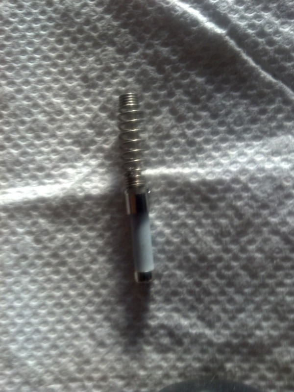

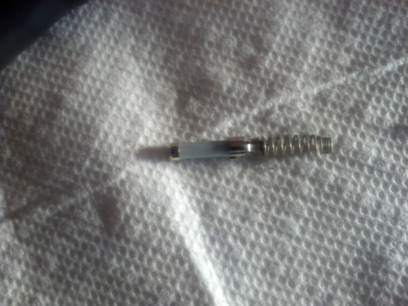

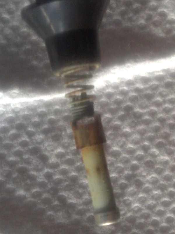

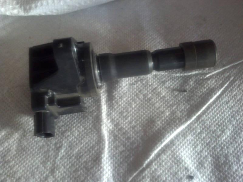

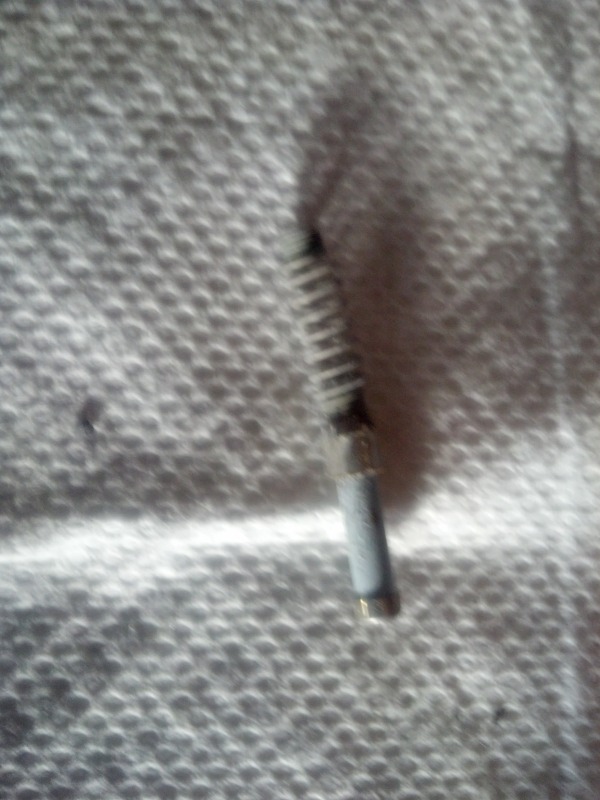

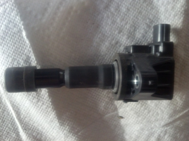

so this afternoon i pulled and inspected the coil packs and found some interesting things.
original installed coil packs seem to all have the pink boots at the spark plug end and the new oem replacements are all black. i have 2 packs with pink boots and 2 with black, i have only had one pack replaced. the pink packs were on cyl #1 and 3 black on #2 and 4. so i dont know if the dealership replaced or damaged one at some point and didnt say anything because i have only paid to have one replaced.
i seperated the boots from the packs and this is what i found on the pack for cyl 1 i forgot to get a pic of the outer boot
Cyl 2 looks brand new
Cyl 3 Had some corrosion but not nearly as bad as #1
Cyl 4 also looks fairly new
i cleaned all of the connections and applied dielectric grease to the connections, put everything back together and took the car for a test drive.
the stutter is almost gone. still there from time to time while at stop lights but not constant like before. i think that i am going to replace the 2 old coil packs and then a friend of mine is going to help me adjust the valves. hopefully that will solve all of my problems.
