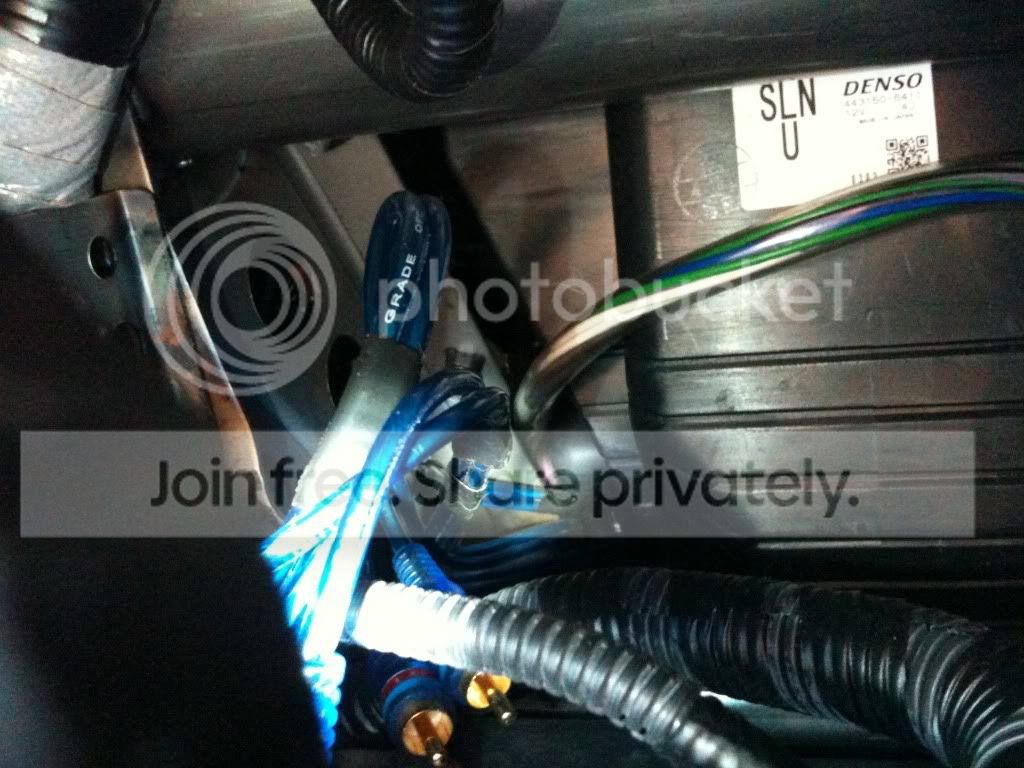

Since daylight has returned, I decided to take another look at the situation. It is definitely beyond my knowledge and ability to go too much further with this, I think. "/
I'm pretty sure the amp cable comes in and attaches to the fusebox in the footwell.
Also, I remembered this little guy from my topic here https://www.fitfreak.net/forums/1st-...what-heck.html
That little guy is strung in somewhere and is obviously getting power (see the light on it). It is bundled up with a bunch of other wires up behind the steering console. One of those wires reaches over to where the other wires pass thru the firewall to the engine bay and wherever else they go.
As you can see, there's many-a-connection wire back behind the head unit!

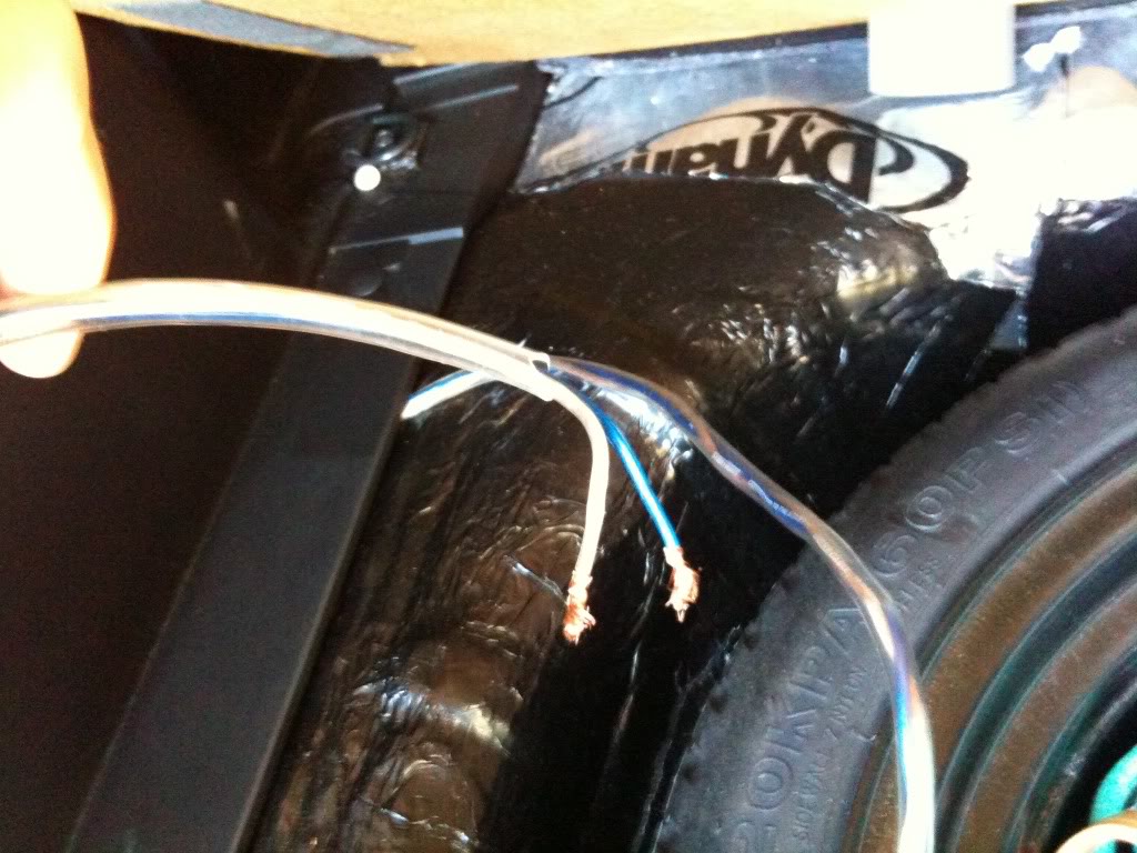

Cable for subwoofer - this was wrapped up in the spare tire's wheel. The ends were touching the wheel.
I wrapped all the ends in electrical tape (except the ones behind the HU).
This was definitely some monumental task that this guy took on. Meaning a messy clean up for me.
So... Hmm. Where should I go from here?
