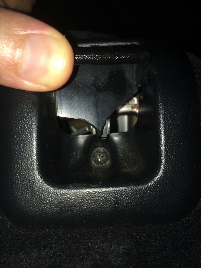

My driver side rear seat latch recently "cracked". Not sure how. The latch still works, but the part you pull up on is cracked on either side. I'll report back when I fix it. And take pics. It's really strange.
I'm referring to the latch in "johnnyoo"s 7th picture (on top of seat)

Cracked rear seat latch
Finally a pic of my broken seat latch which I still not fixed. It still works, but not sure how much longer it will last. Does anyone know how to replace the latch? Still checking the forum for some tips. Maybe just a screwdriver to get the top piece of the latch mechanism off.
