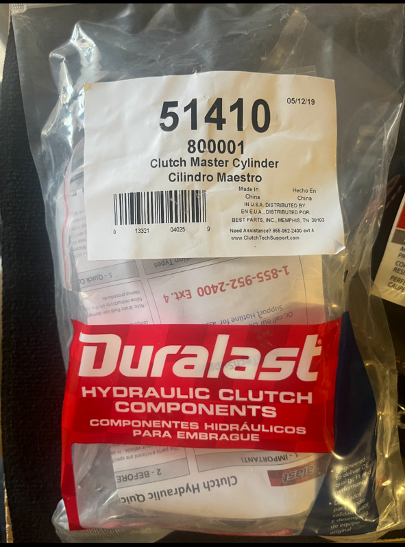

I found this easier to do by removing the entire clutch hydraulic system from the car, blowing through the lines with compressed air, mounting the new clutch master cylinder to the lines off the car, and bleeding the entire system off the car, then mounting the whole assembly at once. The flexible line, seen in the pics, has enough "give" in it, to allow removal and mounting of this entire assembly at one time, with some patience and careful maneuvering.
Duralast Clutch Master Cylinder 51410 | AutoZone
I did it. works beautifully. I'd recommend for anyone who does this, get flexible stainless braided fluid lines for this, since the non-OEM master cylinder has a slightly altered starting angle for fluid line connection, making the OEM hard line sit in a different place at the bracket which connects to the frame rail. I just manhandled mine into place, but I would not recommend this. I'm sure it is putting constant stress on the connection at the master cylinder. For anyone who hasn't ditched your OEM Clutch Delay Valve setup, DO IT. The difference is night and day. That, and a manual transmission fluid change, makes it feel like a real car.
This model has the same bolt spacing, the same bolt length, the same cylinder diameter as OEM. The only difference is the slightly different angle that the hard OEM clutch hydraulic line bolts on, when it is installed.  It is still workable.
pic of the Duralast 51410 CMC
I removed the entire hydraulic assembly, then blew through all lines with compressed air, then mounted the new CMC. See next pic for bleeding.
Poor and blurry pic. I bled the whole system off the car, like this. The brake fluid fill container you see in the left side of this pic was used to fill the master cylinder reservoir, by propping it up inside the reservoir using one of those white clips.  This kept it full while I bled it using a hand brake bleeder pump.  Installed in car, used hand bleeder pump two more times at slave cylinder, perfect.
Poor and blurry pic. I bled the whole system off the car, like this. The brake fluid fill container you see in the left side of this pic was used to fill the master cylinder reservoir, by propping it up inside the reservoir using one of those white clips. This kept it full while I bled it using a hand brake bleeder pump. Then I installed the whole assembly in the car, used hand bleeder pump two more times at slave cylinder, perfect.
