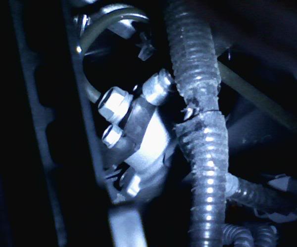

Going by the diagram, this is it on the car (sorry for the crappy cell phone pic):
Just look straight down behind the battery.
Really all we'd need is the right length clutch hose with a 90º angle end and a female threaded fitting to attach to the hard line coming off the MC.
Perhaps another car has such a hose?

Old Sep 11, 2009 | 09:18 PM
awptickes's Avatar
Posts: 991
From: Bel Air, MD
Why not just modify the damper instead?
