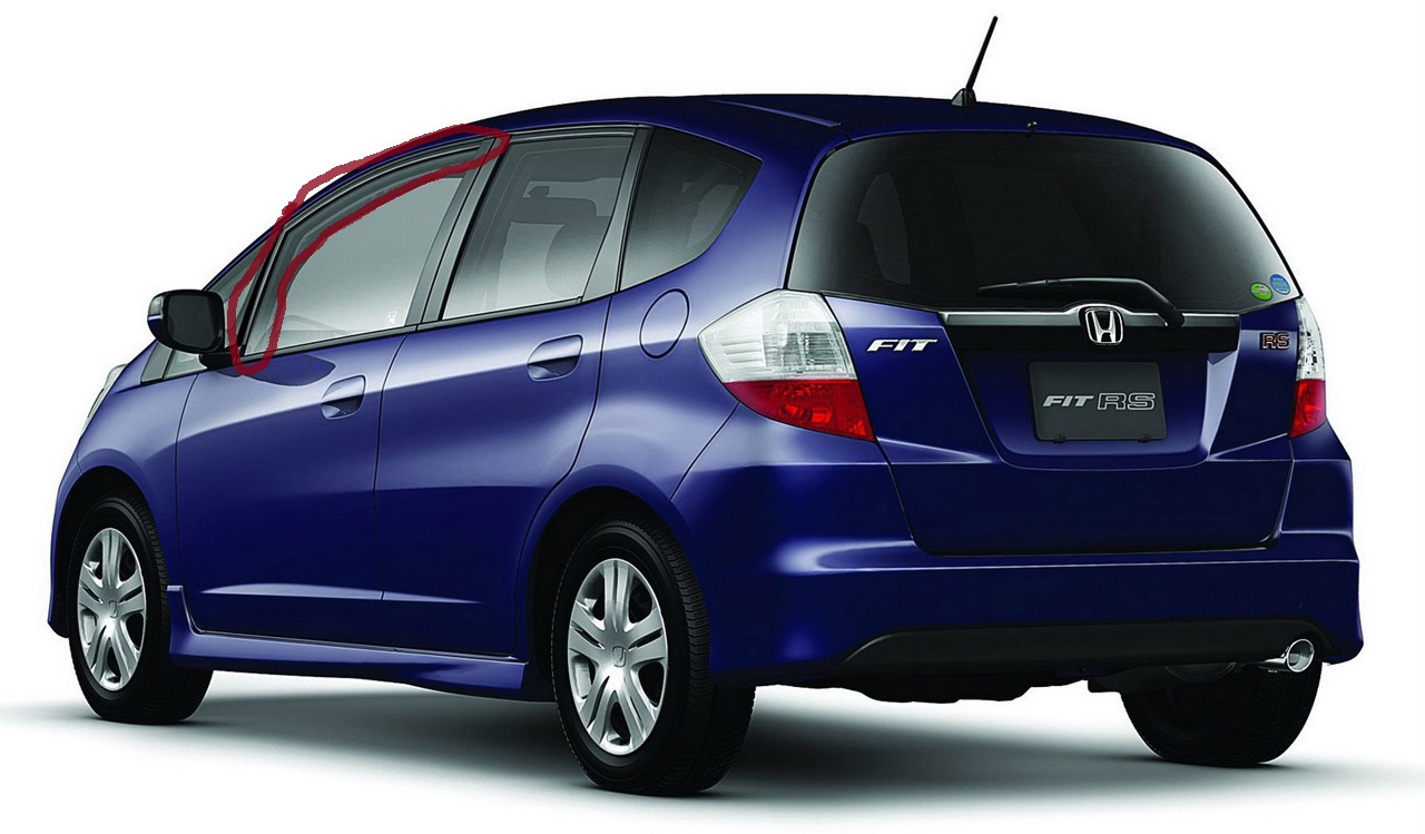

My 2013 has bunch of nasty scratches along the outside door trim (door sash (upper) ) Don't know where they came from most likely from the car wash. One of the scratches went all the way to the metal.
I found the part number but not sure if I should replace it myself or let the dealership do it. The part itself is under $20.
Honda Part: tape, l. fr. door sash (upper)
Part Number: 67365-TF0-003
If anyone has instruction please let me know.

For just $20 give it a try yourself or even try a spray can of similar paint.
Yep I agree w/ Black3sr
wet sand the scratches out (400 grit) and spray with satin black. Taping it off with 18" paper and wipe down with rubbing alcohol 2-3 times b4 you paint to remove any silicone.
GL with which ever method you choose,
Big Mike
