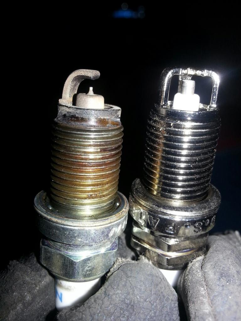

Here is a photo showing, what I think is the original NGK Japan plug on the left and the brand new E3 replacement plug on the right.
I know the NGK and Bosch have a needle-like design of it's center electrode, but the E3 plugs have a thicker, more robust looking pin.
I know the original plugs were gapped at 1.3mm (.051 in) but these E3 plugs don't say what they are pre-gapped at. All I know is the box says 3.43 (not 3.62 like the box photoed below) and the spark plug reach is 3/4 inch. This is just a photo I found of the box online.

Having read over 100 posts on this same issue, my observations are:
1. don't use the E3 spark plug. Stick with the Denso or NGK Iridium.
2. the valve adjustment, spark plug change and coil pack replacement are inevitable with this car.
I believe you may find that your smooth running engine is very temporary. The coil packs (Hitachi) are going to have to be replaced. When the studdering returns and you have to replace them, think about putting a Denso or NGK plug back in.
